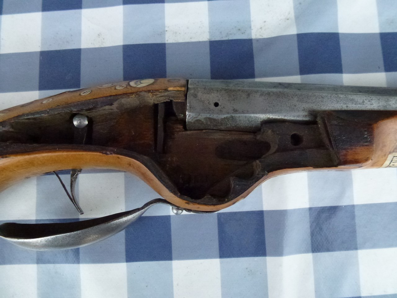

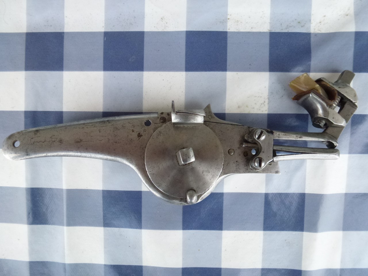

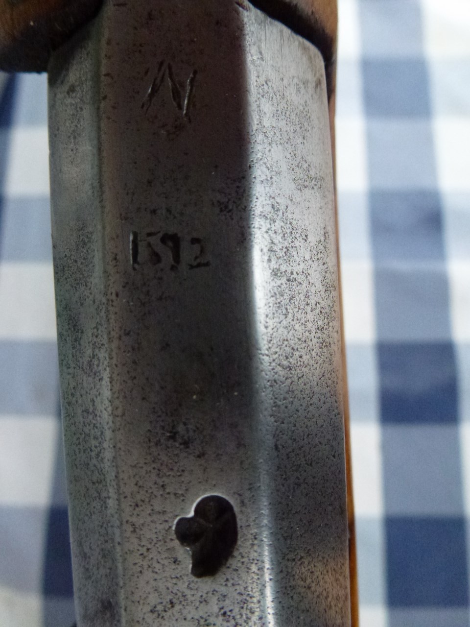

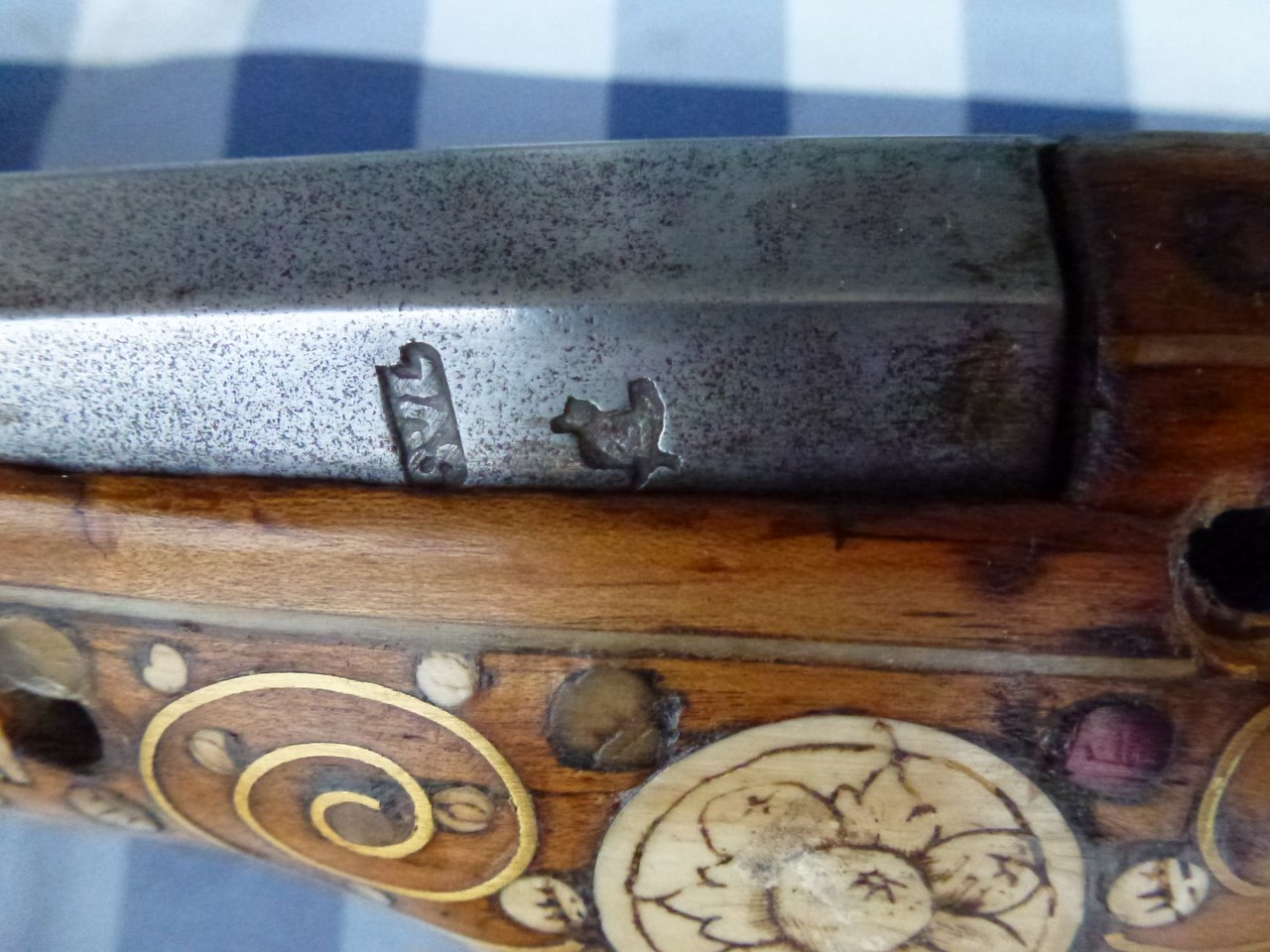

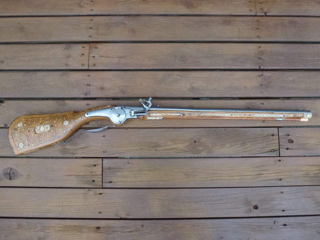

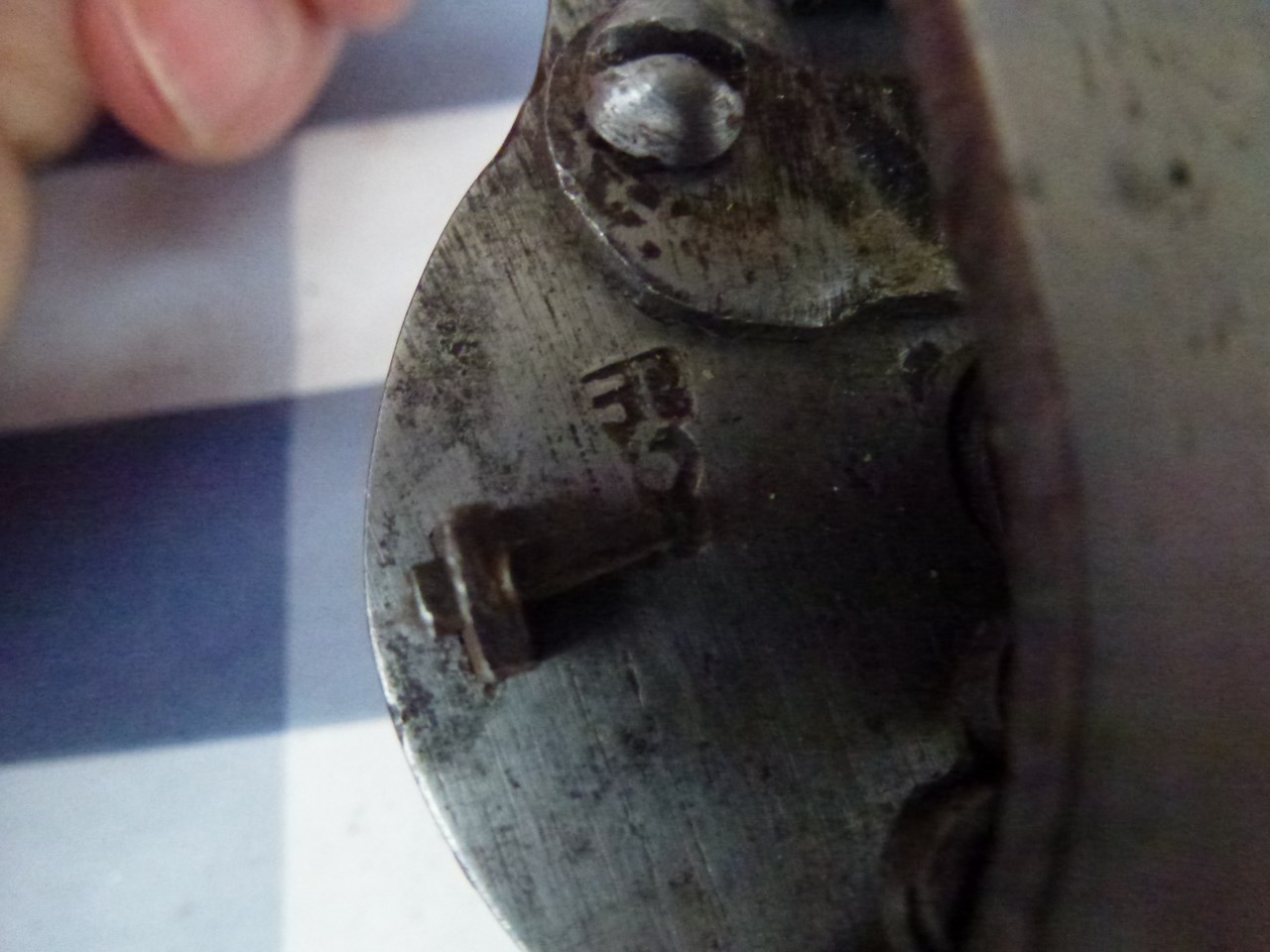

I have a Suhl Wheellock carbin, and I wonder if someone can help me with some information about this. When I bought it, it was informed that it was produced around 1630, but it is marked 1592 on the top of the barrel. The stock has a lot of inlays, I guess this is done later. The barrel har some Suhl markings, and the inside of the lock is marked FR over a wheel or something.

I can defintely tell you every little detail about your carbine.
1. It was manufactured in Suhl after the Thirty Years War (1618-1648), in the 1660's, as a plain undecorated military saddle carbine
2. The date 1592 is spurious and a later addition, and so are all the bone inlays in the stock.
3. The original riding bar which attached the carbine safley to the saddle by a leather sling is missing from the opposite side of the lock; formerly, it was fixed by one of the of the sidenails and a forward screw also acting as a transversal pin for the stock and barrel;

I once owned a very similar example, yours has more stamps on it though.
My suhl carbine, also inlaid with bone plaques was made for the saxony market or even the Polish nobility. I would date this carbine to 1640-1650s.
I couldn't find the date of 1592 on the barrel in your pictures. The lettering ISE (?) is most likely what you meant?
The pin holding the trigger could be a replacement.
Still a nice gun on its own right.

Marcus, it's 1592 no letters there only numbers.
I did some photoshopping on Morten's picture.
Michl
Thank you Michl, but i still have doubts about the interpretation of this mark. It might just be my perspective beeing a bit off.. but i can see either a crude 1592 (especially the 5 and 9 are vague) or ISE with the E not in good shape.
The question is if you should read this as other mark SUL? The SUL are stamped within a square and are raised, the ISE is in the same manner. 1592 would be stamped without a boarder/sqaure around it and stamped inwards.
I have no knowledge (beeing 0-5%) on how stamps where made in those days.. i do know it is more common for dates to be stamped inwards without a boarder to highlight them.
Tomorrow there will be a good day to learn a new fact on firearms i feel... Michl, fire away
