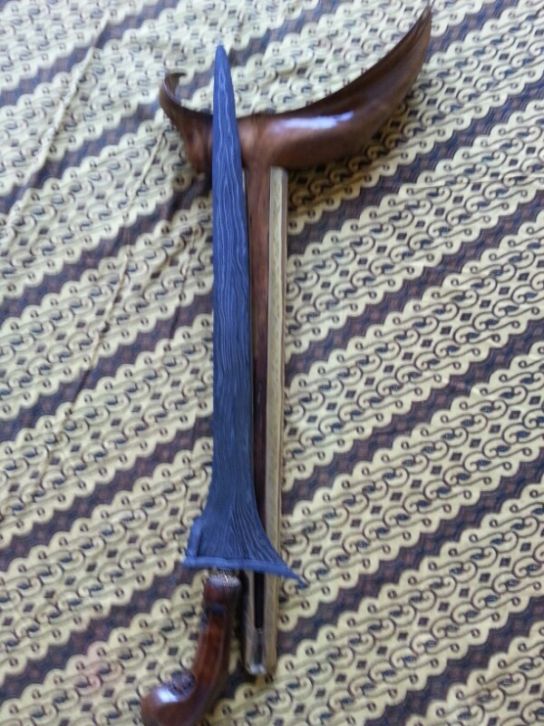

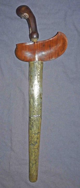

In Java, you will see two types of dress in abundace, i.e. the gayaman and the ladrang. The former was used for everyday situations while the latter was (and is) for formal occasions.
The below photos contain examples of gayaman style and ladrang style from the Surakarta (also known as Solo). Surakarta and Yogyakarta both have their own versions of the two styles. Hopefully someone else will add some Yogyakarta examples for comparison.
Surakarta and Yogyakarta are both sultanates, and during the Dutch presence they were largely bereft of political power, which left them to focus on becoming patrons of Javanese culture and art. The Surakarta and Yogyakarta forms thus epitomise the most graceful forms of both the blades and the dress. The further you move away from these centres, the more variation you will find.
Bjorn is offline   Reply With Quote
Old 10th November 2014, 05:47 PM   #10
Bjorn
Join Date: Jan 2013
Location: Netherlands
Posts: 188
And Surakarta ladrang style.
There is actually an existing thread that delves a bit deeper into the differences between Surakarta and Yogyakarta dress.

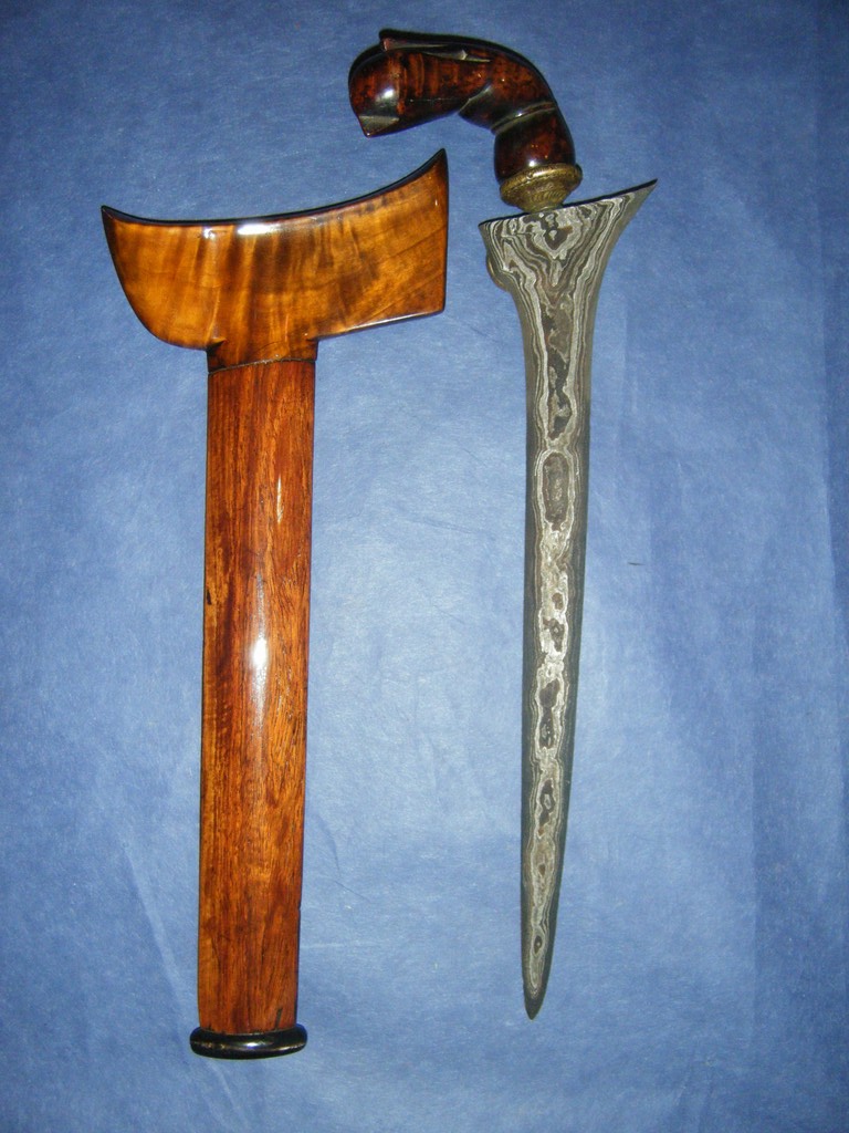

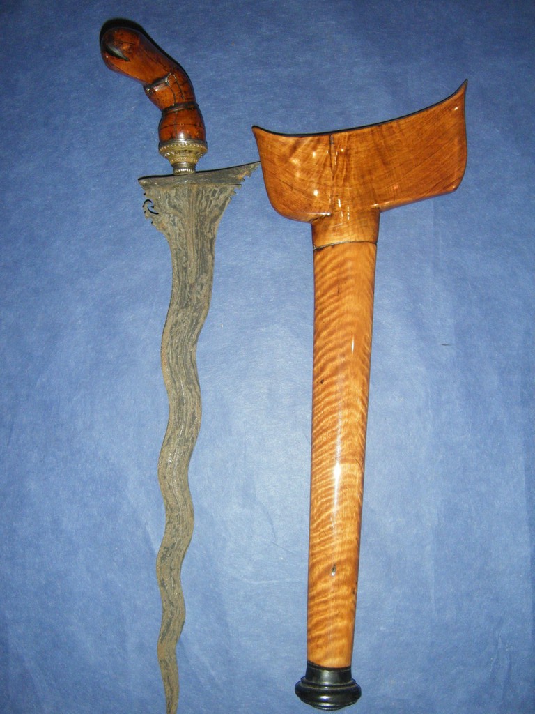

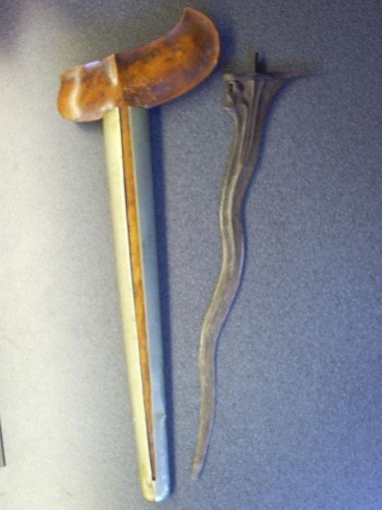

Hello Ron,
lifelong undertaking! And special because I am sure that you will look for the better examples!

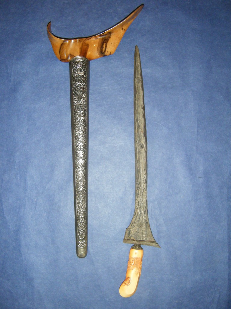

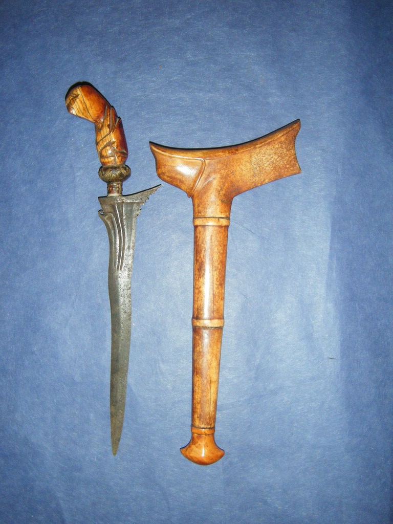

Will show you some more examples, here at first a gayaman Yogya keris, Java.

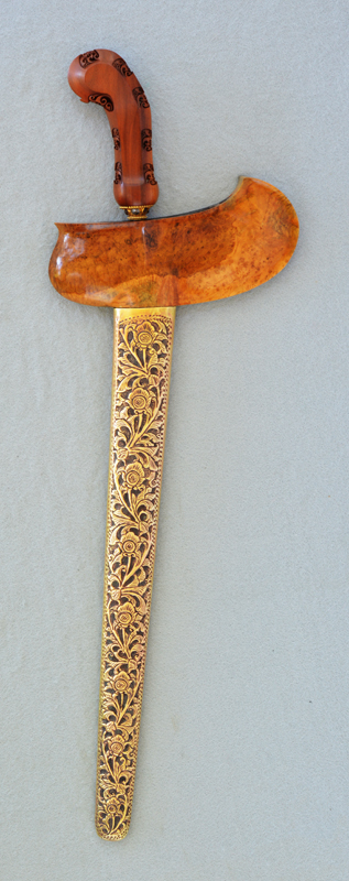

Old 10th November 2014, 07:54 PM   #12

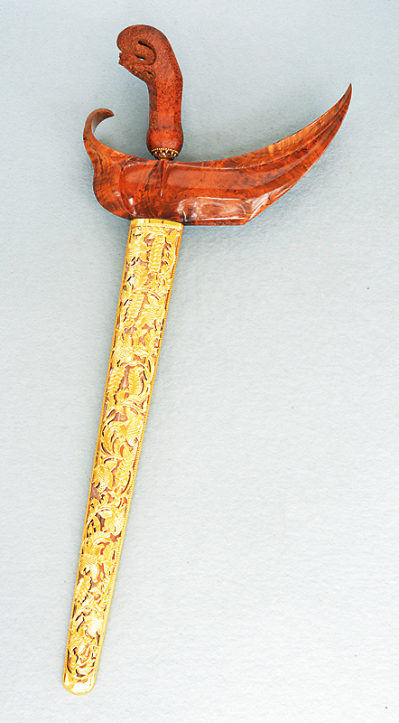

A branggah keris from Yogya.

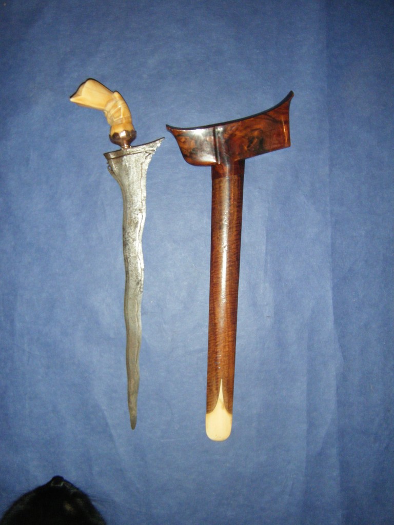

One of the numerous forms of Madura keris, a classic daunan keris.

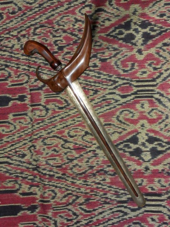

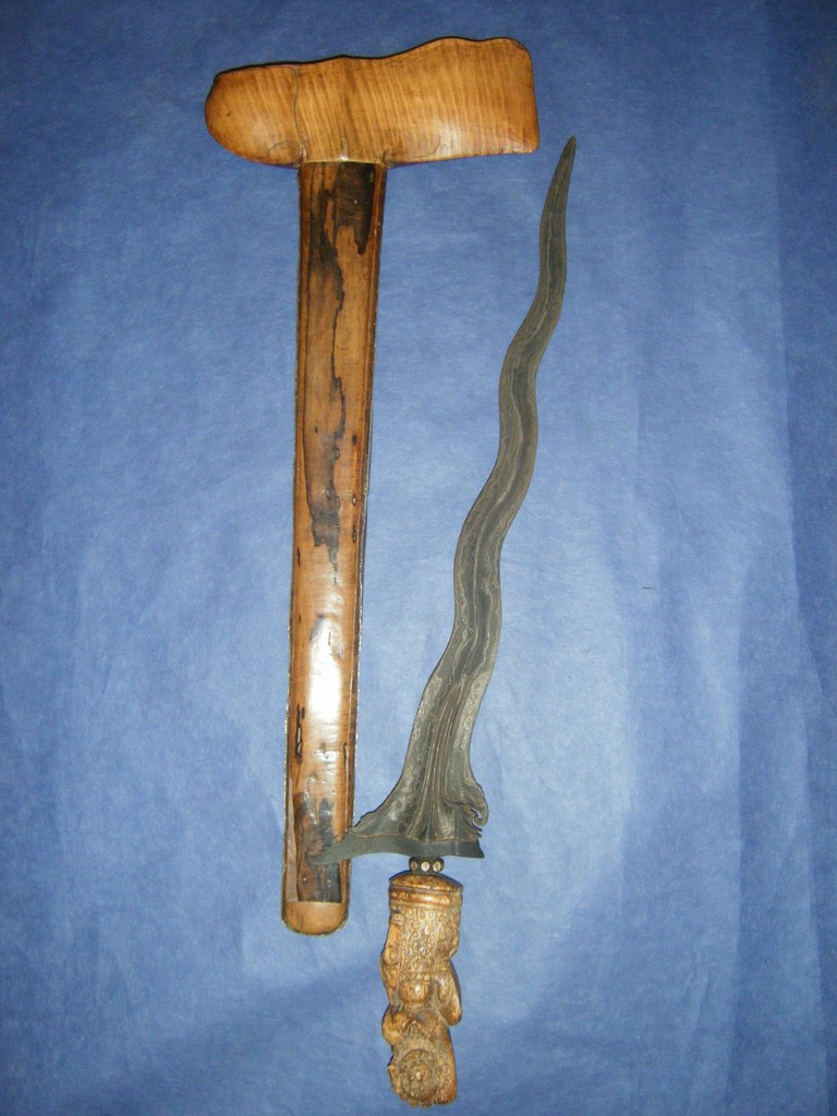

A batun puh keris from Bali or Lombok.

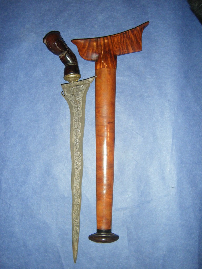

A kekandikan keris from Bali.

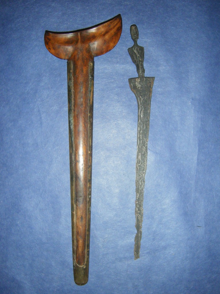

Old 10th November 2014, 08:09 PM   #18
A kekojongan keris from Lombok/Bali.
Old 10th November 2014, 08:12 PM   #19

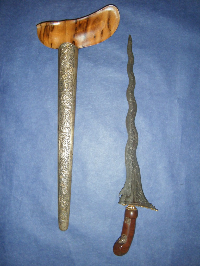

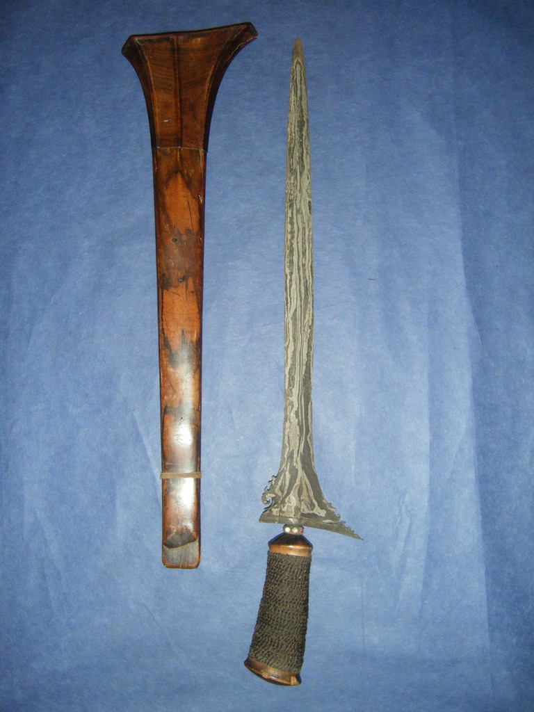

Two keris from South Sumatra, Palembang.

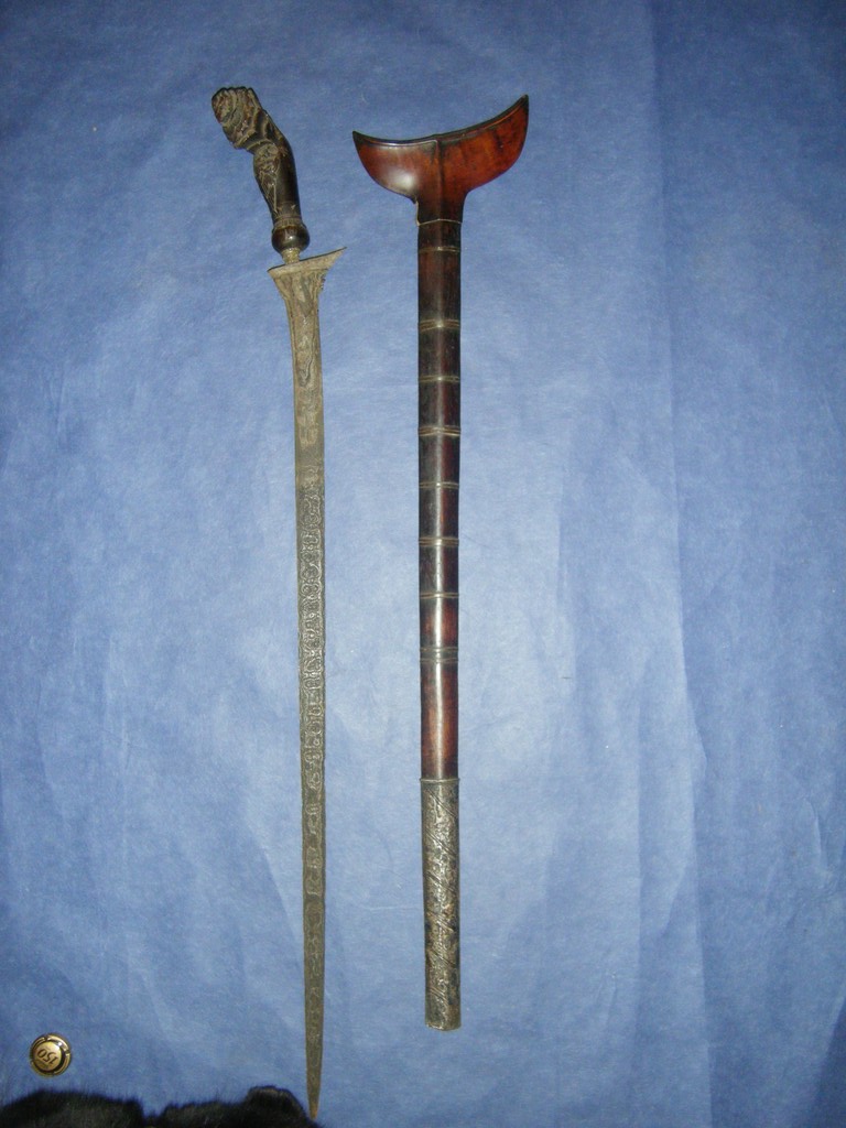

Old 10th November 2014, 08:22 PM   #23

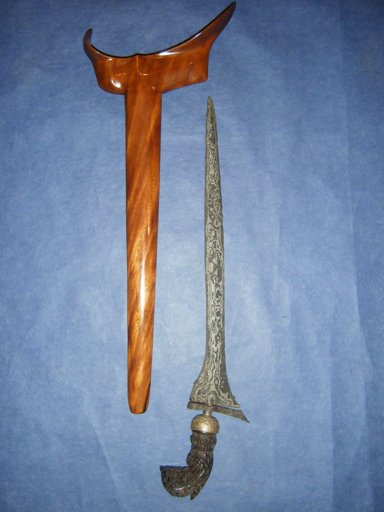

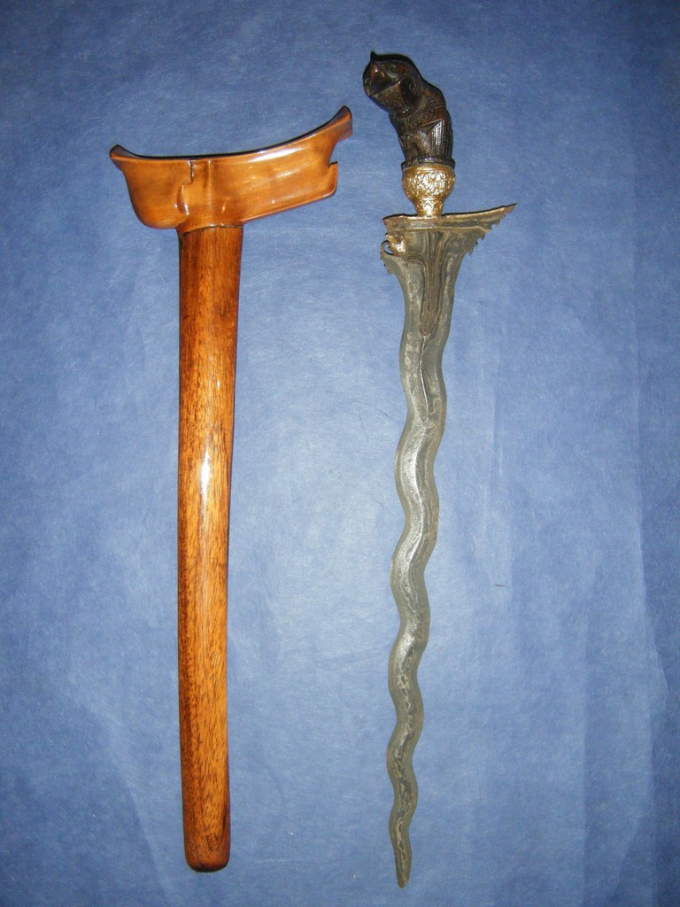

A Peninsula keris, I think Terengganu. Sorry for the fuzzy picture. My cat like this keris.

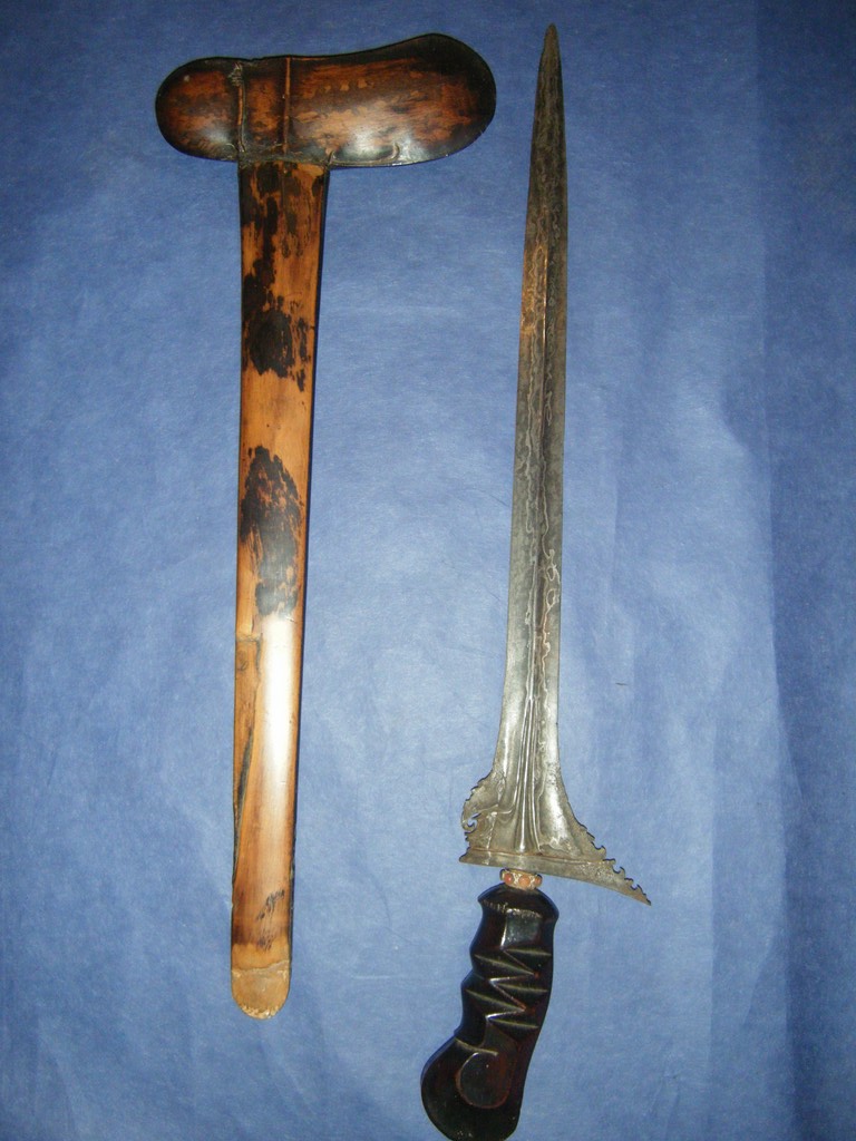

Old 10th November 2014, 08:41 PM   #26

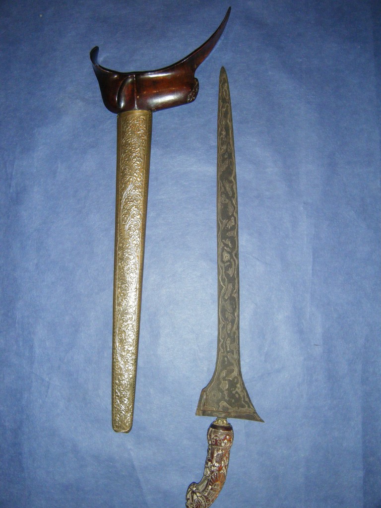

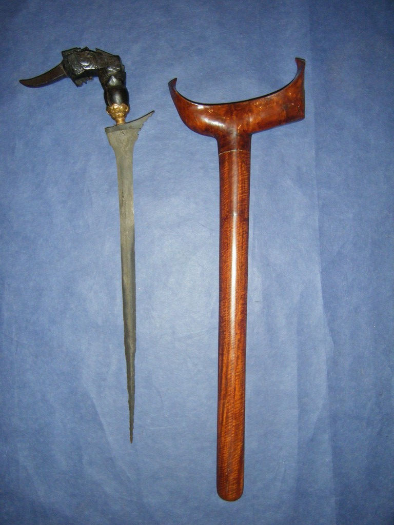

At last my Tajong keris.
The here shown keris are by far not all types and origins you can find but I want to let others also something to show!

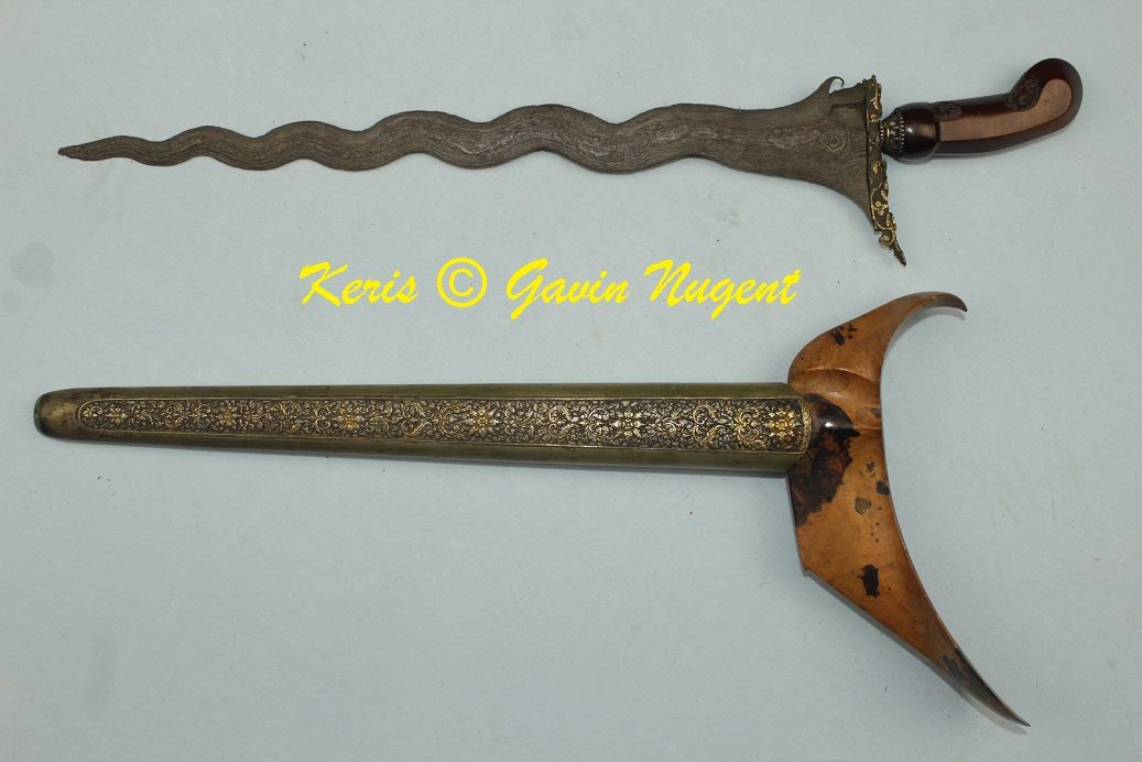

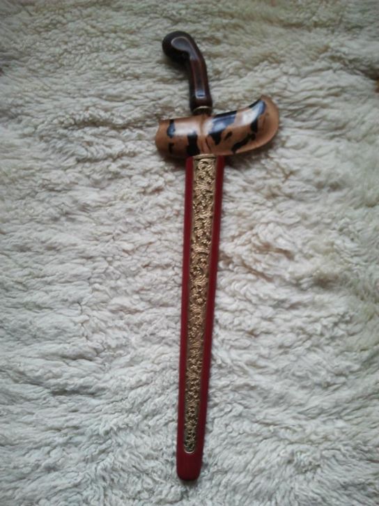

Great Question Ron, and one I'll never fully understand in my lifetime so praise the forum and its generous members and other collectors who give their precious time, I am in debt to both.

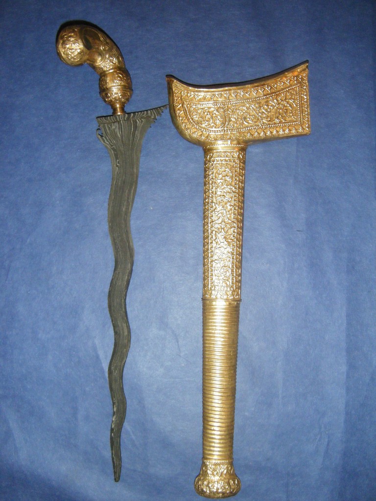

I got caught on some time back when I first obtained the Kelling Hall collection and started to become a closet Keris collector and the more I look and learn the more I feel like Russel Crowe writing on walls in "A Beautiful Mind"...If I kept writing notes I'd fill the walls of the house on what's from where with how many things in the Keris world came to be and melded together in different regions over the centuries...I've also learnt even the most learned student may not see eye to eye perfectly due to such a massive cross regional influence in the seas south of Asia.
This is my only Java Keris, one I know very little about. The rest of my 40 something collection is from Pattani, Malaysia and Sumatra...I personally find these the most appealing.
Gavin

Hello Ron,
let me ask you this though: what's the difference between the branggah keris, cirebon keris and the madura keris??? sure the pommels are different, but from my novice eyes, the wrangka on the scabbard look similar?
Yup, similar. Look for the differences though!
also, what's a peninsular keris?
Malay peninsula, a geographic term that includes some areas nowadays under Thai administration.
