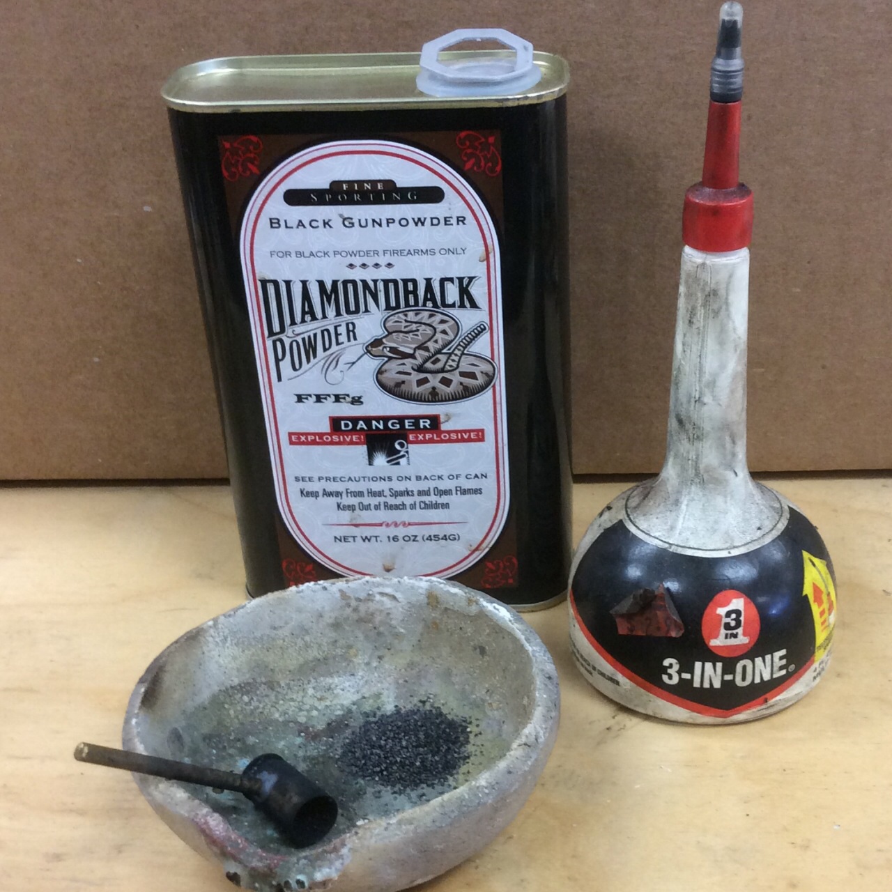

I wet some BP with 3 in 1 oil this afternoon.
Tomorrow I will attempt to set it alight.
I will post the results.
Shakethetrees is offline   Reply With Quote

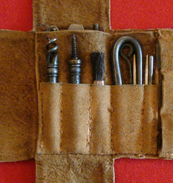

attached is a photo of a toolkit for a flintlock, the double helix ramrod tip was screwed on & used to extract the patch or patched ball. if that could not get sufficient purchase the the screwed tip that looks like an upside down wood screw was screwed into the lead projectile. if that failed, the whole barrel would need to be removed from the stock & the breech plug unscrewed to give access to remove the powder and ball. initial procedure would have been to re-prime the pan (or replace the percussion cap with a new one) & try again to fire it. in combat that whle procedure was off course impractical, so you'd drop the darn thing and pick one up from the nearest corpse of one of your companions who didn't need his anymore. or, if an officer, draw your sword.

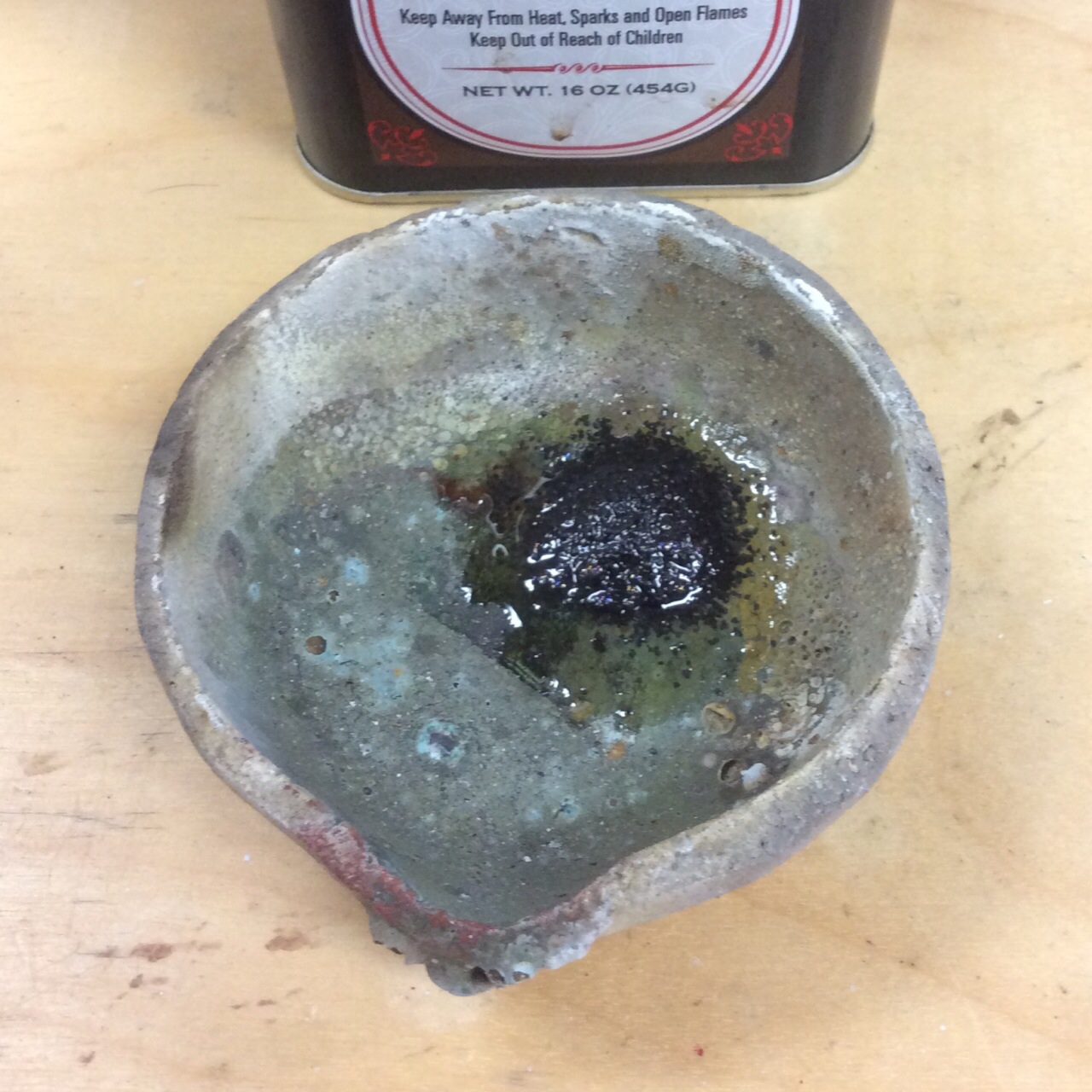

...and the results are in!
I saturated a bit of BP with 3 in 1 oil as shown in the images I posted.
Unfortunately, the porosity of the fireproof crucible sucked the oil away from the powder, and left it high and dry!
I repeated it in a stainless steel cup, saturated the powder as before and waited 24 hours. The result is the powder ignited slowly and somewhat reluctantly, and burned much more slowly than fresh, unsaturated powder does.
I stand corrected.
Do not use oil. Yes, the volatility was significantly reduced, but, as it still burned, I wouldn't recommend it. Period.
I'm doing the same with water. It's soaking right now, tomorrow I will take the water away and dry the powder before I attempt to light it.
More results later.
It's great to have an excuse to do a little experimentation like this that could have benefits to the collecting community at large.
And, besides, it's great to have a brief return to my childhood!
Hi Shakethetrees, Great work and thanks for taking the trouble on behalf of, not only myself, but the collecting community as a whole. The result is interesting and dispels the myth that oil neutralizes black powder. I'm sure a lot of members await your further results.
Thanks also JamesKelly for questioning the myth!!
CC

Another problem with firing off an old loaded gun, is that someone may have loaded it with some other powder it wasn't made for. A lot of powders are black!.........but they are not "Gunpowder", ie, black powder.
It is also quite likely that a loaded weapon could have been loaded in the last few years.
In the last year I have purchased two that were loaded, One an English double sporting gun, the other French.
The French one was wadded with newspaper (Obituary page!) of someone apparently died in 1983 if I remember correctly.
Many of us shoot these old arms, and it isn't outside the realms of possibility that they are occasionally left loaded.
Drawing a charge is normally no bother, and nothing to be alarmed about.
Those that use these old guns withdraw charges as a matter of course.
Keep your head out of the way of the muzzle, and use a good worm on your rod, and all will be fine.
Normally we don't bother wetting the powder first, as it makes it harder to clean out. Old powder can set into a cake, so must be broken up to get it all out. Clean & oil the barrel afterwards to prevent rust.
Richard.
