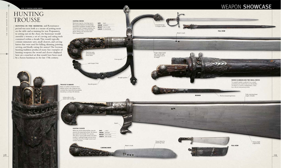

Hello Sancar,
I think the piece you show is more likely part of a hunting trousse of European origin. These kits for preparing the animal carcass onsite often included large cleavers with weird blades (see attached example).
As Gavin noted, the Naga dao in question has the edge on the straight side, with a concave spine. While there are Naga blades with concave edges they are quite different from the Topkapi piece.
