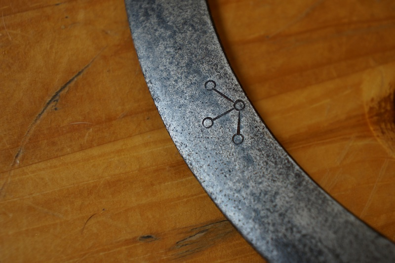

Intriguing weapons. I was lucky enough to pick one up a while back and might provide some insight.
This one is the same type and sporting the same mark as shown on top of page 314 in Robert Hales' new book. It is convex on both sides, like a sword. Made of great steel and rings like a bell as they say… It is a little larger, about 9.5 in and although I have not thrown it, it feels great to hold.
I look forward to hearing more about your project…
