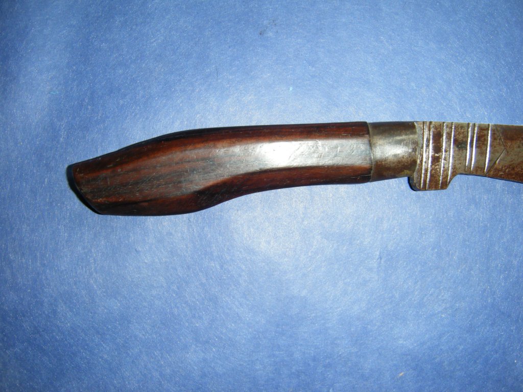

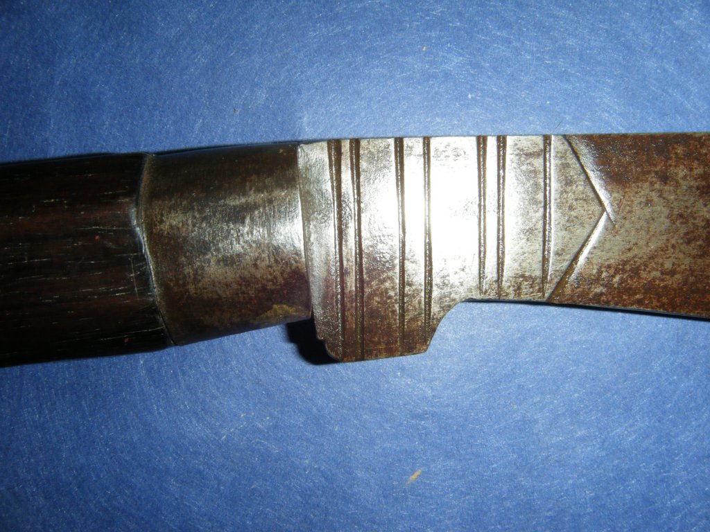

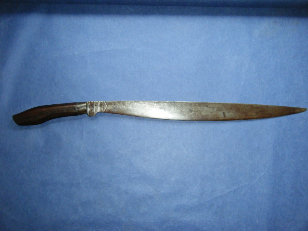

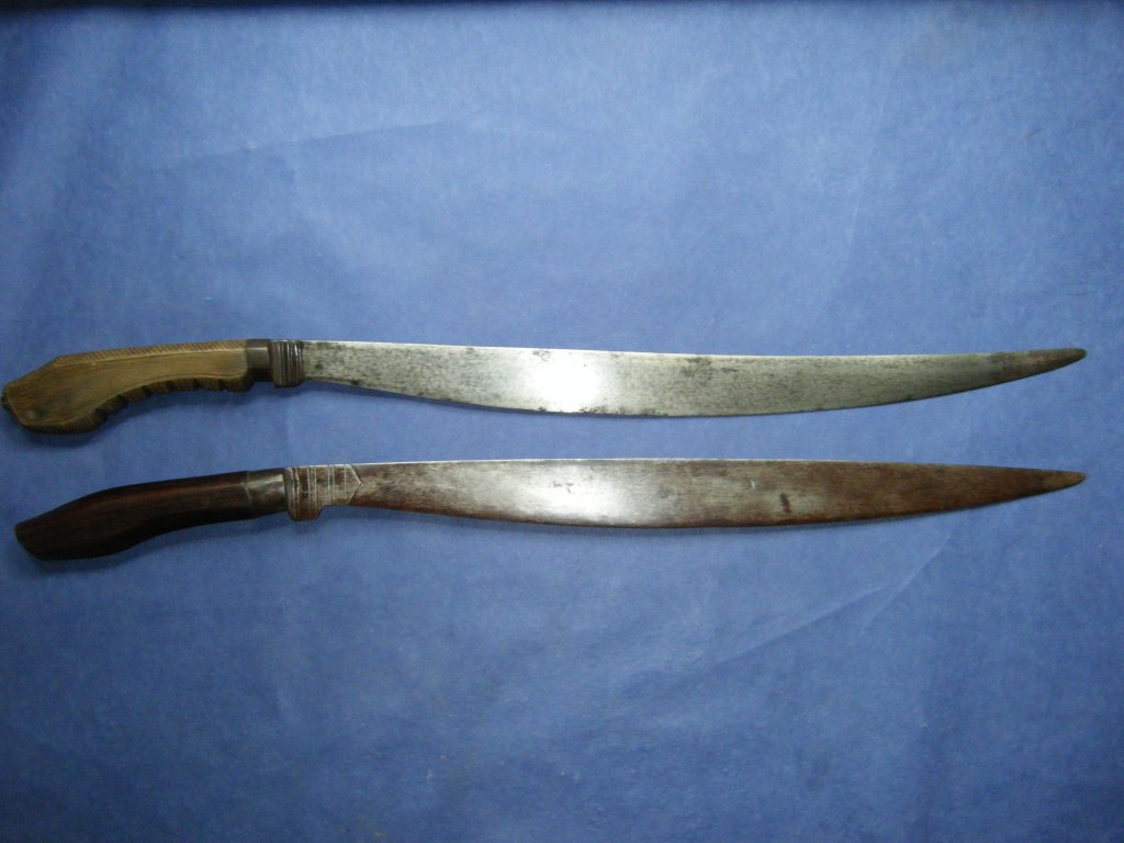

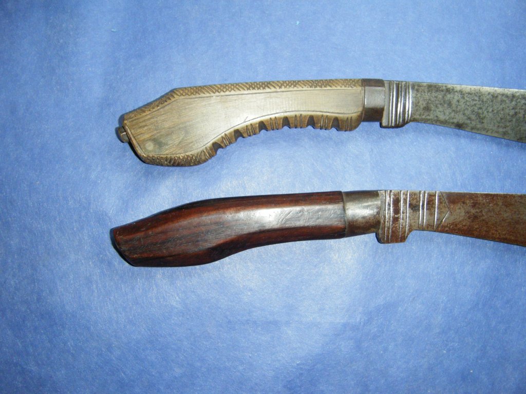

Have some time ago acquired this Luzon bolo, I think it's a Tagalog itak, very thick blade (12 mm near the handle), kamagong handle and nice file work at the ricasso. Sword is 61 cm long and think that it is from the second half of 19th century. Two pictures show it side by side with an other itak from my collection for comparison.
Your comments are very welcome!

Thank you! Yes, the blade has a look like a slender barong blade. I have a third one, look here: http://www.vikingsword.com/vb/showth...highlight=itak
I really like this old Tagalog itaks with rectangular ricasso. This could be IMHO a sign of age. They are all three very good worked and feel very good in hand.

Special I would like to know if I am correct that it is a Tagalog itak. And any thoughts about my theory that this thick rectangular ricassos a sign of older examples.

Oh I would think that it is Tagalog based on the blade shape.

Thank you very much for confirming my guess! Do you would agree also about the ricasso, i.e. that this is only found by old blades?

I will hesitantly say yes, so far. However, I would need to look at some WWII examples to be sure.

Thank you Jose. This one: http://www.vikingsword.com/vb/showth...highlight=itak Spunjer sold some time ago (nice one, see it to late and was sold already) is a later one, still have this form of ricasso but not distinct anymore.
I think that Robert have seen and handled much more Tagalog itak, would be interested what he think about this theory.

Hello Detlef, I was just getting ready to make a comment on your very nice new addition to your collection when I read your last remarks about the file work on the ricasso. I have to admit that I am a little hesitant to agree that this is only seen on older examples of these bolos as I have seen some that were purportedly of WWII manufacture with these markings as well as others supposedly brought back from the Spanish American and Moro wars that did not. What you suggest might very well prove to be true, but more examples that have verifiable provenance would be very helpful in proving your theory. I do however think that these marking were more prevalent on the older examples than on the later ones but as to why I cannot give you a definate answer. It could have been the extra cost to the owner, or that (like many other things) they just went out of style and slowly started to disappear altogether. Anyway, my congratulations to you on your new addition.

thank you for comment! Now, when you mentioned it, there are also older blades without this ricasso and file work. So you are correct that this can't be a sign of age. BTW, there are also Visayan blades with similar worked ricasso.

Nice knife. I think a more precise term for this knife might be Luzon matulis (matulis = "pointed") rather than the more general term of itak which simply means bolo or knife. I'm not a Tagalog native speaker, but that's what I've gleaned over the years from people who are.
As to the age of this knife, that's hard to say. Certainly it was a style of knife used by the katipuneros during the uprising against Spain in the late 19th C, and is still being made today. Where it was made on Luzon is even harder to say--could be within the area from Ilocos norte down to Batangas.
As for the vertical marks at the forte, I'm afraid they are not helpful in determining age.

Thank you for your thoughts about this blade; I would call it sword instead of knife, the length is 24 inch, the blade is nearly 1/2 inch thick near the handle.
When I understand you correct it would be called matulis when it is a Tagalog blade. But wouldn't it be called different when it is a Ilocano or a Batangas sword?

Batangas is a predominantly Tagalog province, so Tagalog is the dominant local dialect. Ilocano is a different language and I do not know the equivalent term there.

Ilocano knives and swords are not particularly distinctive, but I have a few well provenanced ones that show the rather graceful contours to the full tang hilt that is exhibited by the original subject of this thread as wella s the small "notch" to the cutting edge just at the ricasso. Not saying these are definitive signs of Ilocano work, but they are consistent with the identified pieces I have had in the past.

Thanks Ian. I will only add that some Ilokano pieces have wavy blades and the tang goes all the way through the hilt.
On the matter of the notch near the hilt, I have a couple of Tagalog bolos that also have this notch.
