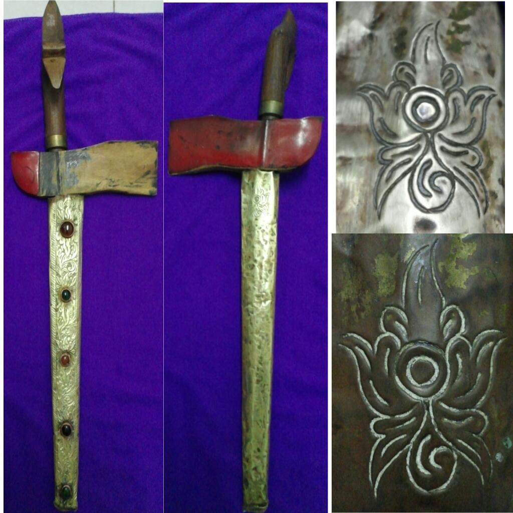

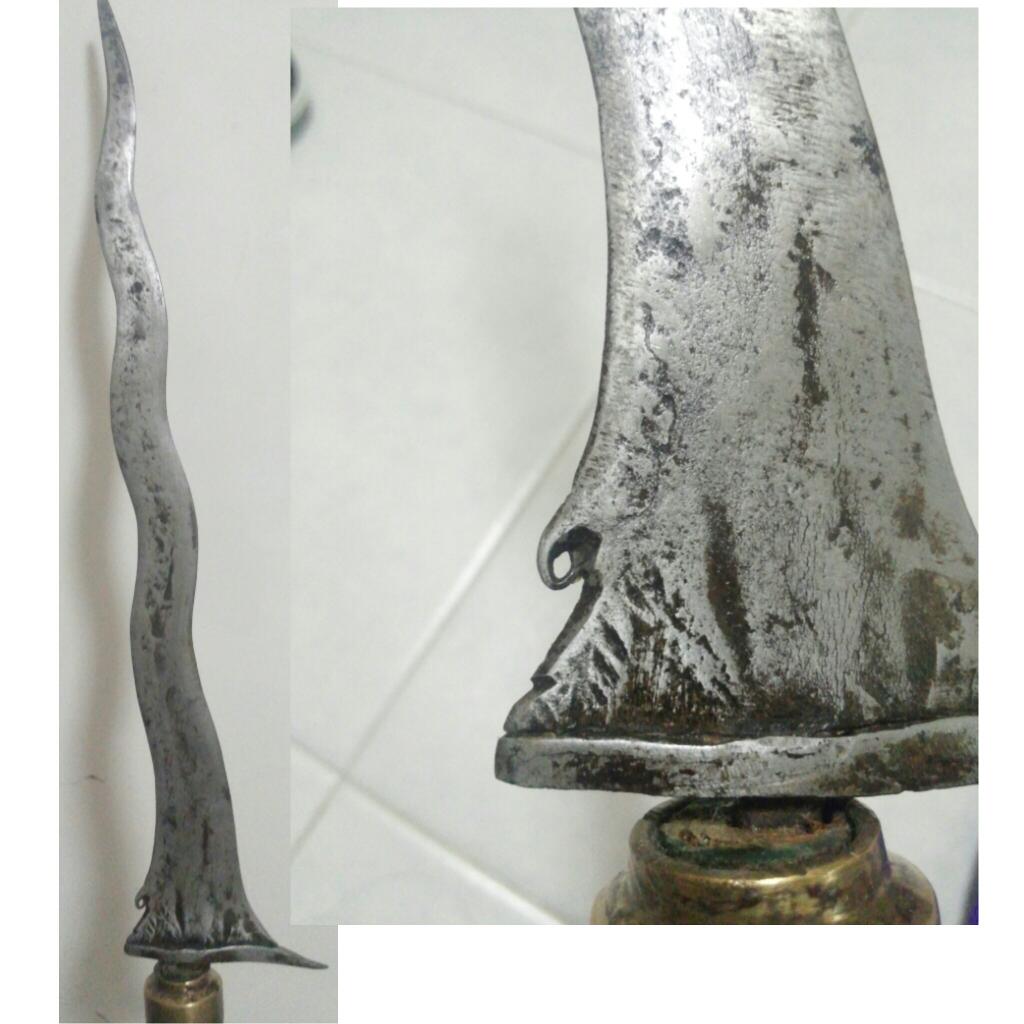

Hello guys...its great that i am able to post this thread..been waiting a long time..i will posting quite a number of pics of the keris in posession right now. And last, i know nuts about keris. Please do look, appraise and advise. Thanks in Advance.

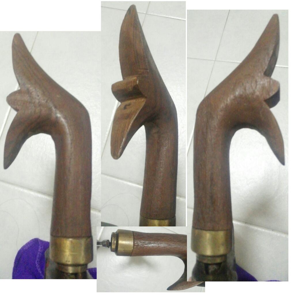

Hi Isumairuchiru, welcome to the forum. I am afraid we do not do monetary appraisals of this forum. I suggest you have a good look at the rules of conduct posted in the main forum and the special Keris Forum rules posted in this one to be sure you fully understand how we operate.

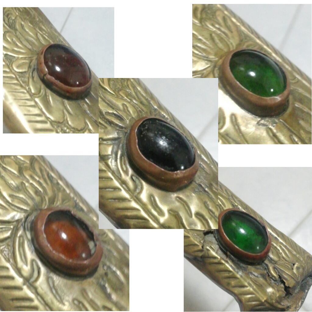

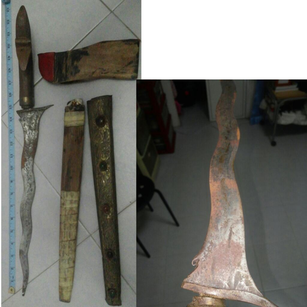

That said i'm afraid i don't have much good news for you about your keris. The sheath is from the Bali/Lombok region. Though possibly restorable, it is in rather poor condition and was never high quality to begin with so i'm not sure it is worth putting the time and effort into it. You've presented a number of close-ups of the "stones" so i hope it doesn't disappoint you that these are fairly valueless pastes. The fit of the blade into the sheath looks very loose so i would think this is a marriage of the blade to this pre-existing sheath.

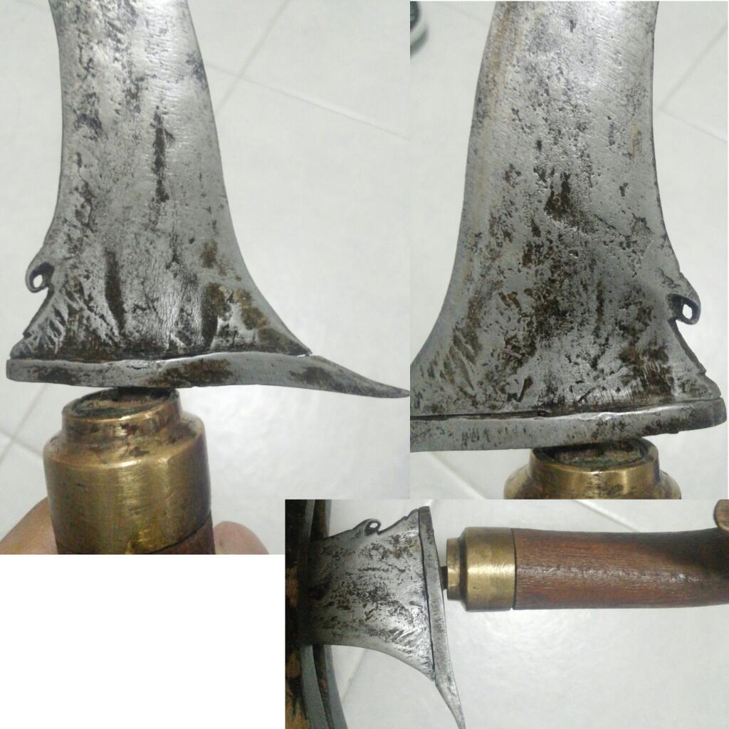

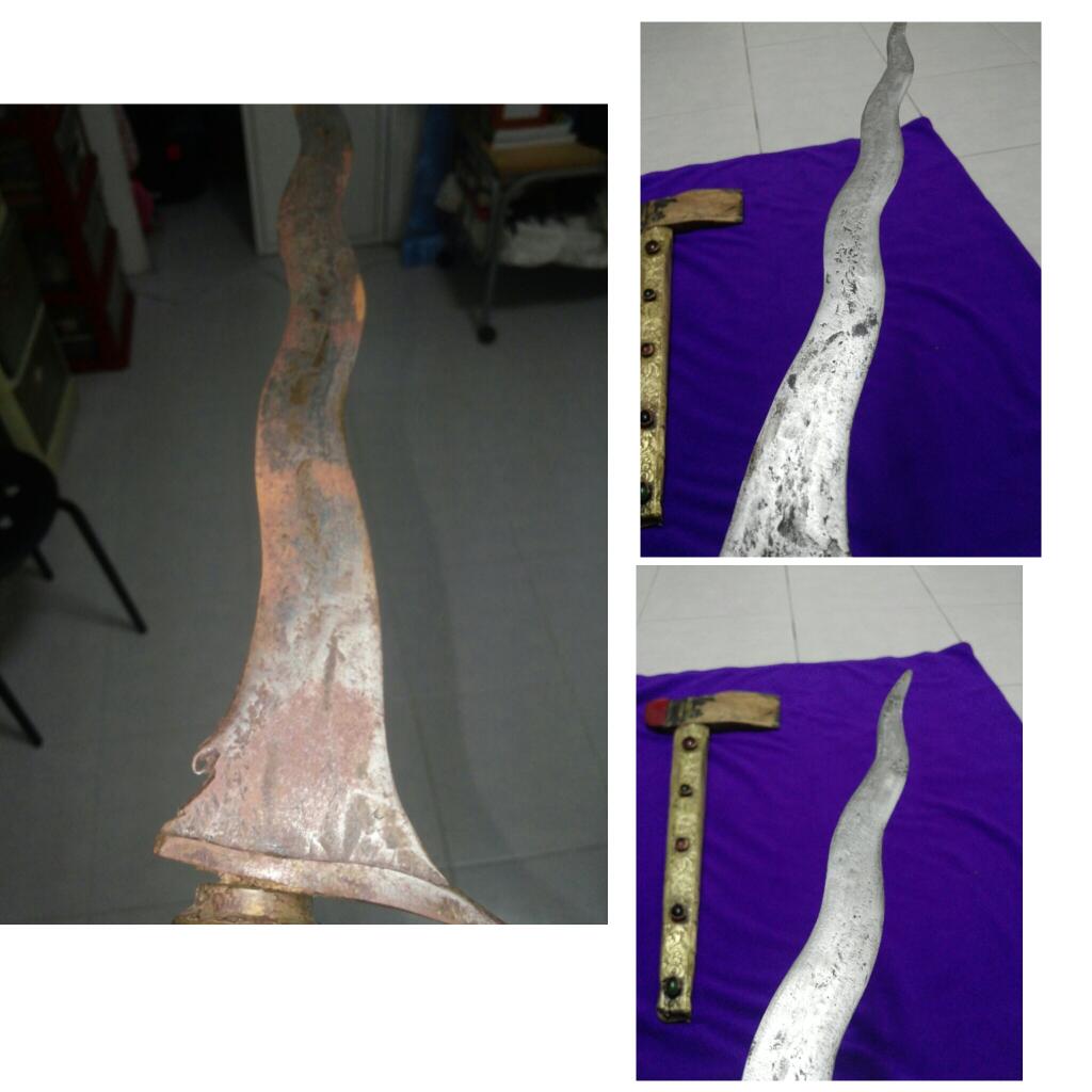

The blade is also rather low quality, perhaps more so than the sheath. It may also be from Bali/Lombak, but it does not have any of the distinct characteristics i expect from a keris of that region so i can't be sure.
The hilt has no business being on this or any keris, as it is not a keris hilt at all. I have seen the form before, but i would have to do a little research to tell you exactly what kind of blade it belongs on.
So, it appears to me that you have an "ensemble" made up of unrelated parts put together by someone trying to find a way to clear them out of their shop. Probably not what you hoped to hear, i'm afraid. Don't be discouraged by this, as i believe many of this have less than brilliant stories to relate about acquiring our first keris.

My first suggestion is just for you to look at a lot of keris. The differences in quality become more evident when you have something to compare. You are fortunate enough to live in a region where you should be able to find a fair amount of keris to look at in hand.That is the best way. O know of at least one good storefront for keris in Singapore and going in and handling and comparing them should be an informative experience. But simply searching for images either in our archives or through the open internet will give you a lot of photos of what different levels of keris quality look like. Understanding the subtleties of the keris form is a very long road, though quite a delightful journey IMO.
Frankly, the carving and shaping of the keris you have presented is rather crude and unskilled. This will become immediately evident once you put it side-by-side with even a medium quality example.
