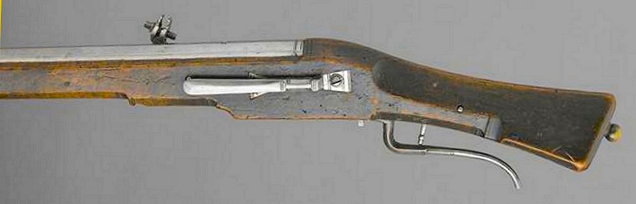

Default A Very Early Wheellock Arquebus, ca. 1530, in the Musée de l'Armée, Paris
Discussing earliest wheellocks, we may not forget this arquebus in the Musée de l'Armée, Paris. It is French, no doubt, but generally dated 'ca. 1520', which in my eyes is not justified.
The earliest date I would seriously assign to it is 'ca. 1525-35', with a main focus on 'ca. 1530'.
The stock is in all probability limewood, with a lesser possiblity of maple.

If possible, I would (and other forum members) as cubrecazoleta operation (COVERPAN) and the trigger system. It seems completely strange .....
Affectionately. Fernando K

Hi Fernando K.,
The very same type of pan covers of the early 1530's ca be found on the Ottheinrich arquebus of 1533, on another in the Royal Armouries Leeds and on a detached lock in the Dresden armory, all ca. 1530-35:
http://www.vikingsword.com/vb/showthread.php?t=17814
Michael

Matchlock Estimate:
I declare, by a principle of intellectual honesty, I'm more confused: the view from inside the key the cubrecazoleta (pan-cover) is not appreciated, nor as the crank wheel you can move, or that another system was applied . Also, I think I see the hole holding the wheel, but the trigger system appears to be independent of the plate (plate) of the key (lock) ....

Oh yeah, Fernando K.,
I can see what you mean; the constructer of this lock mechanism seems to have chosen his very own special way, as he did with the specially mounted French main spring for which he had to hollow out the stock, and the long dog spring on the outside of the forestock.
The trigger itself, though, as always, is suspended in the stock behind the lock.
Aficionado,
