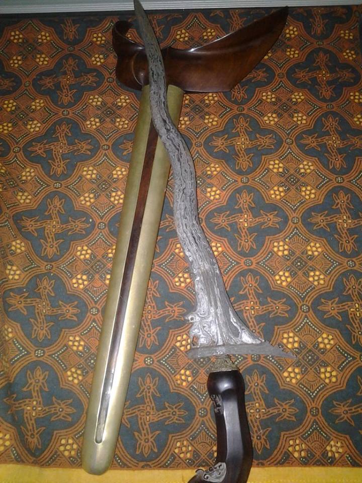

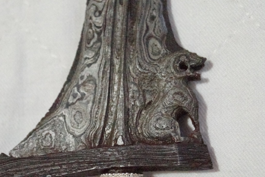

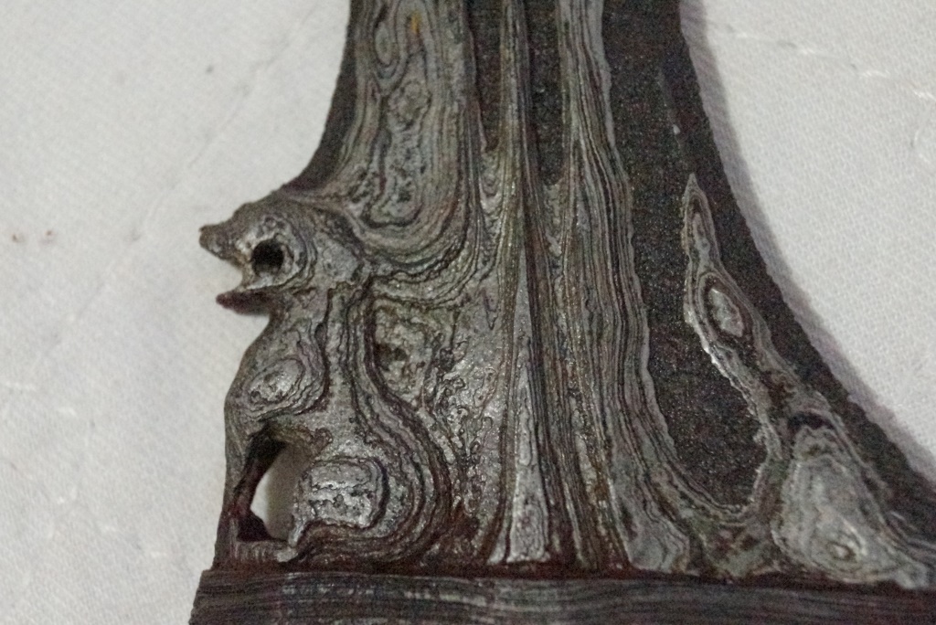

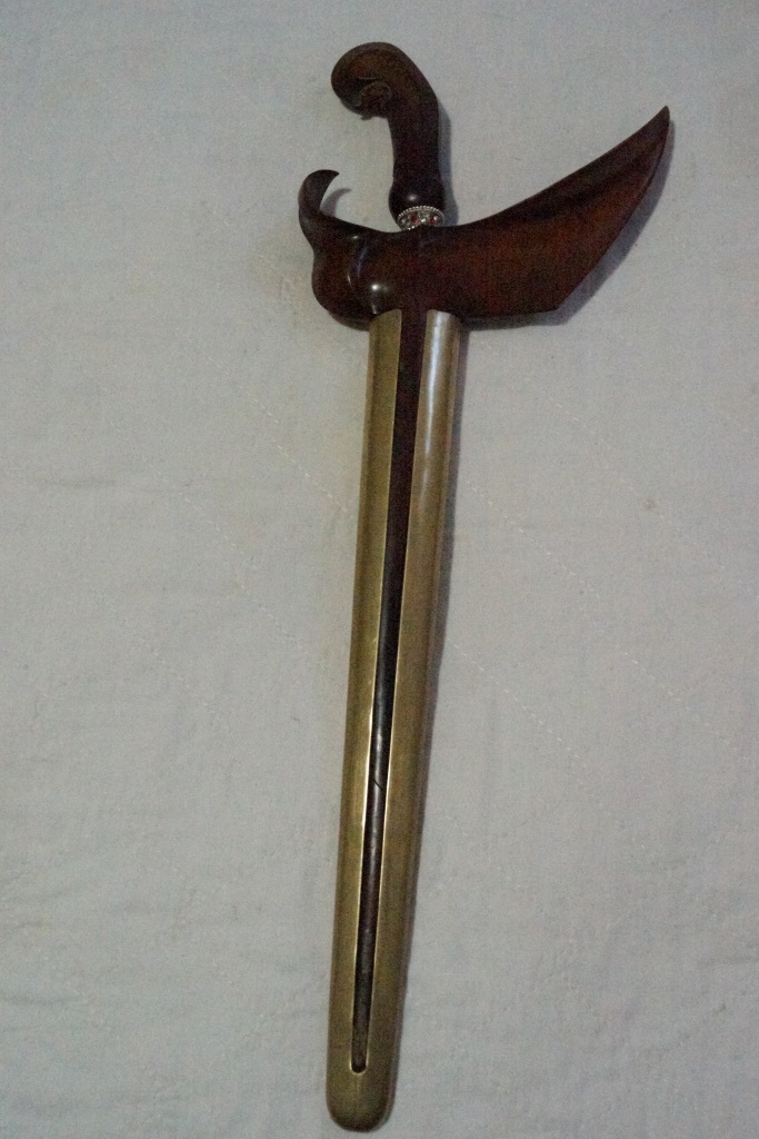

Here is another Keris that I have. Singa Barong 5 Luk with pamor Uler Lulut from 1800s.
Obviously, this Keris had Gold kinatah as I can see a little hint of gold traces in the wilah. Also, the hollow part of the Lion's mouth is giving away the fact that something was in it, most probably a golden ball.
My contact claimed that the gold was washed away due to aging and frequent cleansing. So there it is, a very 'clean' looking of Singa Barong.
The Keris was owned by a village head in East Java, who traded the Keris in exchange for a cow which was ritually slaughtered on the Islamic feast of sacrifice. The pamor itself is said to contain Prambanan meteorite (the meteorite that is reserved only for Kesultanan's Keris) and I have to admit that the pamor motif has a refined structure and an unusual brightness to it.
I would love to hear your comments on whether this Keris indeed contains Kanjeng Kyai pamor and how can one verify it. Thanks guys.

Peter, there is no known way to determine if meteoric ore is the source of the nickel/iron pamor once it has been forged into the blade. Many keris with contrasting pamor actually have no nickel content in their pamor at all (Bronson).
Obviously it would be even more impossible to determine if your keris has made use of the famous Kanjeng Kyai pamor, though personally i would think it highly doubtful. The entire idea of meteoric ore has been greatly overblown in the keris mythos and i would suggest that you take any claims to a keris being made with such materials with a very large grain of salt. Keris sellers will spin great yarns when selling their wares. Again, this material was reserved for a very small number of keris. There is nothing in your photographs that suggest this keris is one of them.
I would highly recommend you spend some time reading through this long and detailed thread in our archives for more perspective on the subject.

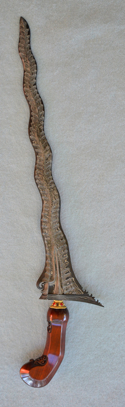

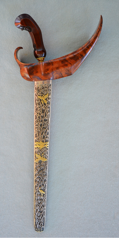

Here you are Peter, this blade has the pamor made from meteoritic material.
How am I certain?
Because I welded the pamor. Then I gave it to a gentleman in Solo whom I considered to be producing the best non-picture Surakarta style keris at that time and had him make the blade. It took him two attempts before I was more or less happy with the job. This blade is still not perfect, the sogokan are not as good as they could be, but he did the best he could with the tools he had. When I rejected his first attempt, I believe it was sold to a diplomat from a South American country, might have been Venezuela.
This keris was made a few years ago now, I forget when, but about 1990 I think. The maker has now effectively retired himself from making keris and out of respect for his wish to remain inactive I prefer to withhold his name.
The warangka is thuya burl, made by Sutejo, the pendok is the work of Bp. Dayadi (alm.), the jejeran is also by Sutejo, the mendak is an old one made of gold and set with natural stones.
Objectively, this could be regarded as a pretty fair example of a current era keris.
NB. a "picture keris" is one that has some sort of carving to the blade, such as a naga, or a singo barong etc.
