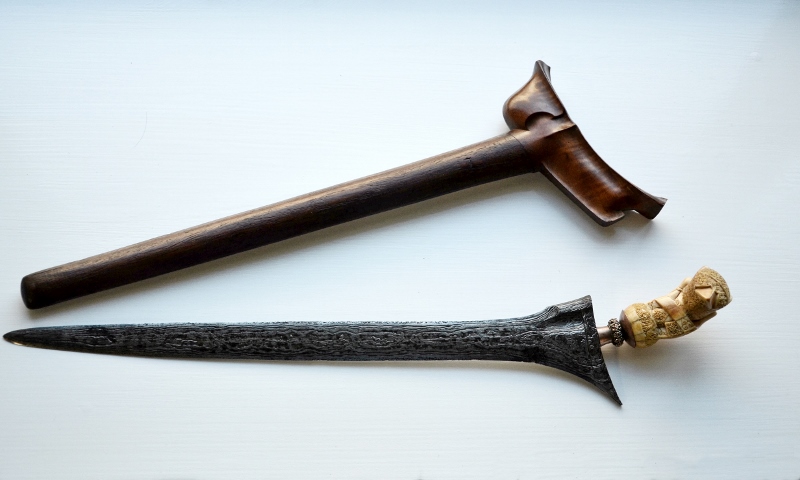

Happy Wednesday! After a brief technical glitch (thanks Lee, Rick and David for resolving this) I am back! Several members have made the suggestion to break up the keris in the post "Recent Additions" by type/area...honestly I needed help with this...so thanks to Kai and David we will begin with the first offering... Two Palembang keris.

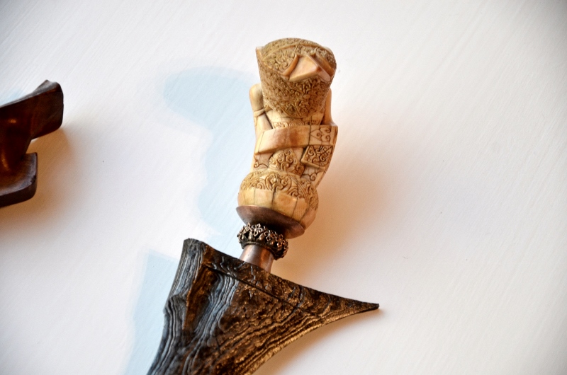

The first features an ivory ukiran (absolutely marvelously carved), a medak/selut of suassa(?). The length is 15" (all measurements from the gandik side of the blade from the top of the ganja).

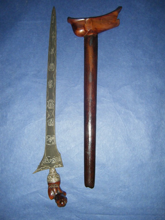

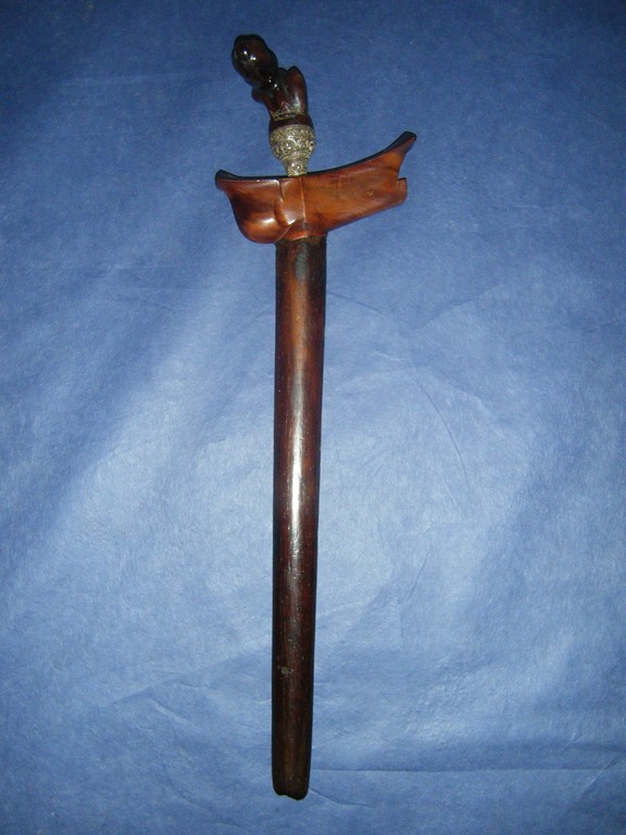

The second offering has a ukiran of horn, medak/selut also a suassa (?). 12" in length.
As I post these over the coming days, I'd humbly as that you'd please help me to understand more about these wonderful blades. Example; are these called Palembang due to the type of sheath/wrangka they are housed (one of the only commonalities I see)? Is Palembang the area they are found?

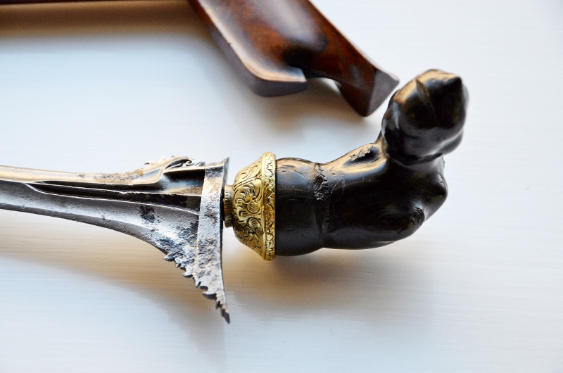

John, I think you might find that the hilt cup on the second keris is brass, possibly gold plated or gilded.
Palembang is in South Sumatra, it had and has long time political and cultural ties with the House of Mataram in Central Jawa, and was also influenced by Banten. Because of these associations the keris that come from Palembang very often have features that resemble either Banten keris, or Central Jawa keris.
"suwasa" (ngoko) or "suwaos"" ( krama) is low content gold alloy, supposedly anything under 14 carat. There are a lot of ways to spell this word, and there are other words for the same alloy. There is another alloy that is also called suwasa, and that is what we call in English "pinchbeck", the only way to tell the difference between pinchbeck and low carat gold is to get it tested by a jeweller.

Your first kris has a blade with ganja iras (integrated with the blade) which is very common in South Sumatra. The ivory hilt is in one of the specific Jawa deman styles from Palembang and a masterpiece indeed.
The second kris has a rare hilt in gana style which apparently originates from South Sumatra also although I saw some specimens fitted on Javanese krisses.
Both blades would benefit from cleaning and staining.

[QUOTE=A. G. Maisey]John, I think you might find that the hilt cup on the second keris is brass, possibly gold plated or gilded.
Thanks Alan for the information...my first instinct on the second keris hilt cup was brass, but I truly wonder if it is plated...no tarnish, no evidence of tarnishing.

I don't see any need to clean/stain the ivory hilted one.
I could stain the the other one for you John, but you might not get it back.
Both are lovely BTW.

Well, the pictures are not very sharp but I seem to distinguish some black rust spots on the sorsoran and at the tip especially?
Your eyes are sharper than mine Jean.
Even so, if some residual rust remains on this blade rust removal does not necessary mean restraining.
Jean, the original shots of these are super sharp but I had to resize them all to upload them.
Each blade that had any rust on them have been worked with steel wool and oil in those spots. I have seen several times folks post about "picking" rust...I even tried that...this black rust seems solid and stable...should the blades be soaked in WD-40 for a time?
