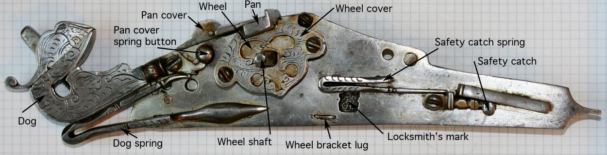

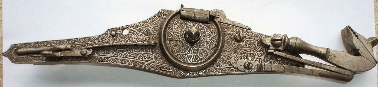

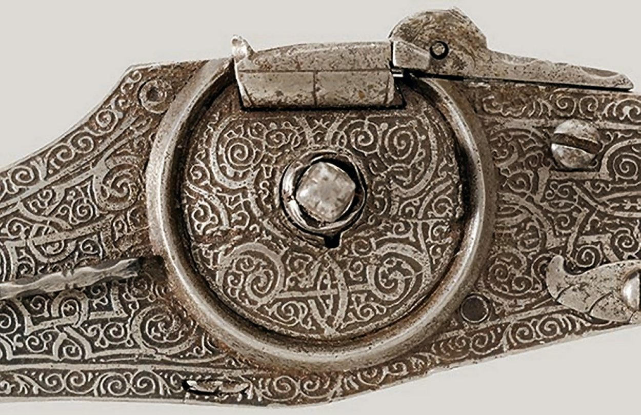

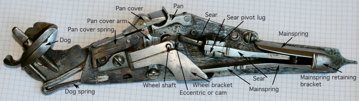

I found this on wikipedia and posted it here before.
Let me please do so once again in a thread of its own; its worth it, I guess, especially as some members still seem to have difficulties choosing exact denominations.
The only sad thing about this is that the first image showing the outside of the lock mechanism is of course shown mirrored. I could not reverse it because of the script. Please do keep that in mind.
The lock mechanism is German, the locksmith was Georg Schneider in Nuremberg, ca. 1575-80.
Enjoy, and best,
Michael

... The only sad thing about this is that the first image showing the outside of the lock mechanism is of course shown mirrored. I could not reverse it because of the script. Please do keep that in mind....
What you mean mirrored, Michl ?
Old 8th January 2014, 09:59 PM   #3
Matchlock
Matchlock's Avatar
Join Date: Sep 2008
Posts: 4,310
O.k. then, you scoundrel,
When you're here with me in Bavaria you gotta show me how you did that, you computer crack!
Best, and thanks a million,
Michl, a bloody computer layman

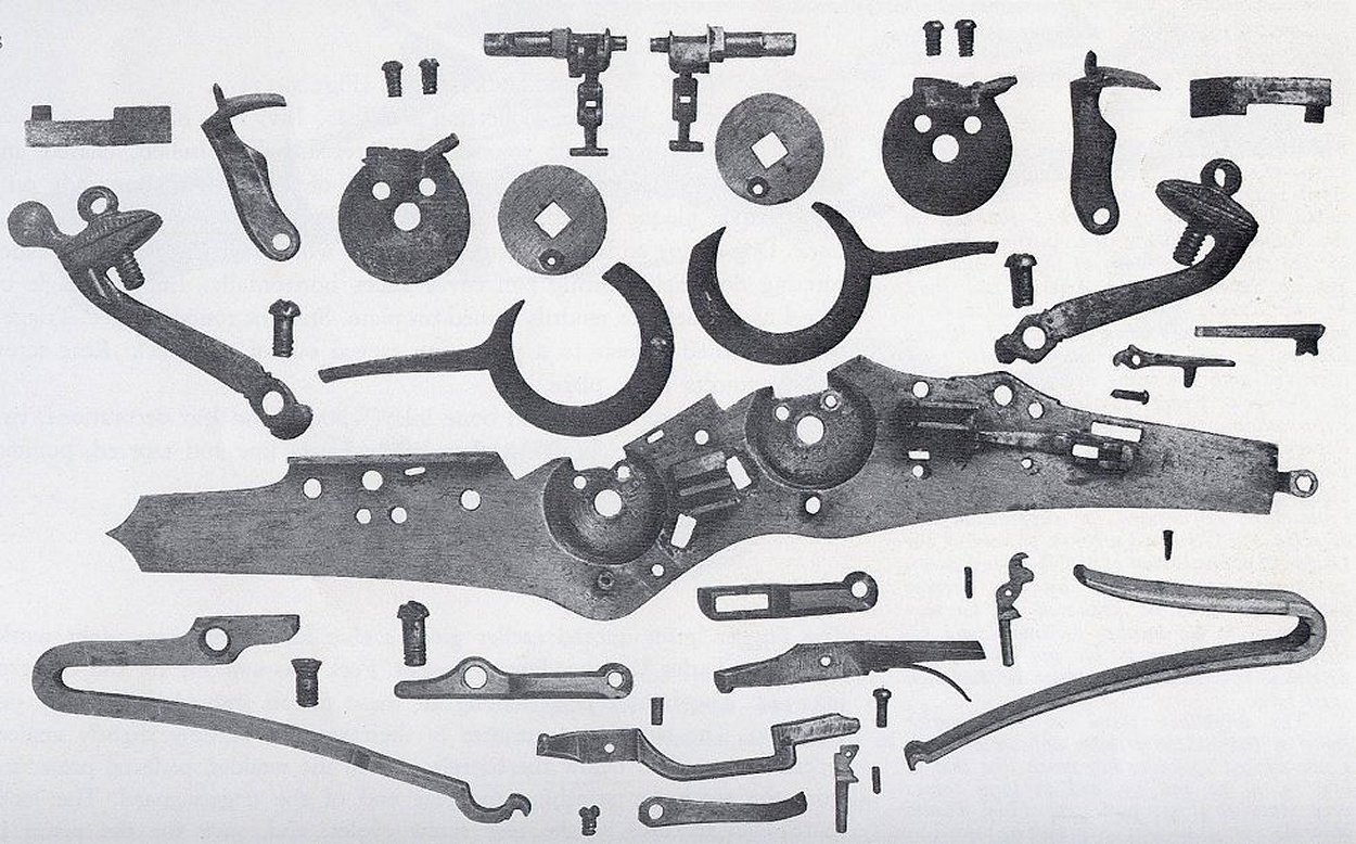

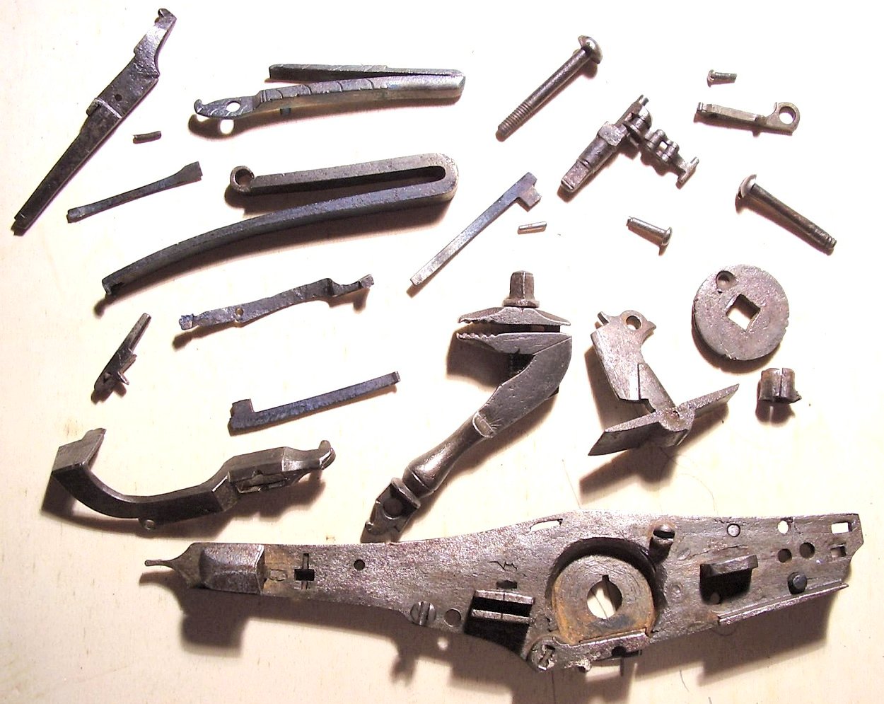

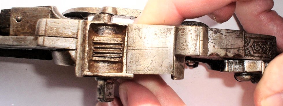

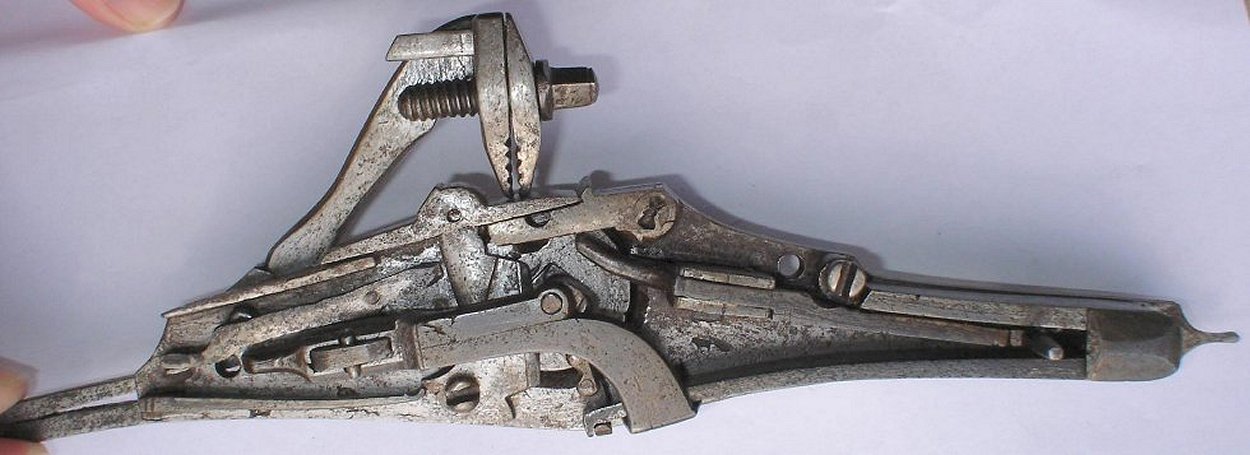

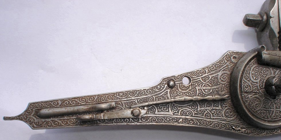

A finely etched, detached wheellock mechanism for a small arquebus, Ausgburg, Bavaria, ca. 1565-70, formerly in the author's collection; author's photographs.
This is one of the very rare instances that you can study a wheellock mechanism when completely dismantled down to all its tiniest parts, and the smallest of screws.
Michael

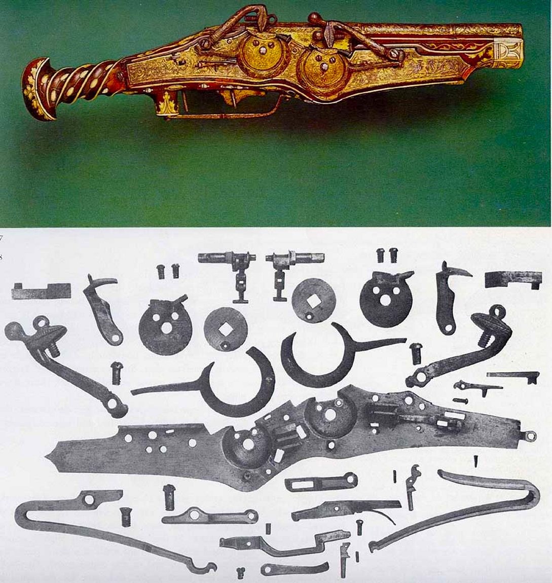

A finely etched and gilt double lock and barrel wheellock pistol, made by Peter Peck in Munich, Bavaria, in ca. 1540-45, preserved in the Met and dismantled to all its single parts.
Have fun jigsaw-puzzling!
m

What ... do you expect me to insert a legend in each part ?
Old 12th January 2014, 01:30 PM   #7
Matchlock
Matchlock's Avatar
Join Date: Sep 2008
Posts: 4,310
Well, 'Nando,
If anybody can manage to do that, then he must be a computer cracker like you!
Michl

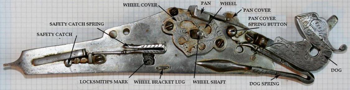

Old 13th January 2014, 08:22 AM   #13
Marcus den toom
Marcus den toom's Avatar
Location: Netherlands
Posts: 543
I think i did it
But some correction is probably needed
Old 13th January 2014, 10:13 AM   #14
Matchlock
Matchlock's Avatar
Join Date: Sep 2008
Posts: 4,310
Hi Marcus,
Gosh, you actually did it!
Thank you so much. It was quite a joke between 'Nando and me, I would not have expected anybody to achieve this aim.
I have only very few suggestions to make as long as you can still edit and alter your post in the course of today:
3: wheel cover plate screws
9: dog with upper and lower jaw and tightening screw (it is not a hammer as it does not strike)
10: combined pan and wheel cover plate
15: dog retaining screw
5: combined wheel shaft, excentric and chain
7: pan cover
8: pan cover plate
14: dog with upper and lower jaw and tightening screw
18: dog retaining screw
19: safety catch spring
20: swiveling safety catch
21: saftey catch screw
28: combined left sear and right trigger release spring
31: left main spring pin
37: combined right sear and trigger release spring
Anyone with other sugggestions?
Michael
Old 13th January 2014, 10:48 AM   #15
Now, that's a cracker alright .
Thanks a lot Marcus .
Saved in my libraries..

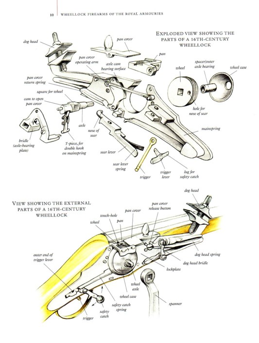

I know its getting down to silly detail but their doesn't seem to be a general agreement about a descriptor for item 30/38. Proposed 'trigger release '
Other variations include 'trigger lever' or 'secondary sear'. I sometimes refer to it as a 'prop' because that describes what it effective does. That is props up the tail of the primary sear locking the primary sear into the wheel. I think my preferred descriptor would be 'secondary sear' in order to avoid confusion with some earlier locks that use a single sear .

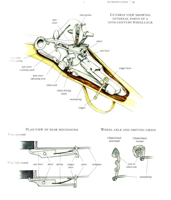

Perhaps someone could provide labels for the numbers in German as well?
As I want to learn more and more about wheellocks / Radschloss I am grabbing anything I can see whether English or German language and it would help greatly to find an antique arms vocabulary!
I have the IMO wonderful Catalogue of the 4000-piece Wheellock Collection from the Landeszeughaus in Graz, and a number of their publications, which are some in German and some in English. Radschloss Sammlung - Wheellock Collection, Landeszeughaus Graz by Robert Brooker. Radschloss Sammlung - Wheellock Collection, Landeszeughaus Graz, Austria. 730 pages, ill. http://www.antikmakler.de/catalog/lng/en/bv19818.html
The book 'How to build your own Wheellock Pistol or Rifle' edited? by Georg Lauber has full construction drawings (dimensions in decimal inches, though some were said to be produced in mm) of a 1640s-style wheellock with the thin wheel entirely outside the lockplate. I have once scanned this entirely as it is out of print and quite expensive when you find it. A 2007 thread at the Muzzleloading Forums has a post detailing the small errors found by someone who built one from the drawings.
The slightly-thicker-than-a-pamphlet book Wheellock Firearms of the Royal Armouries by Graeme Rimer which has the pictures and part names below on pages 10 and 11:
http://www.royalarmouriesshop.org/bo...armouries.html
