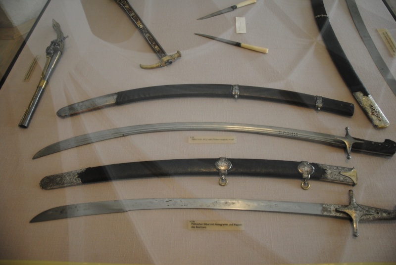

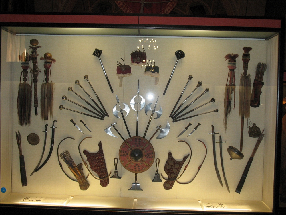

Just for fun's sake, here are pictures of karabelas from Vienna: the first one is from the Military History Museum, and the other two from a display in the Vienna City History Museum. I took a close up a few years ago when I was there, but it is too blurry, so I am posting picture of the entire display. Both displays are dedicated to trophies, taken during the second siege of Vienna (except for the Ethipian presentation shield, which the curators must have misidentified and misplaced, of course ).
I am also adding a picture from the Army Museum in Ingolstadt: it may have been posted here before, I do not remember where I got it from.
Teodor
