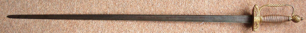

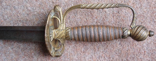

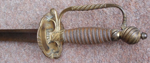

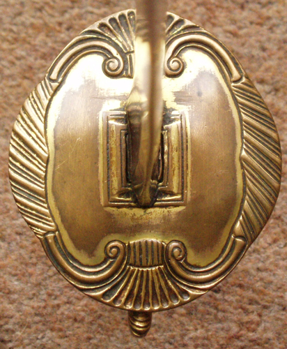

Hi,
A new addition. An unusual, from what I can find, Smallsword mounted with a Spadroon type blade. I can find references to military smallswords but all the illustrations are of double edged diamond section blades and none are of single edged blades with a false back edge. If anyone has any photographs or illustrations of a similar set up to the one in these photos I would be really interested to see them. The hilt is gilded brass with quite a good bit of the gilding remaining. The pas d'ane is for looks only, the double quillions appear to be less than usual, the grip is bound in copper wire and copper ribbon. I would suggest a date C1760. Unusually there is also a tricolour silk 'sword knot' still attached although this is in rather a delicate state. The blade is 32 3/4 inches long, width 1 inch at widest and 3/8 inch at its thickest. The false edge is 8 inches with the first 5 inches sharpened. The blade is decorated as per the photos and is not maker marked though I suspect it's probably German. In conclusion my thoughts are that this is a Military Smallsword C 1760. I would of course be interested in your thoughts and comments.
Norman.

Wonderful addition, Norman .
Yeah, the blade looks Solingen ... and a bit earlier than the hilt ? .

Hi Fernando,
Thanks, I'm not sure about the age of the blade. I was going to comment on your Portuguese smallsword that the blade looked to be older than early 19thC but you beat me to it.

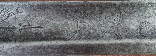

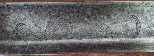

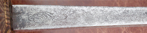

Hi,
Some more blade details including a photo of a mark on the spine, does anyone have a blade with the same/similar spinal marking?
Norman.

The blade seems to me to have most of the characteristics of those "Runkel" blades of the early 19th Cent.

Although this type of blade and decoration extended into the early 19thC I'm certain this blade is contemporary with the hilt C1760.

The little squiggle on the base of the blade seems like a Solingen specific mark, just as the wolf had been for Passau. A guild mark (my thoughts).
Cheers
GC

Hi Glen,
Seems possible, I'm sure I've seen the same or similar on other blades, still trying to find some more examples.
