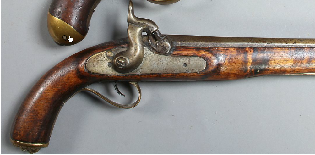

I won the auction on this pistol today. It came with a Danish M/1848 Liege cavalry pistol which is going into my collection.
Since I know nothing about this pistol I ask for your help, any info will be greatly appreciated.
The auction house called it a "English composite percussion pistol".
Thank you.
HB

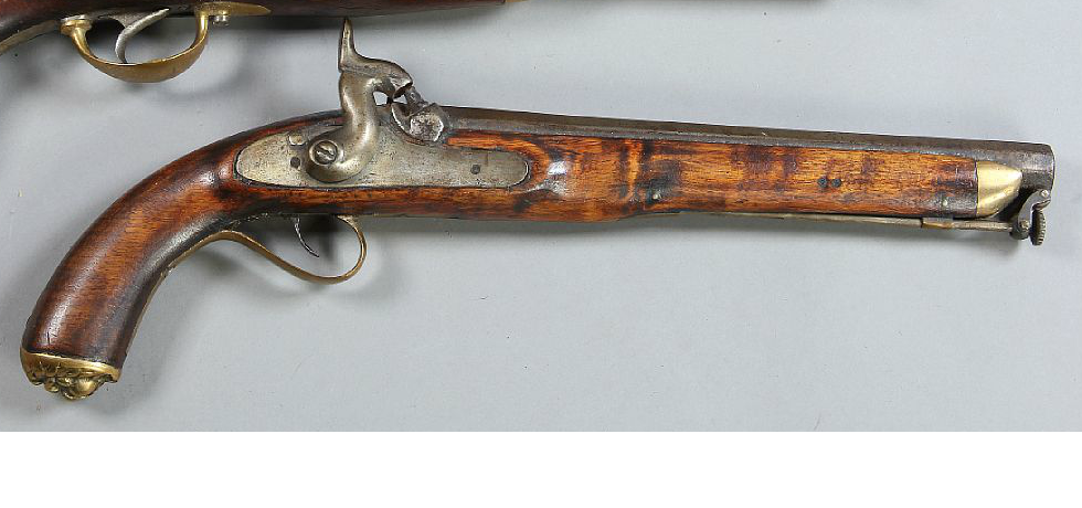

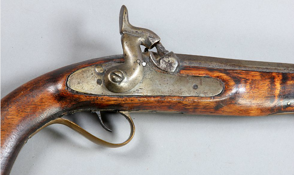

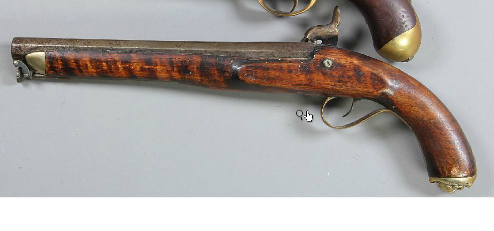

Composite meaning made up from bits of other guns. Looks like and old barrel and lock with a new stock and brass butt cap. The trigger and guard look like they come from a shotgun. Please do not attempt to fire this. The throw of the hammer appears to not clear the nipple if it had a cap on it. The lock plate shows two screw holes but from the other side only one screw head is visable. Check how the barrel is secured to the stock. I have shot many old pistols that have been made up but the build quality of this one I think is a little suspect.

It looks all very crude, doesn't it ? .
The barrel must have been for flint, converted to percussion; this would explain the shape of the present lock plate.
The stock looks like a raw work, not made by a professional gun maker.

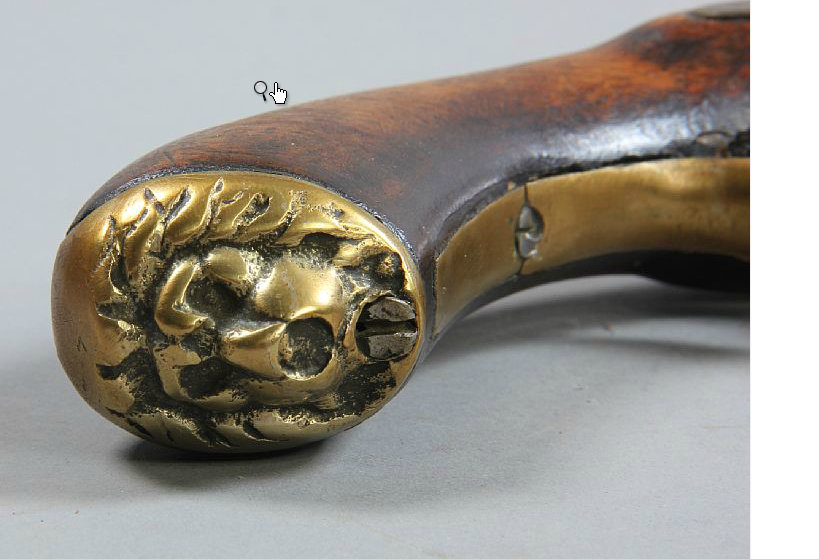

i was also suspicious of it being a recent pakistani/indian unproofed replica. hence my guarded comments. they frequently have misaligned nipples and hammers and rather crude workmanship at the low end tourista level. many do not even have the vent holes drilled thru. the lock, barrel, and strapping are crudely inlayed and gaps filed with some gunk, the pins holding the barrel seem rather thin as well. i suspect the wall thickness of the barrel will turn out to be rather thin. i saw a replica lion butt cap on sale for £18 that looked very much like that one. but better.
the composite description was telling. i was waiting for more comments before posting this. i was reluctant to be the first bearer of bad news.

I think one telling thing that was a major red flag to me was the lionhead butt cap. These guns are presumably representative of the East India Co. pistols which seem to usually have the rampant lion on the lock, and the butt plate is flat brass. Ive never seen a lionhead butt plate on a military pistol.

I have tended not to comment on this section of the Forum as it is a while since I dabbled in these things. I do however have to agree with others comments about this piece. There are a number of relatively obvious "errors" which suggest NOT of English make, and I do feel not of factory manufacture either. I use the term "factory" to describe what those in Europe understand as a place of firearms manufacture.
IF there are any proof marks present then at best I would think a put together piece using available parts from other guns.
