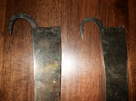

The Samoans had the Nifo Oti which was a long rectangular blade with a small hook curling away from the top edge. You can find it in:
Early Photography - Tonga and Samoa 1855 - 1900 by Kurt During, and in the book Samoan Art and Artists by Sean Mallon. The Samoans fought with these during the civil wars during the mid to late 19th century.
Now, the same type of piece has the blade set on fire and is danced with at Polynesian themed events.

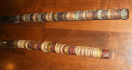

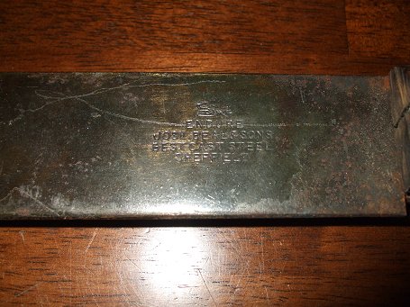

Here are some pics of a pair that I purchased a while back. These were collected by a Mormon Missionary that was in Samoa during 1929 and 1930. The blades are British steel. One is marked with a Boar's head over the words "Endure / Josh Beal & Sons / Best Cast Steel / Sheffield", and the other appears to be Birmingham / England, but I can't make out what's stamped above it.
The longer of the two is just under 39" overall in length, with 19 5/8" of the total being the blade. The second is 37 1/2" overall in length, with 20 1/4" of the total being the blade. The steel blades are 1/8" in thickness. The coconut fiber cord is pretty unraveled, but hanging on.
Clubs & Arrows is offline   Reply With Quote

wow!!!, nice.. seems those were british made blades,,so i guess there was enougth demand for them to produce them i a quantity,, has anyone got any of the clubs these weapons were based on?

I've done a bit of a study on photos that have been publicly available of Nifo'Oti (I've sighted eight early Nifo'Oti) and most of the early examples were manufactured by Joseph Beal & Sons in Sheffield. Some had no markings so they gave no clue to their origin. It is unclear exactly when they were exported to Samoa. Several of the Joseph Beal & Sons blades have different markings - indicating different shipments.
Below is a compilation I've made of the markings. I've included the logo of the websites where they were found. It would be interesting to hear from collectors that have a Nifo'Oti that I don't have a photo of yet.
