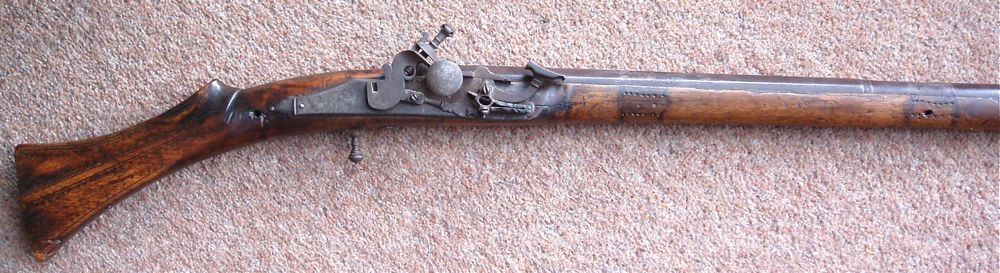

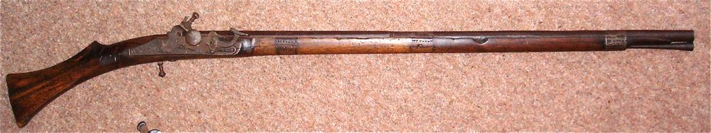

Default 17thC Scottish Snaphaunce Musket
Hi,
First of all I would like to thank Michael (Matchlock) for his time, patience and expertise in helping me with this musket.
I will really have to let the photographs do the talking. A second half of the 17thC Scottish snaphaunce lock with possibly an earlier barrel, almost complete. A "Wee Beauty".
Norman.

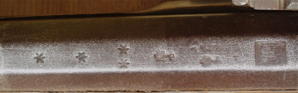

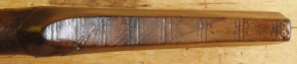

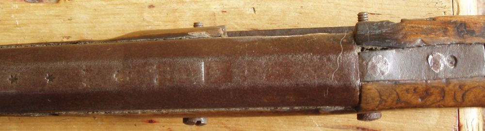

Hi,
Some more photos of the barrel stamps and the underside decoration around the trigger. Barrel length 31 3/4 inches total length 44 1/2 inches bore just shy of 3/4 inch.
Norman.

Old 8th July 2012, 03:11 PM   #3
Ah, great stuff, Norman.
I shouldn't tell you that, affraid you get too vain .
... But alright, you deserve it

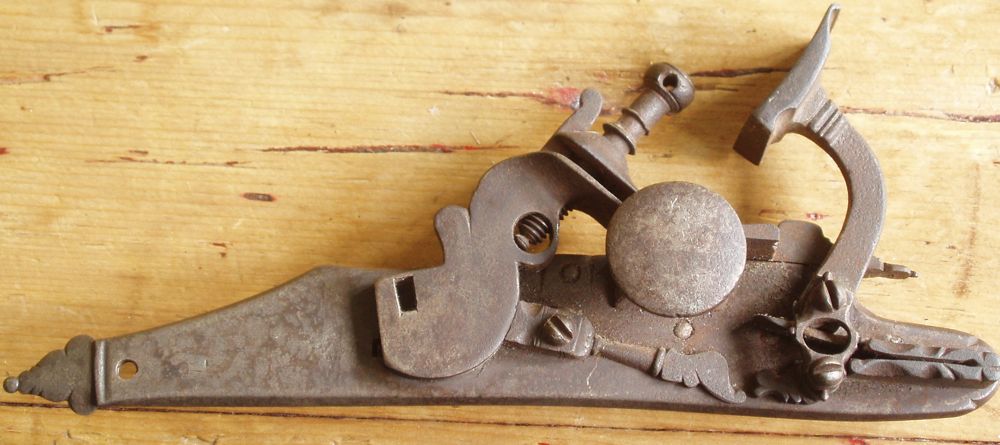

Posts: 1,633
Hi Norman!! Thanks for the PM heads-up. OHHHHHH my goodness. A "Wee Beauty" is certainly correct. What a fantastic find!! Except for the middle and rear barrel bands, it looks complete. Even the trumpet shaped ramrod. The lock design and partial fishtail butt stock looks sooooo Scottish. I must admit that I'm jealous with envy that you saw this gun before I did.
Thanks for the great photos. Hope you don't mind me saving these in my photo library? The lock appears complete. The sear assembly seems to be a slight variation from others I've seen. What a wonderful, interesting gun. I'm glad you were able to enlist Michael's expertise on this. Did you locate this gun in Scotland?
Again, my congratulations. A wonderful early piece that just reeks with history. My hats off. Rick.

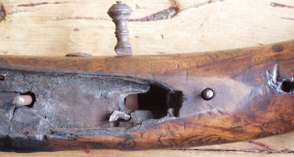

Posts: 1,633

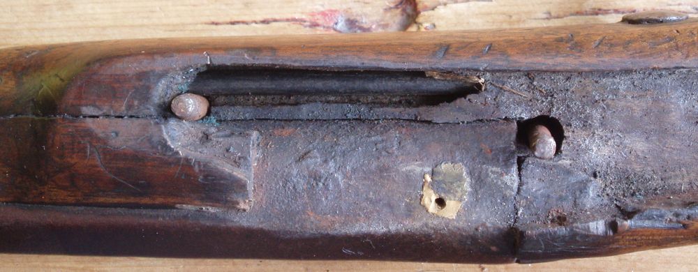

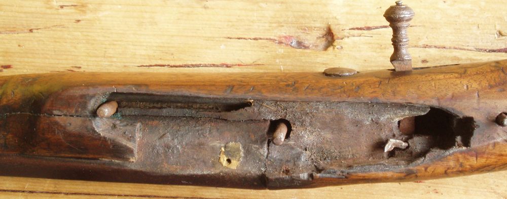

Just noticed the two holes in the stock. One at the wrist, and the other where the middle barrel band use to be. This indicates that this gun may have had a sling installed at some point in the past? Rick.

Posts: 1,633
Hi Norman. Yes, the gun may indeed still have a load in the barrel.
Of course, this won't be the first old gun that was aquired still loaded. Since I have the tools needed to safely extract that load (or other obstruction) I suggest you send the gun to my house for analysis and unloading. It shouldn't take me more than a couple years.
When you lower the rod into the barrel, does it feel/sound like it's hitting something solid or soft? Rick.

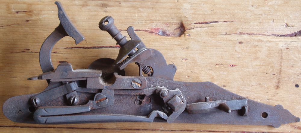

Posts: 1,657
Hi Michael,
I was hoping you would come in with a detailed description. Having had more time to look at the piece I get the impression that the lock may not be the first that has been on this gun. The attached photo suggests to my untrained eye that a large washer or a larger headed screw/bolt was once there but this may be as a result of the screw/bolt being replaced rather than an attachment for a different barrel, as I can see no evidence of a trigger guard ever having been fitted to the stock it gives me more hope that the stock may originally be of Scottish origin rather than continental. I have sent photographs to Mr Jonathan Ferguson curator of firearms at the Royal Armouries who is going to confer with Mr Robert Woosnam-Savage who co-wrote a book on Scottish firearms so hopefully definitive information may be coming soon. Many thanks for your kind words and interest.
Kind Regards,
Norman.
P.S. When I think about it the composition could be any combination of lock,stock and barrel

Posts: 4,310
Hi Norman,
Agreed: in the worst given case the item may be composite from three different main parts, and the brass-filled touch hole may conceal the fact that the barrel was converted to (and rebuilt from) percussion - in which case the lock cannot belong.
Also the crispness of the surfaces of barrel and stock differs greatly from that of the much better preserved lock, showing that the first two have seem much more use (and abrasion).
Telling from your lines, my intuitive initial premonitions seem justifiable.
From all I have learned in over 30 years of closest study is to be extremely careful as soon as an item does not look completely characteristic in all its single aspects; riveted screws or pins and crude alterations have become amber lights to me: the only explanation is that somebody intended to prohibit others from dismantling the gun for research - which is completely contradictory to the fact that all main parts of a gun must be easy to dismantle in case when cleaning or repair is needed.
On the other hand, you certainly did not overpay the piece, and some of the scans I attached show that trigger guards were used on both English and Scottish snaphaunce guns from the end of the 16th c.

Posts: 1,657
Hi Michael,
Apart from the obvious the lock on this rifle is the closest in details I can see to mine. On a separate note, there are two small square holes, non identical, and two very small round ones in the rear of the butt. Are you aware of this style of butt occasionally having a separate buttplate maybe attached with hand made square nails, or could it have been a butt extension as we have these days for different sized shooters. Being a regular shooter I know just how important this sizing is. Just some thoughts.
Kind Regards,
Norman.

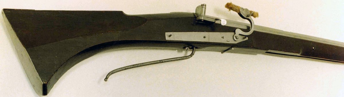

Butt plates did not normally appear before the 1580's on European military muskets, and they were made of very thin hammered iron attached not by nails but by tacks, with small, irregularly shaped but mostly rectangular heads.
Attached are details of a very fine German (Suhl) matchlock musket, ca. 1590-1600, overall length 1.67 m, weight 8.4 kgs, preserved in as-new condition; author's collection.
Only during the first half of the 18th c., butt plates got thicker and more figured, made of either iron or brass - depending on the material employed for the rest of the mounts.
Michael

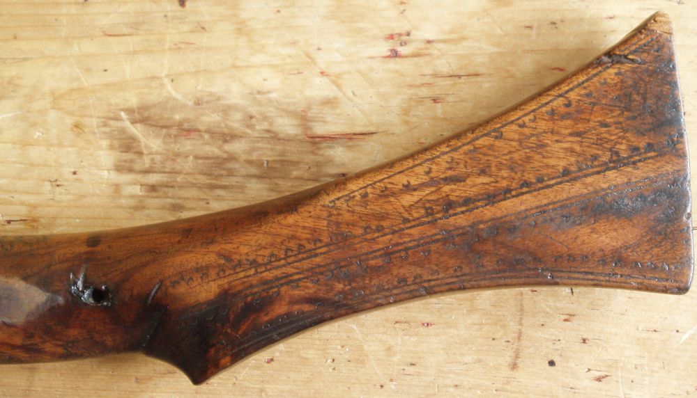

Hi Michael,
Photo of the rear of the butt. Got it too, iron butt plates used to protect the wood rather than an aid to shooting.
My Regards,
Norman.
P.S. You can see where the bottom edge has been knocked off at some time and repaired.

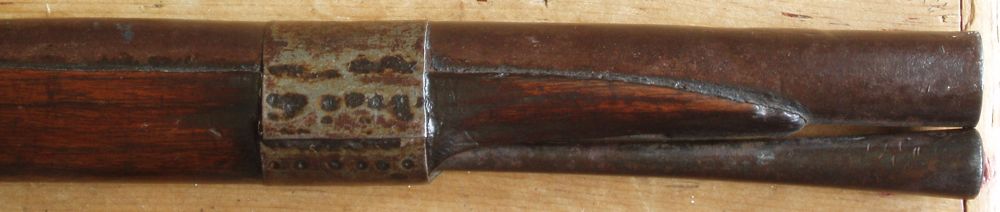

Posts: 1,633
Hi Norman! And Michael! This has been a great Thread to read. Really enjoying this. Thank you both. A couple of notes:
The brazing at the touch hole area is curious. Could it be that the barrel was used on a previous gun? The current gun and lock combination requiring the vent hole in a different position? But, as Michael said, it is curious that it was done so crudely. Hmmmmm.
Norman: If you have an opportunity would you let me know some dimensions? Overall length, barrel length and caliber, lock length and width, etc. Only if you get the chance. Thanks. Rick.

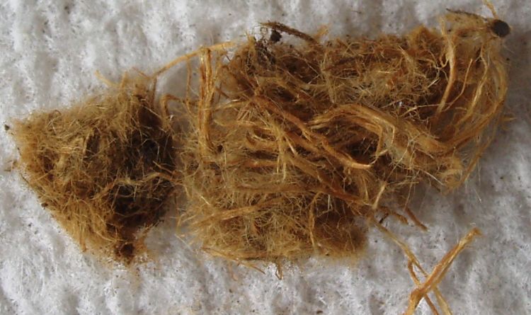

Hi,
Attempts to remove whatever is in the bore have so far been unsuccessful but this piece of material, wadding?, and what might be small pieces of hard 'grease' was attached to the screw upon withdrawal. I would appreciate your opinions on it. I will make a tool with a deeper thread and have another go!
Norman.

Hi,
Norman.
Keep going mate.
This looks like the same flaxen material used in the maufacture of old sword canes. Perhaps this is part of an old late 19th/early 20th century method of deactivation.
Gav

Hi Gav,
You could be right, don't know whether it is an old 'de-ac' plug or a ball and charge. Never having had a sword cane what is the flaxen material used for? Thanks for having a look.
My Regards,
Norman.
