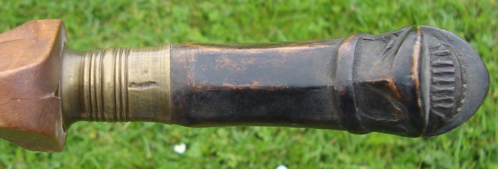

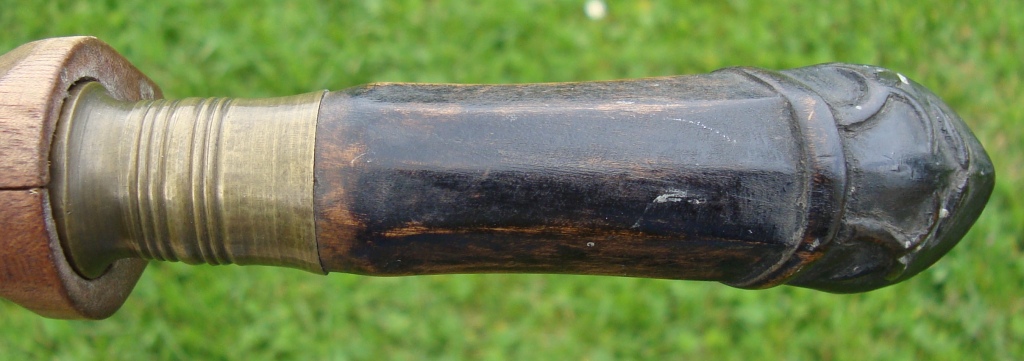

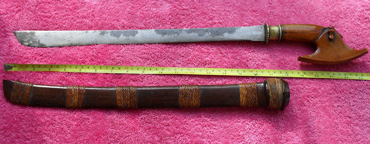

Bought from a bad photo from an auction catalogue. I thought it was a Balato from the photo.
Now I don't know what this is.
O/A length is 24 ins with a 19 1/2 ins blade
Blade is 3/16 ins near the hilt.
Blade is not sharpened for the last 4 ins near the hilt.

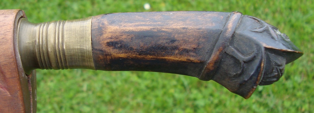

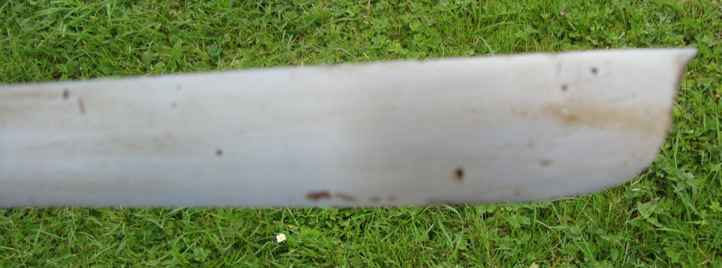

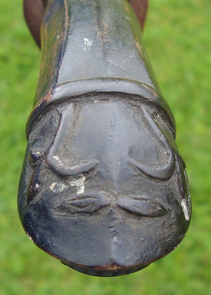

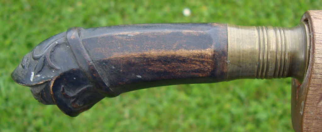

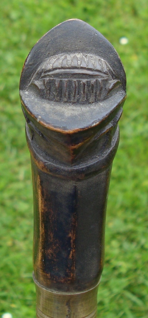

What I like about it is the interesting carved fish or serpent-like wooden pommel and the unusual tip to the blade. ( sorry. out of focus but it shows the shape )

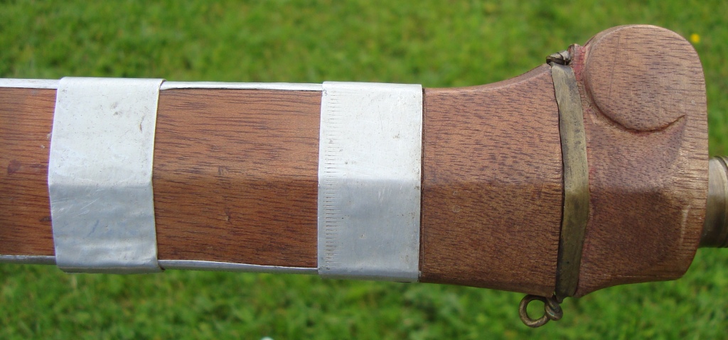

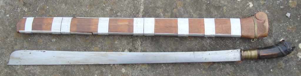

The scabbard may be later but it fits ok. The straps are aluminium.
So, what do we have ? As I see it. The blade is a bit Balato shaped but sharpened on the wrong side and the tip is wrong.
Pommel reminds me a little of Visayan ( Monster hilt )
The brass part of the hilt is a little like Morut work.
Scabbard is the most Nias part of it.
All suggestions will be welcomed.
Thanks
Roy

Hi Roy,
to my opinion it is a Balato and the blade seems ok to my eyes, have a look to "Traditional Weapons o. t. Indonesian Archipelago" from Albert G. van Zonneveld, page 29. My guess is that it is one from North Nias and not very old, maybe 1940-1950. It seems that Balatos have been in use for ceremonys also long after headhunting times. This is all my guess and others could have different opinions.

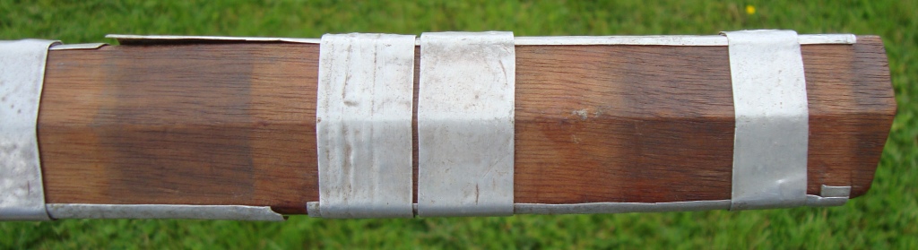

Are the bands on your piece aluminum?
Old 6th July 2012, 08:00 AM   #6
Hello Jose:
Hello Roy,
I'm with Detlef and the others: definitely a balato. These are still in current production on Nias and mainly used for dances as well as tribal acoutrements for the local actors showing off village life for the many visitors. Of course, these are also available as souvenirs.
I'm fairly sure that this is post-WW2 and possibly quite a bit younger (the scabbard could easily be very recent). There's little apart from patina and wear (and, if any, reasonable provenance) to date these though. The blade looks better than the many beaten up pieces around; trying to etch it wouldn't hurt, I guess.

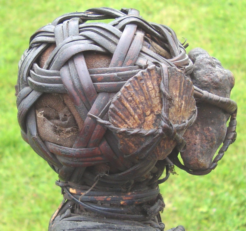

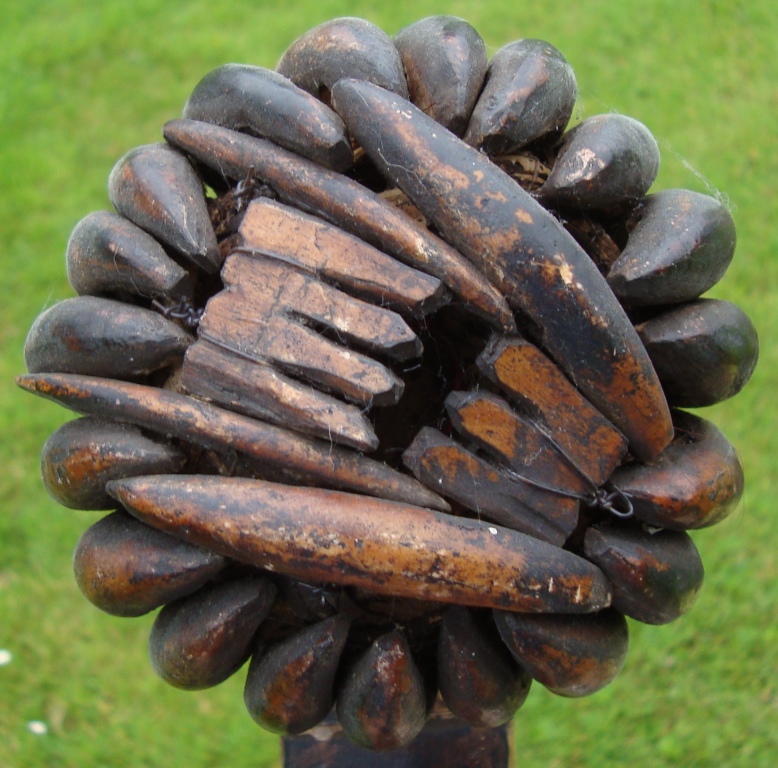

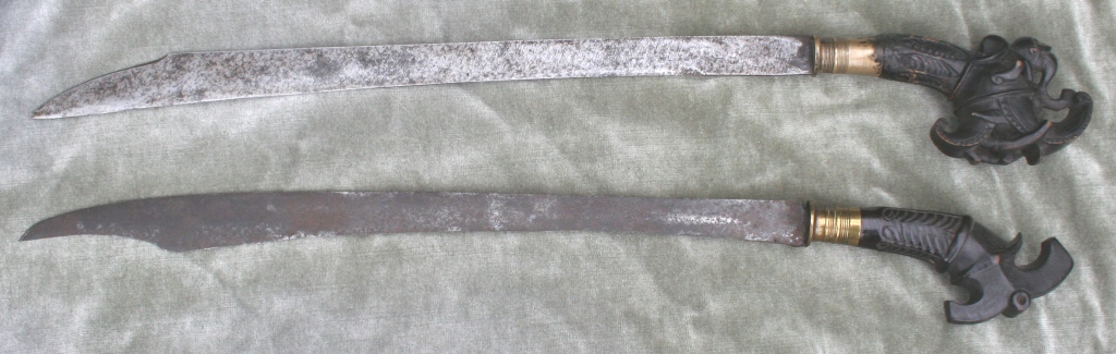

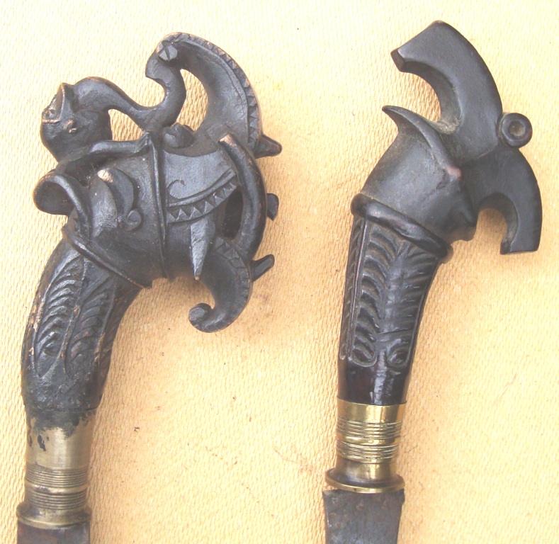

For comparison I have included photos of two more from my collection. The one with the intact " ball" is definitely old.
Cheers
Roy

The hilt is a simplified beast head, a 'Lasara'. Again these vary from fully formed 'monster heads' through to more stylised forms like the one that I had that looks almost like a bird of piece of flora.
Here's another one with a similar blade to yours but an unusual hilt form.
