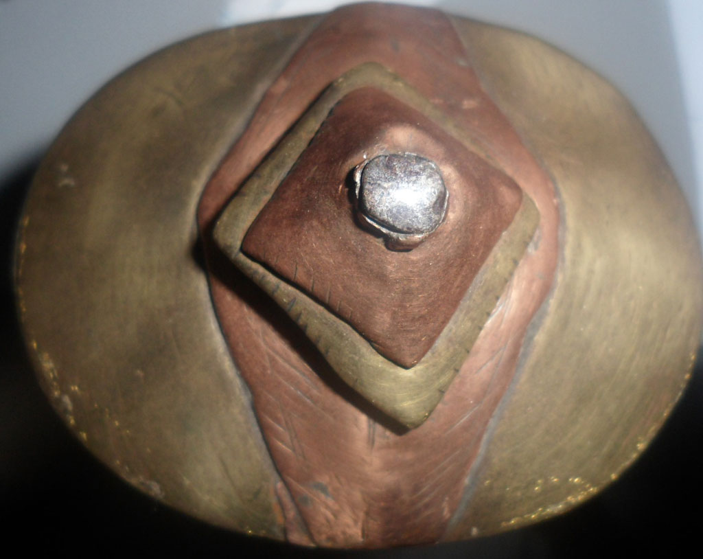

I would be interested to see closeups of the hilt, particularly the pommel, I assume it is the usual stacked type, but a closeup would help to ascertain quality and age.

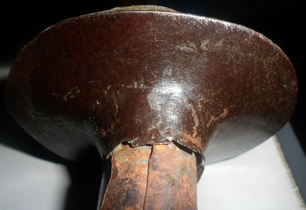

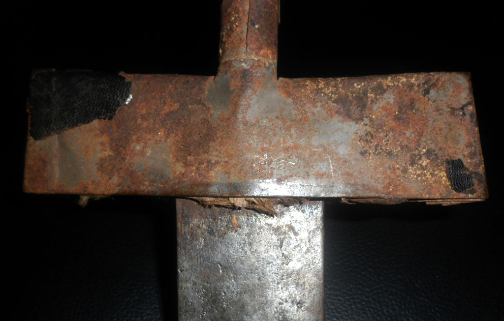

Received from regihis:
Old 6th February 2012, 09:54 AM   #4
Iain
Iain's Avatar
Join Date: Mar 2010
Location: Olomouc
Posts: 1,720
The leather was obviously refreshed fairly recently and the mounts are not particularly old, however I feel the blade may have some age to it. The piece as a whole is probably not earlier than the 1940s-50s, what do you think Lee?
Old 18th May 2012, 04:37 PM   #5
Lee
Lee's Avatar
Posts: 1,004
I am sorry that I missed this previously. Iain, I think your estimate of the date of assembly of the current form is correct - the scabbard is not new, but also not ancient. The blade will surely be 19th century if not slightly earlier and the hilt and its leather also shows some age that could also extend back into the 19th century. The leather ages quickly in the harsh environment and may appear deceivingly old. These swords will usually have been refurbished on multiple occasions. But this example surely appears to be the genuine article and not a recent 'tourist special.'
