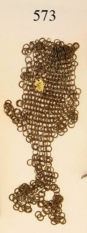

This fragment of a 15th c. mail shirt, in excavated condition, was sold at a South German auction a few years ago.
What is most remarkable is that it retained a brass seal struck with the Nuremberg proof mark.

Old 7th April 2012, 02:37 PM   #4
Swordfish
Join Date: Oct 2010
Posts: 129
Good find! With an experts eye!
Do you have acquired it?
Unfortunately its clearly a fake!
I have not seen it in reality, but no doubt. Two of the holes of the shield have no rings, the third is broken, and the fourth surely as well.
The same mark was on a mail fragment of clearly different shape, sold at the same auction house October 2009 lot 421.
The same mark again on a complete shirt, sold October 2008 lot 388 at the same auction house.
The mark without mail fragment, described as genuine, is actually for sale in the USA.
Best

When I saw it the first time (in the auction catalogue), I was immediately sceptic about it. The whole style looked not good to me. The arms and the surrounding dots are handmade. If the city of Nuremberg used such a mark, it would surely have been stamped with a punch. If it is an original fragment, all four holes or at least 3 should retain the original rings, not broken, and the rivetting intact.

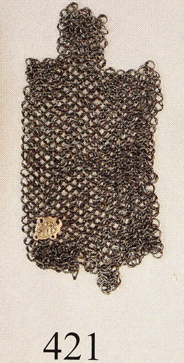

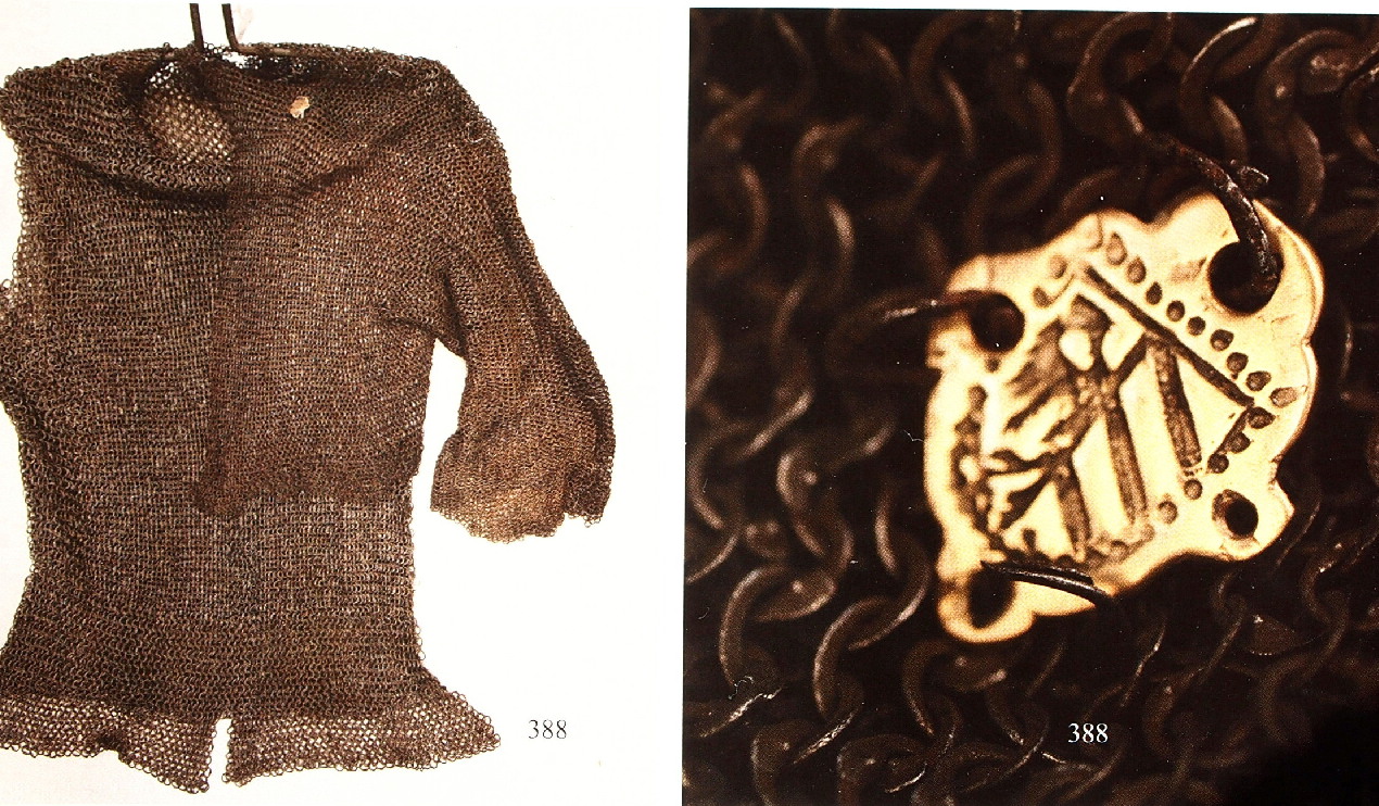

After close examination of two of these marks, I have to revise my opinion.
The arms and the dots are not handmade, but the stamp or the casting mould with which these fakes were made, is crudely handmade.
Otherwise you are completely wrong.
The facts are: 3 identical (not similar,but identical) marks with the same irregularities.
The first sold October 2008 lot 388 on a not excavated mail shirt of poor quality with missing parts.
The second sold October 2009 lot 421 on a not excavated small mail fragment.
The third (depicted in post#1) sold October 2010 lot 573 on a small corroded fragment.
Town marks or inscribed brass rings are never cast or single handmade items. They are always stamped and punched from a sheet.
If the town mark is included in the mesh of the shirt, it must have been added during the manufacturing. This is impossible, because a proof mark or an arsenal mark can only be added to a finished mail shirt. Or the finished mail shirt must have been opened to include the mark and fasten it with some new rings. (unlikely)
Or the mark was added to the finished shirt with additional rings. See the brass ring with name Nurenberck in my thread Research on a fine medieval mail shirt. This practice was usual with rings but not with shields. If a ring with a town name was possibly not a proof mark, but a quality mark to show its provenance, it could well be included in the mesh during the manufacturing. See the rings Bertold vor Parte and to Isrenloen in the thread mentioned above.
All examples of shield marks I know are rivetted to the mail shirt with one or two rivets.
Traces of wear or age can be found on every fake.
There can be no doubt, these marks are fakes from the same workshop!
Best

Here are the photos of the two other marks.

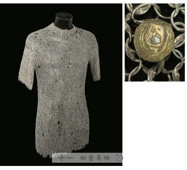

Additional I have attached a photo of a mail shirt, sold Christies May 2008, with a shield-mark inscribed Statt Nurmberg, fixed with a rivet.
I know the methods of casting in medieval times.
But believe me. These rings and shields are stamped and punched!
If you once have made the tools, its only a work of seconds to make a mark from a piece o brass sheet metal.
The ring with the name borsteken has a thickness of only 0.7 mm, the height of the minuscules is 0.3 mm, the whole thickness therefore 1 mm.
The rounded surface, which resembles a cast item , comes from years of wear.
Best

thanks for the pictures, with this new information I must conclude that indeed it does not look good.
there is probably someone trying to falsify the origin and multiply the value of mail and pieces of mail.
