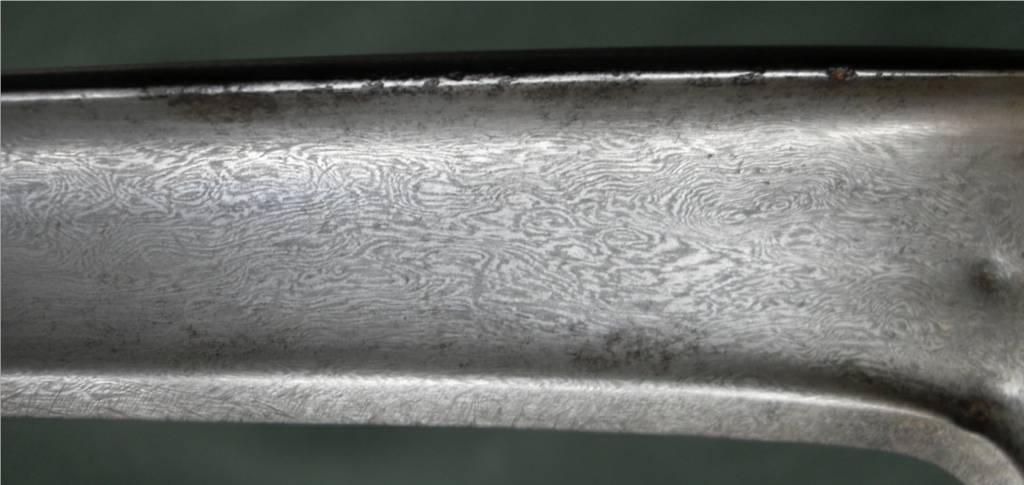

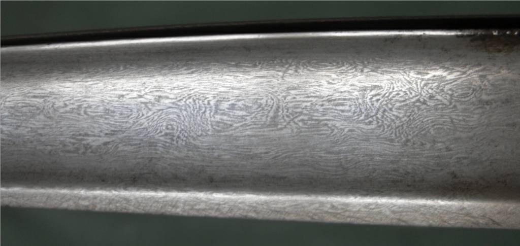

Just thought I would share my first attempt at bringing back this Blade.
Would welcome any feedback

Excellent, Good wootz and good work. Well done.
Are there some small rusty spots left at the base and ridge? Make sure to clean those and wash the blade with warm soapy water after etching and also keep some oil on it for a while before final cleaning.

The small brown spots are a tiny amount of the varnish that was on the Blade.
I then gave it a metal wax, is that ok to use?

Thanks for your kind comments.
I used a fine wire wool to remove the brown varnish.
Then a fine grade 1000 paper, but only once or twice over the Blade.
I used Ferric Chloride applied with a toothbrush, constantly stroking up and down the blade. I done this for about 2 or 3 minutes both sides.
Washed with water, dried and used a soft cloth to very lightly polish.
Then applied Renaissance Wax to it.
Hope this is of help.

Salaams templarnight Please see forum Library by typing in Wootz for a full account especially by the author of this fine description Gt Obach ~ Quote"1) Wootz damascus is a crucible steel... some ingredients are melted in a clay crucible till liquid then cooled slowly in the vessel. The goal is to produce a ultra high carbon, dendritic steel. The ingot is then forged out into a blade using a low forge temp inorder to grow the carbide pattern. The blade is then etched and you see the waterings
2) Forgewelded damascus- several pieces of bloom steel are stacked up in a billet... (resembling a sandwich) the billet is then fluxed and forgewelded together and drawn out .... cut... restacked and repeat
- pattern is then manipulated and designs are made
- eg...like those Viking sword with twistcore" Unquote
Regards Ibrahiim al Balooshi.
Note; In India and Arabia etc the term Johar is used to describe wootz.
