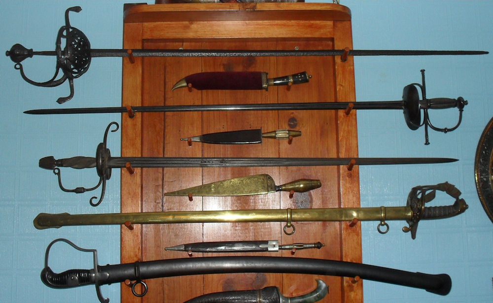

Comparison with other rapiers and swords showing the similarity in length to 19thC sabres

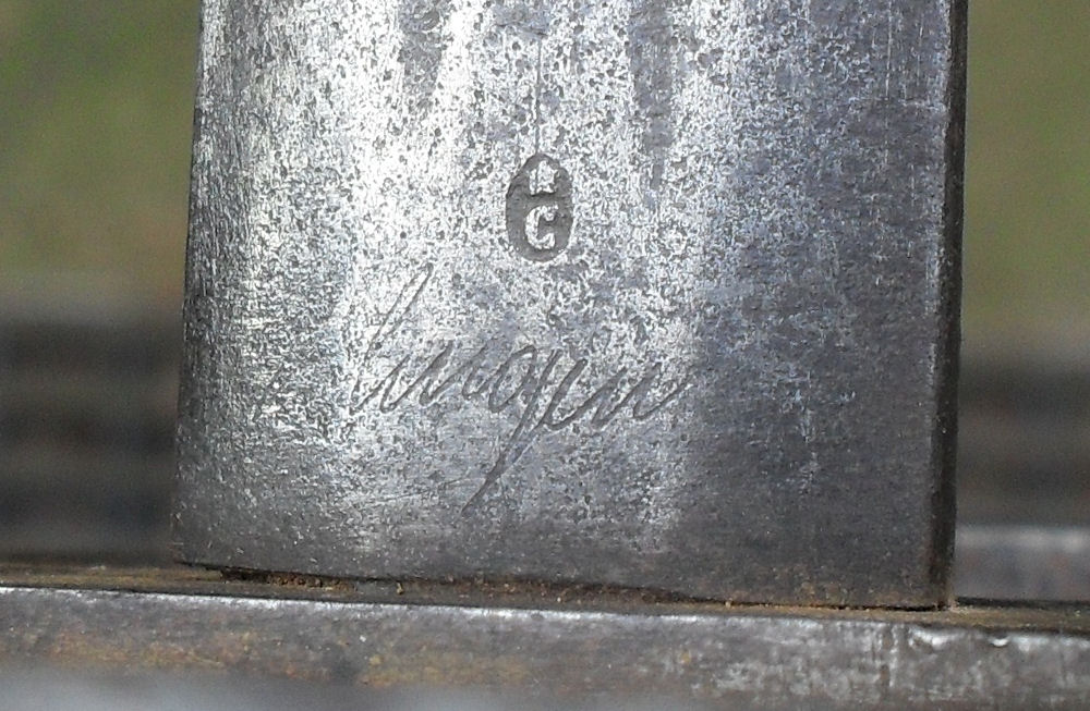

That mark on the blade is so much like that of an inspector "poinçon" at the French Manufacture de Klingenthal.
... And the few letters readable on the ricasso could match with the word Klingenthal.
But let's hear what Jim has to say about this sword .

Imho this sword is a fantasy from the Victorian period. Blade is from a French officer's epee from around 1830 onward, and is marked Klingenthal, with inspector's poincon. The hilt is more subjective to ascertain, but to me it looks grotesque, and doesn't reflect the period it's supposed to emulate.
Just my $.02

Posts: 4,310
Well done, Gene,
A homogeneous 19th c. collection.
Michael

Case in point, well done Fernando on the Klingenthal attribution and that poincon!!! I have no resources on French swords here as most my emphasis is on Solingen, and the Solingen in script fell in place with spurious marks which they of course were known to use. In researching most efforts were to try to locate element styles which are incorporated into this hilt, which as noted are grouped from various classic pieces. What I found were mostly 16th century, and of course the north and low countries cavalry walloons type pierced disc shellguards, of the same effect in degree seen in many pappenheimer forms (though these are angled vertically in more developed hilts).
The blade, now seen as pointed out being French officers sword sets the period as noted, but the Solingen script curious. I think Michael's attribution is accurate for Victorian piece using earlier or period French blade (the Victorian era began 1837).

... I have no resources on French swords here ...
HERE is the Klingenthal website, already open on the "poinçons" page, with an option for either military or civilian markings.
A pity (for some) that, although this site has a three languages option, the marks section is only in french.

Originally Posted by Dmitry
Very nice Dmitry!
Not as 'beautiful' as mine of course, but not too shabby
What's the balance like? Interesting similarities to mine. Is the tang 'peened' or does the pommel screw-on? I find that this reinforces my view that these might be more than decorative!
Do you still have it? Where is the point of balance, can we have some stats please?
Thanks for sharing
Gene
