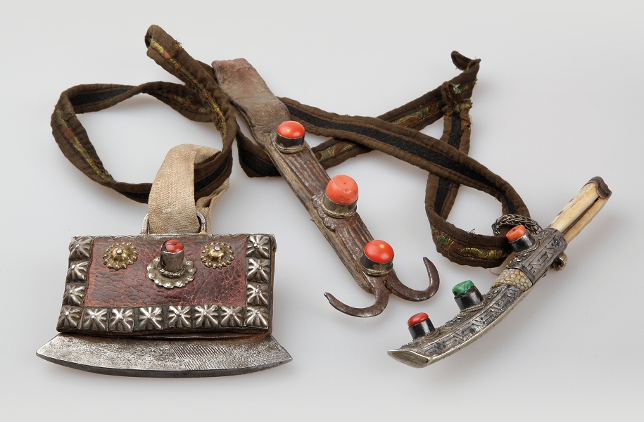

- Small knife in silver sheath with double hook for small animals and tinderbox was described as from Mongolia (I thought it should be Tibet).

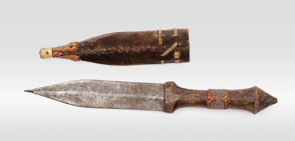

- Small dagger with ray skin was attributed to Chad (ray skin in Chad).

There is a species of freshwater ray in the Benue river... Style of the knife is close enough to fit this area.
http://en.wikipedia.org/wiki/Niger_stingray
I'm having trouble finding if any freshwater rays exist in Lake Chad. But there are certainly rivers with them around in the right area for this knife.

Decorations on the first item and the shape of the knife definetely point at Tibet

Thanks so much Iain, had no idea these were in these regions. Naturally with rayskin I think of oriental weapon grips and in some cases those on Eastern European sabres' grips. Of course they were used on British officers grips, but do we know of any other Saharan weapons with this material?
I think of crocodile first or the monitor, but havent seen rayskin.
All best,
Old 15th November 2011, 08:34 PM   #6
Iain
Iain's Avatar
Join Date: Mar 2010
Location: Olomouc
Posts: 1,720
Hi Jim,
I don't blame you for thinking of eastern swords.
I can't recall a Sahel weapon I've seen before with rayskin. However from the wikipedia article it appears the Niger stingray is fished heavily and eaten. So I imagine an ample supply of skin was/is available.
The two types of stingray found in fresh water in Africa are both in Western Africa, nothing in Lake Chad.
Unfortunately besides the wikipedia articles I could turn up almost nothing on Google and absolutely nothing weapon related.
An anomaly perhaps, but the resource to get the ray skin certainly seems to be in place. Interestingly the Wikipedia article notes that the Hausa know it as the 'water scorpion'. I wonder if any tribes in the area associated animistic or totemic values to the ray?
Great stuff Iain! Now theres a question for us . Knowing the totemism characteristically applied toward various creatures symbolically, could these be somehow represented ?
We do know the catfish occurs in stylized symbolism in Sudanese and I think Egyptian areas.
That central dagger seems West African, yes? I suppose Chad could be possible as eastern reach.

As far as middle knife/dagger is concerned:
Acc to "African Arms and Armour" by Christopher Spring, ray skin was used as material for scabbards of Asante (Ghana) important sword Afena - so material known at least in the part of the wider region. But does the shape of the knife correspond with the types used in Chad ? I think it is very difficult to allocate this small dagger to some tribe (?)
Martin
Old 15th November 2011, 10:21 PM   #10
Posts: 10,872
Excellent Martin !!! Thank you for finding that reference. You're right, it will be hard to place distinct attribution, but most likely collective regional scope where the type most prevalent.
Old 15th November 2011, 10:25 PM   #11
Iain
Iain's Avatar
Join Date: Mar 2010
Location: Olomouc
Posts: 1,720
This basic style of dagger is found in a lot of tribes. I think it would be somewhat impossible to pin it down exactly.
Great to hear of another rayskin reference in West Africa! I for one, am learning a lot today, never even thought about the material in connection with Africa.

First one is definitely Tibet. Looks like a woman's belt, probably from the northeast. In addition to the utility knife and the mechag (pouch holding flint and tinder and with a steel striker plate) it has a milk pail hook. The (likely imitation) coral and other decoration is solidly Tibetan. The curved knife sheath and its metal work are also characteristic.
