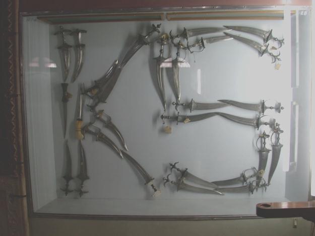

Maybe it doesn't matter! The photo of the display case shows both types of Chillanums from the Plunder of Adonis, that Jim mentioned recently. Both, Pant and Elgood identified the first two types. I'm unable to find what, or if, the straight bladed version has a separate name. Thanks , Steve

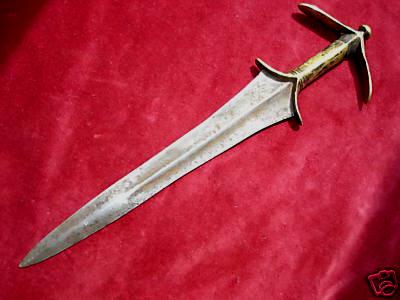

The example shown with straight blade and splayed pommel with the red background appears to be the form of dagger typically associated with the Kafirs of what is now Nuristan and of the Kalash people of Chitral. These are termed 'katara' and interestingly parallel the straight blade 'punch dagger' well known as the katar which of course have transverse grip. The straight blade and term are where similarity ends.
