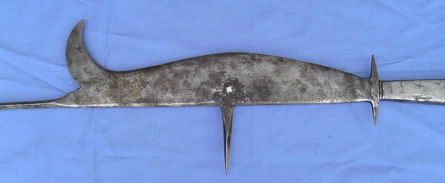

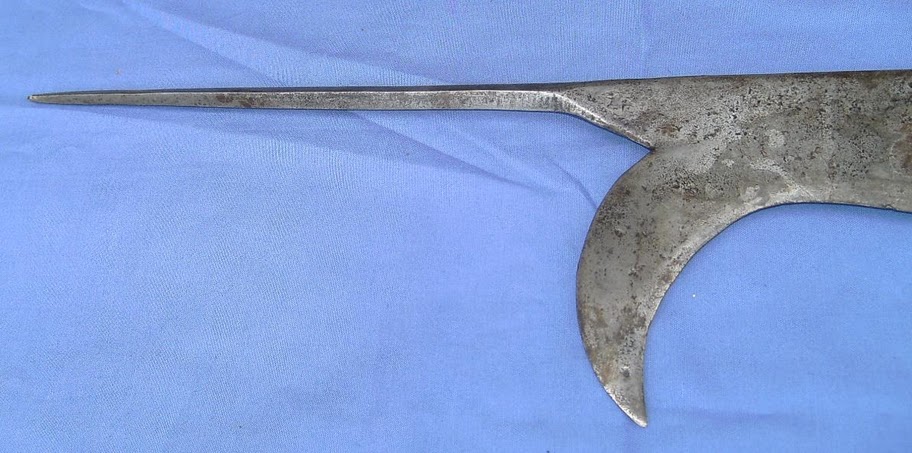

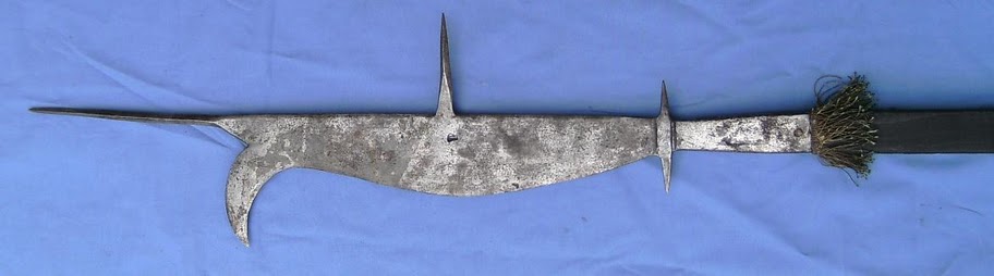

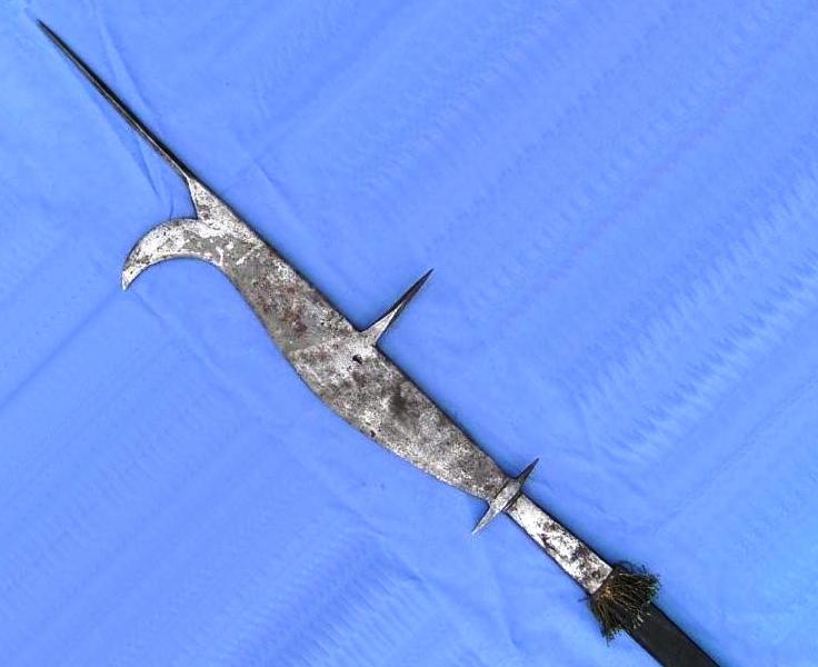

It is called Roncone in its Country of origin (Italy); the English would call it Bill, but i rather call it Bisarma, the name we use over here.
It would in principle be an example from the XVI century. The 'sickle' front part is sharpened and all pointy ends, spike, beak and parrying bar, are rather reinforced.
It measures 97 cms + 37 cms for the langets. Weight 2,3 kg.
Would anyone care to give me some comments on this piece?

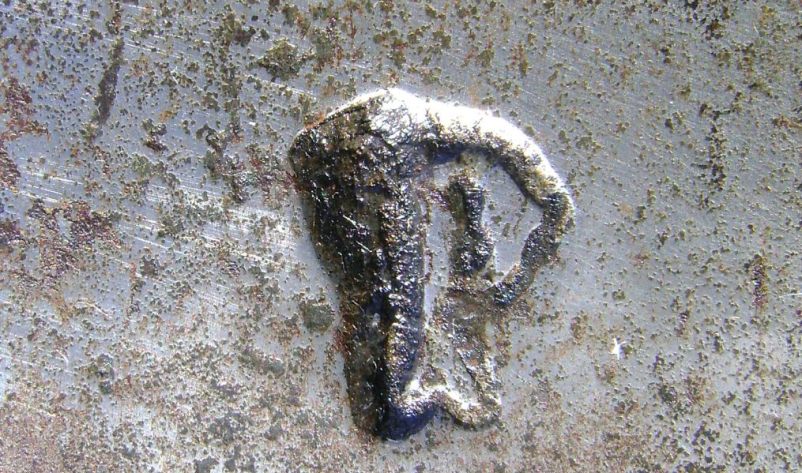

... or if anyone recognizes the maker's mark?
Thanks

Hi 'Nando,
Congrats on this Runka (the German word for it)!
I would date it to the early 16th c. The Gothic majuscule P mark is well known from various late 15th to early 16th c. weapons, mostly iron haquebut barrels. Some identify it as the workshop mark of Peter Pögl in Thörl, who worked for the Emperor Maximilian's army. Your wrought iron cannon ball comes most probably from that workshop. However, I believe there were other smiths as well who used that mark.
And: being foremost a man of earliest fireams, I do not own Armi bianche Italiane but other books on firearms by Boccia, as well as other great books on Italian arms of all kinds. I will do some research on roncones.

I think that has to be the most 'unfriendly' looking polearm I've seen!

I was glad to see Michael in on this and on the majescule 'P' which as he has noted was used quite widely. The crowned P was used in Spain and apparantly by a number of makers, as Sir James Mann (1962, "The Wallace Collection" p.345) notes, as the name Pedro was fairly common. Solingen swordsmiths, in thier well known application of spurious Spanish marks used this poincon considerably along with others.
The Gothic 'P' is seen without cartouche on the forte of a katzbalger c.1500-10.
I did check Boccia & Coelho and the exact match to this bill/ bisarma/roncone polearm is found in the silhouette plate of typology (tavola B, #8) which does mot specify term or date range. It does seem similar variants in Italy range c.1540-1610 with most variation in the vertical spike (dente) on the back mid-blade....some with a lunette style feature instead. Similar examples are in the Wallace Collection in London (A929, A930) listed as 'bills', both Italian one 16th c. the other c.1540.
The majescule P with crown is found in Gyngell (p.74) as Italian, 16th c.
It seems most of these are from North Italy, Venice especially, and more decorative used in ceremonial guard type weapons.
The P without cartouche might be from the Pogl workshop as Michael mentioned as the period is right.

Thank you guys for your input on my 'unfriendly' looking specimen. I was glad to read your considerations woven around the gothic P mark. Hmmm, i love marks.
Billman, i appreciate your dissertation on the etymology of the billhook, as also your assumption that this term only appeared around the XIX century. I also notice that, in your attached paper, the 'multilanguage' charts in which you determine the translation of parts names do not contemplate portuguese.

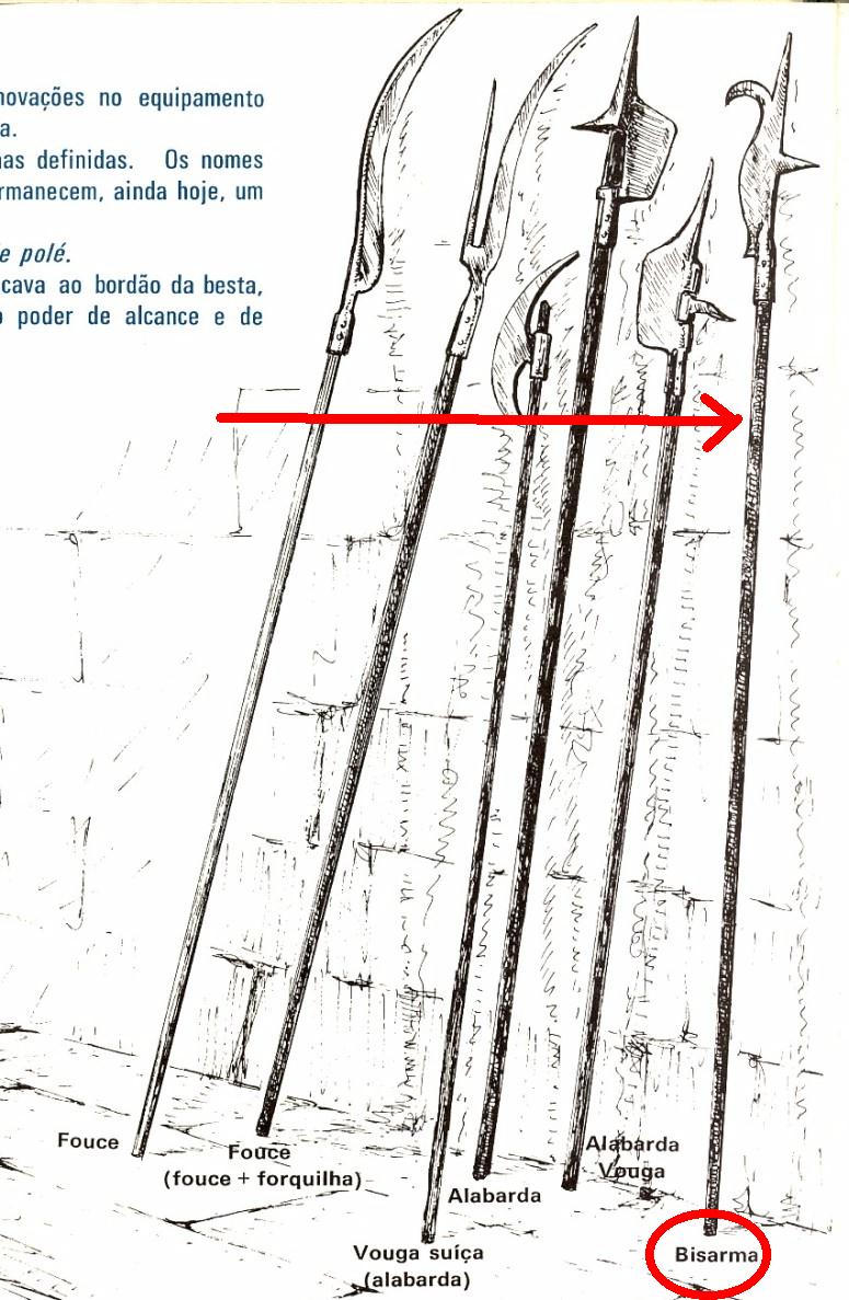

But i guess i rather stick to the etymology of a much earlier nomenclature, that of Bisarma, a Portuguese name adopted from the French Guisarme (Old French Gisarme) attributed to a fusion of tool and pole weapon in use as from the XI century,
Naturaly a sturdy Bisarma used in the XVI century, like this one, although not denying its tool origins, certainly holds definite weapon features, as visibly having lost its abilities to prune tree branches or cleaning bushes.
