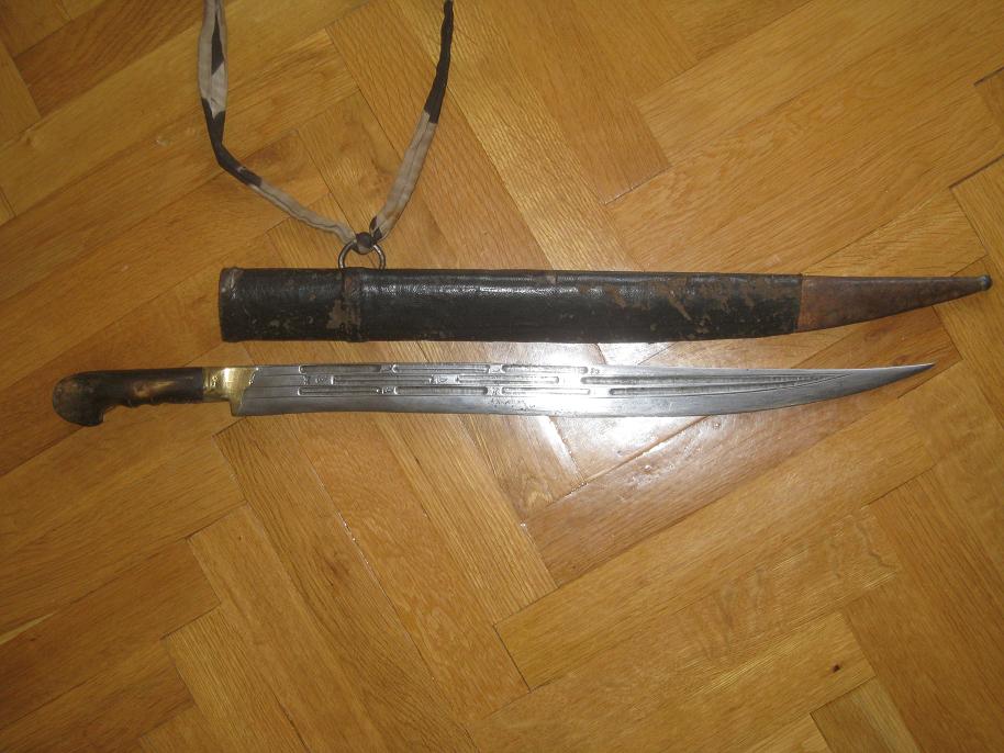

This Turkish dagger pulls small metals. These inkpen tips must be brass. it pulls some other small metal pieces too. I have bought it months ago and now it still has the same magnetic power. What does it mean on a blade?
Meanwhile can anybody translate what writes in the maker's stamp?

I don't think that brass is magnetic so these tips must have some steel in them. Blades are very easy to magnetize and usually hold the charge quite well. It can easily happen accidentally as well. So i don't think it means anything in particular. I always check all the blades i get for magnetic fields. If they don't respond to my compass i generally magnetize them myself. Don't ask me why or i'll have to kill you.

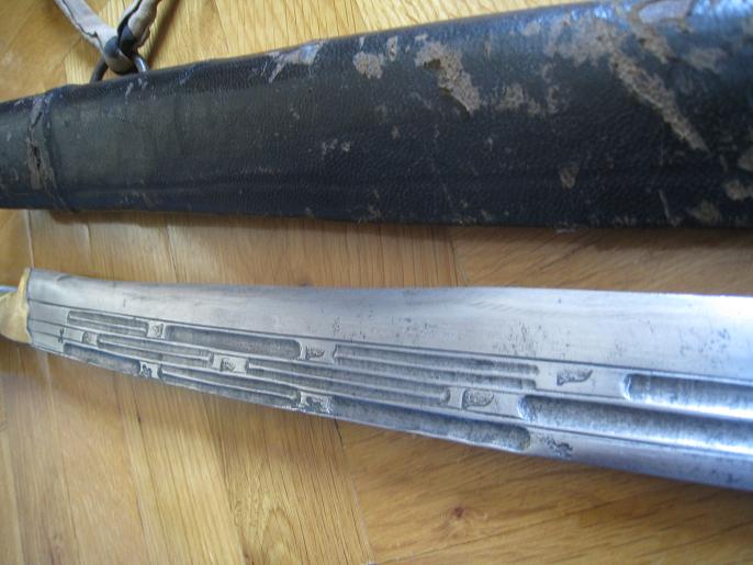

The interesting pattern in the deep channelling in the blade reminds me of these patterns on blades of early Italian sabres, and similar channeling I believe is present in lesser degree on Qamas from the Ottoman sphere.
