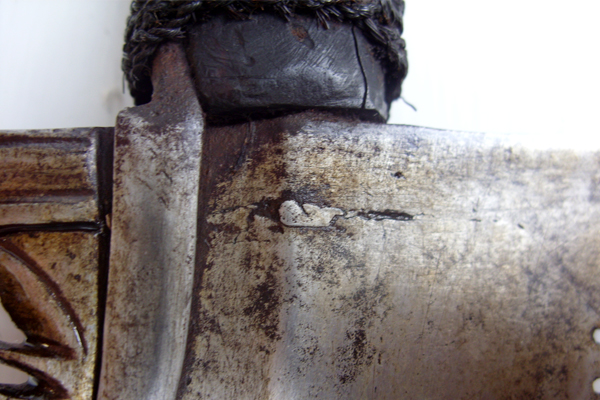

Default Image of the gangya area!
Originally Posted by Rick
Could we please see the blade, Maurice ?
Rick, here an image of the gangya part. Unfortunately this is the only image of the blade I have available at the moment.
If the two strings were made taut, then wrapped tightly with rattan right over the joint and up onto the crosspiece; the pressure would draw the two pieces firmly together; IMO .
Almost like Baca baca .
It is not as tightly wrapped as it might look.
It is probably done latter, a long time after the actual crosspiece broke off considering the patina (it might be restored like it was the first time?)
If the restoration is moro or not, I have no idea..

Attaching pics of the blade...

Default close up of the fiber cord.
Originally Posted by kai
I'm wondering why this patinated differently than the hurried rattan binding just below (which should be of the same age).
Kai, I made a quick close-up also of a part of the fiber cord that are attached to the crosspiece and the ratan binding, cause on the other images this is hard to see.
Old 18th July 2010, 01:21 AM   #18
Hello Maurice,
Thanks, I think we can toss this out as a non-traditional approach (Moro or otherwise): Too weak to be of any value in a humid climate...
Same-o with the iron nails.
