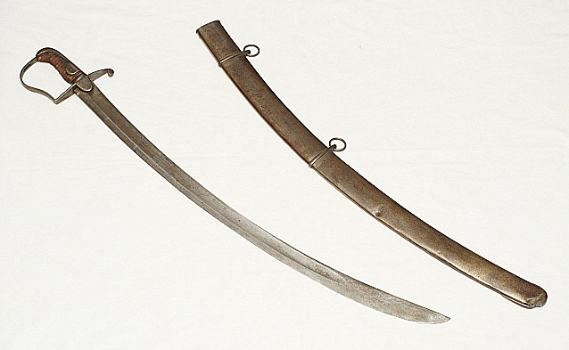

Dear friends! I want to ask your opinion on a sword of 1796.
1. Me the detailed information on brand HARVEY interests.
2. On a sheath date 1810, what it means? Figures 222 (number of a sheath)? And a star? Respect, Alexander.

Could the makers name read 'HADLEY'? It doesn't look like 'HARVEY' to me.
Edit: Thomas Hadley & Sons of Birmingham would seem to have the right date range, but I'm not familiar with how their swords were marked so can't say for sure if this is one.
Lovely sword BTW.
Edit 2: Just having a 'bing' and came up with this from a thread over at SFI about a 1796 LC made by HADLEY:
"Mr De Witt Bailey has written a very interesting book “British Board of Ordnance Small Arms Contractors 1689-1840”. It is based on the BO Bill Book or treasurer’s ledger.
Thomas Hadley from Birmingham was recorded as barrels, locks, bayonets, swords and rammers provider with dates: June 1776 – August 1781; May 1804 – March 1818; October – November 1823 and final date of appearance on March 1828."
Best
Gene

Spine stamp picture of the aforementioned HADLEY 1796LC:

Spine marking on a British 1804 cutlass:

Here is a digital reconstruction of the spine markings on your sword as HADLEY:
