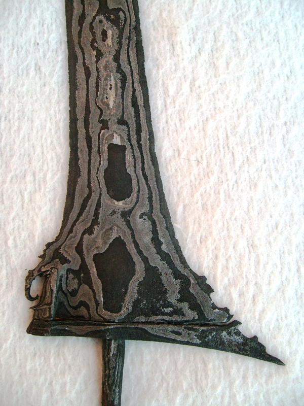

I did clean 2 blade,s this morning , but i need some help with the dapur and
the origin .
One blade is in my opinion from Palembang and has the dapur Sinom Robyong
and has some age. diffrent opinions are welcome
The other blade....i have no idea about the origin , could it be Palembang too or is it javanese ?
Dapur no idea.
With this blade i also have the feelling that it,s not realy old , i hope i.m wrong..

Something tells me your first example might be an old Madurese blade. I will leave dhapur distictions to others. Why do you believe this one to be Palembang. Did it come to you dressed as such?

have the same feeling like David since this pamor is typical for madurese blades and the dapur have also something madurese. For comparison this Madura keris with a very similar pamor.

Hi David and Detlef,
yes the blade could be madura if you look at the pamor , but what made me ques palembang is the dapur .
its just a wild ques but when i look to palembang keris in books or on the net i did see this dapur quite often .
the 2 blade,s came without clothe,s , i did clean them to see if the are ''worth'' it to me to find a fitting wranka.
no idea about the second blade ?

Actually Danny, it is as much the dhapur as the pamor that put me in mind of Madura, especially the long and slender look of the sekar kacang. This is a feature i have seen time and again in old Madura keris.
I see nothing that speaks specifically to Palembang here, though it should be kept in mind that both Palembang and Madura keris took there lead from the kratons of Jawa.

Ok, i,m convinced madura it is
But David you refering to old madura blade,s , do you have a opinion
about the age ?
