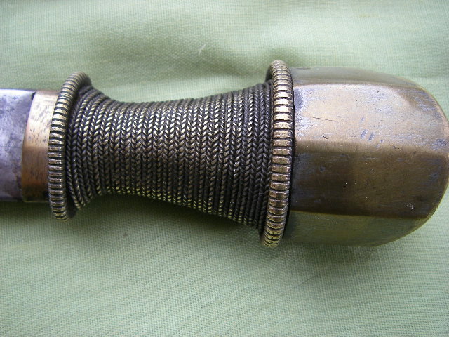

Hi all, I have just recently purchased a dagger from a dealer; stated to be Tibetan from the 1800's. Will you experts out there venture an opinion on this attribution?
Many thanks for your patient assistance.
Brian

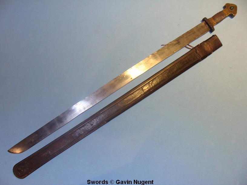

the octagonal wire wound grip appears bhutanese in influence, tho designs travelled in that area & blur near the borders. could have been made in tibet, but in the 'bhutanese' style. the scabbard fitting is more similar to the one on my tibetan dagger than the dossum, the tibetan one has a ring thru the hole and a leather belt loop on the ring.
bhutanese dossum:

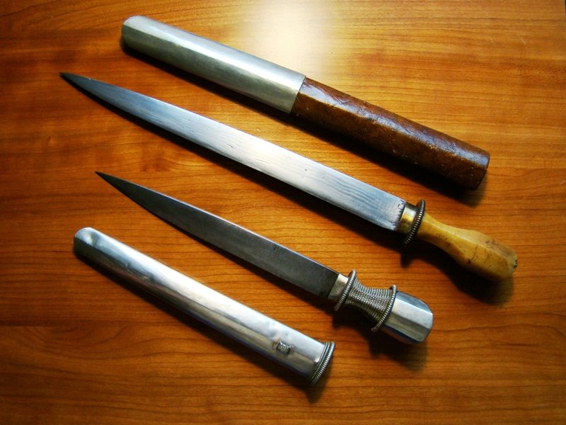

my short one:
rear view
someone else's sword-length one.
tibetan one for comparison, also not mine
tibetan dagger, mine this time
note the two toned horn grip & hairpin laminations in the blade. suspension fitting is a bit hard to see, so here's a blowup in the following post

I suspect later, early 20th century. The pommel appears to be plated brass in the image? Not low grade silver as I would expect on an older one. The blade could be older though and there is nice overall wear consistant with age and use.
These were still being made in the 50s in Yunnan for export to western centres and I am sure they are still being made today.
It has some good age though.

I agree with Gav early 20th century. The blade does not seem to exhibit any lamination and the hilt does not seem to be silver but plated silver. Still a nice old example maybe from the 1920-30s?

Here are two that were from my collection I still have the big one though. The smaller one was circa 1930-40 the bigger one is 19th century it has a yak horn hilt and straight pin style laminated blade.

Many thanks to those who have contributed. I am astonished at how much you guys know and embarrassed at how little I know. The pommel of mine shows some wear, revealing a thin coating of brass colouring, with traces of a lighter metal below.
