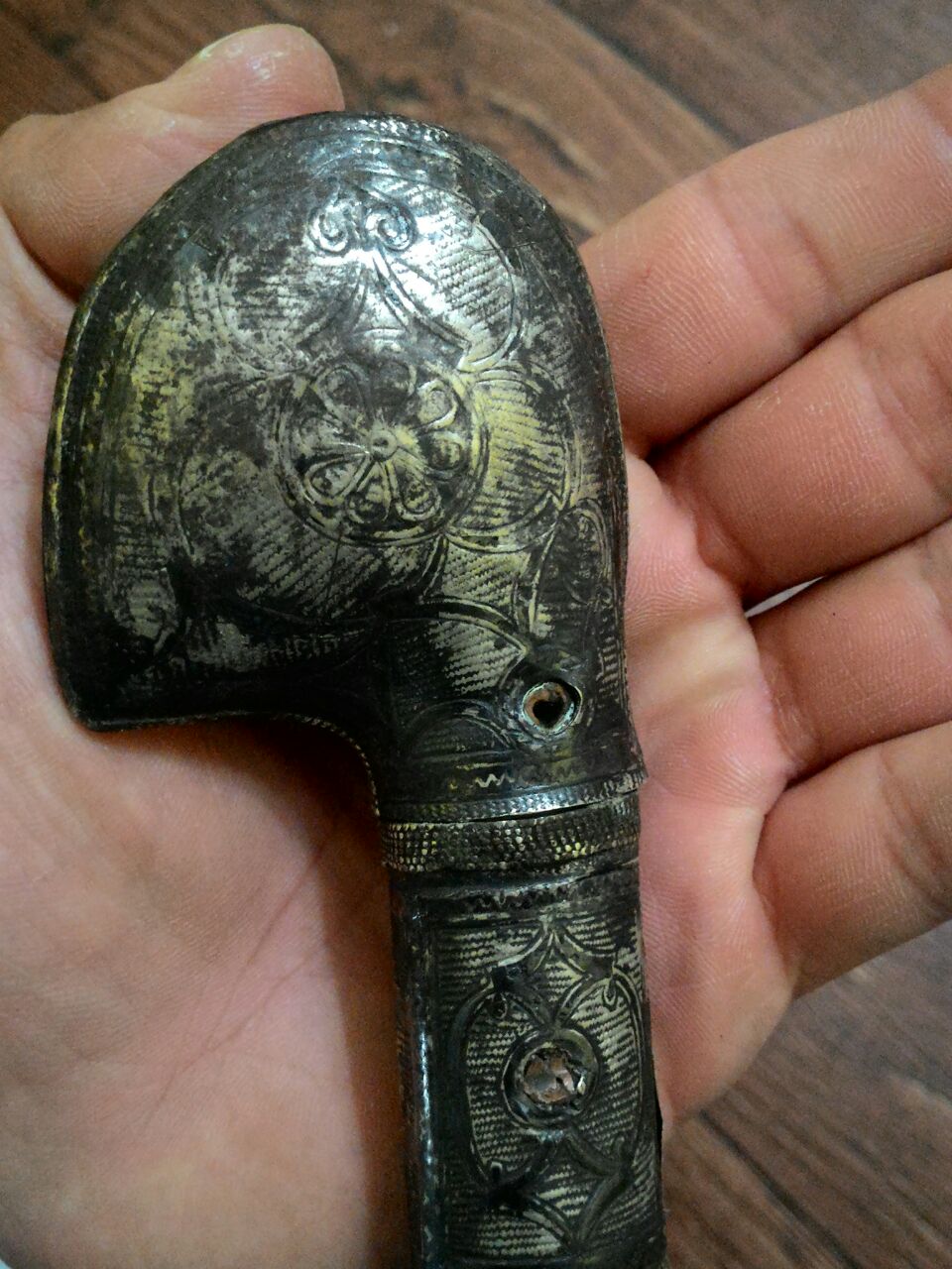

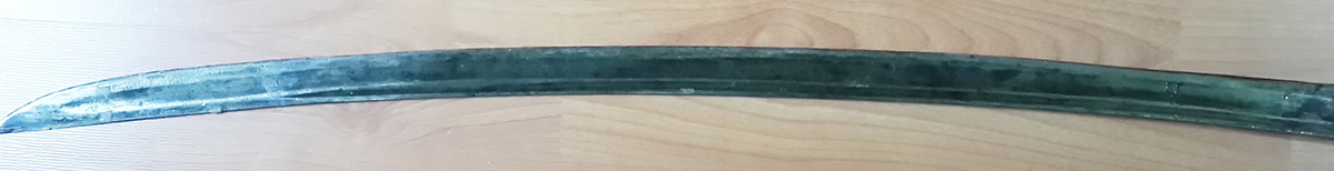

Hi all. I am a fan of this forum for years, as a member recently, and this is my first thread. I have two shahkas, here I would like to share. By the way, I am no collector or seller, but just a Circassian with two shashkas and two kindjals only

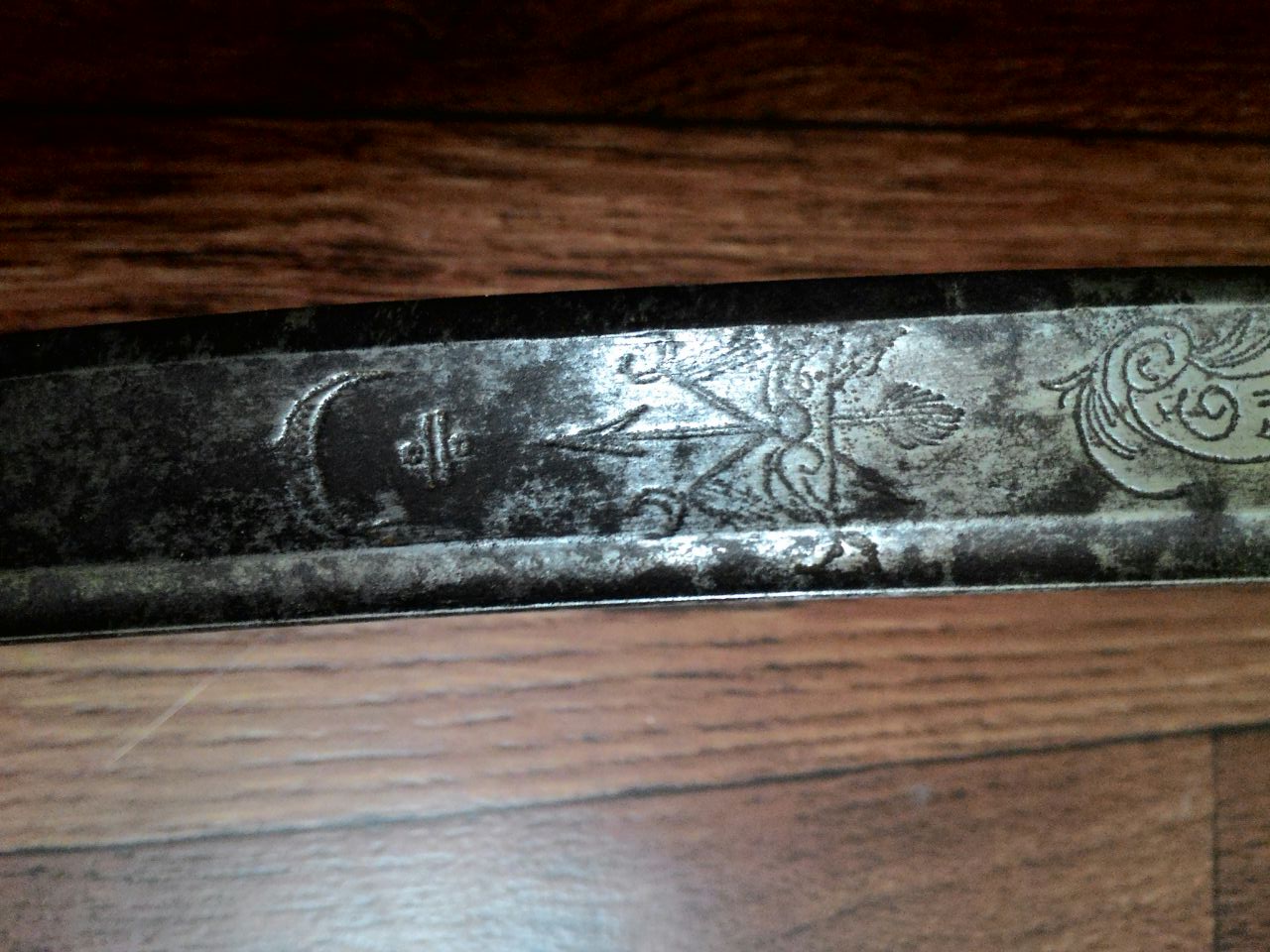

For the first one, what I can say, is a European blade mounted in Circassian(?) style. The blade is probably Solingen, a Hussar(?) blade, somehow appeared in the Caucasus. However, I cannot say more, as you will see, there are series of motives I could not figure out, including the thread http://www.vikingsword.com/vb/showth...t=early+makers
The hilt is being repaired now, and the scabbard was repaired a few times, but not recently. What I am curious about is the origin and the date of the blade. Is there anyone who can help me with this? I would really appreciate any comments, for I could not find any details by myself.
The second is a modest one, with a double horse-shoe like mark.
Thanks for any of your contributions.

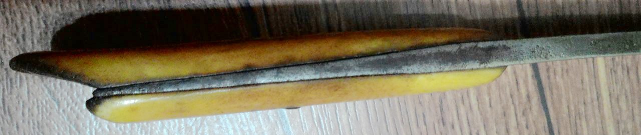

This is an other figure I forgot to attach in the previous post. May be helpful for dating. Thank you very much.

Yes, it is a Circassian style. The blade is indeed European, likely Solingen, 17-18 century. These blades were used and reused, and it may have its second or third furnishings. The blade has either been narrowed to start with to fit the handle, or was sharpened many times. Large parts of the engravings are lost.
I cannot see your second one very well, but it seems from your description that the blade may be marked with gurda: originally Genoese mark that became a world- wide mark of trade blades for the "Orient". Would love to see the details of the handle and the blade. Hopefully, I might even get smarter:-)
I like these old and worn-out ones.

Thank you very much, Ariel. I am going to take better photos, not by a phone and post again. About the second one, I do not think it is Gurda, at least it does not seem to be any of the versions I have seen on the forums do far. I will post better photos, soon. The date in my mind for the European blade is the ends of the 17th century - not knowledge, just feeling
Thank you again.

We are in agreement about the age of the European blade.
