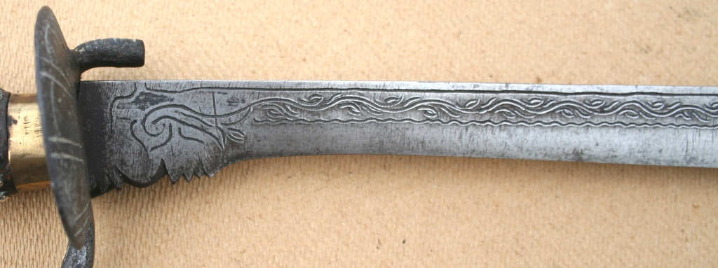

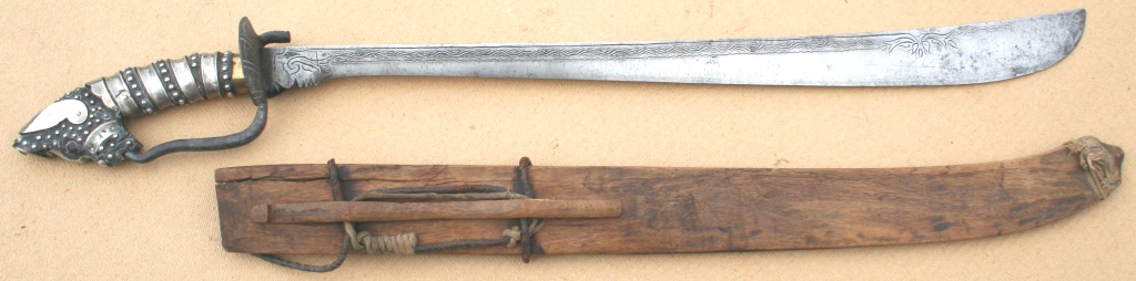

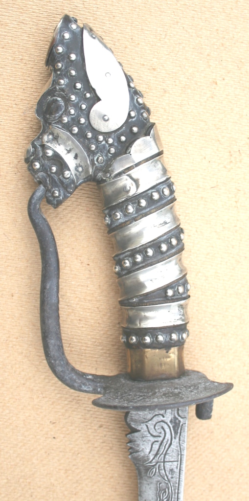

I have been meaning to post this for some time.
I aquired it more than 20 years ago at a Wallis and Wallis auction in Lewis. It was being sold as a Parang Nabur and considering the picture in Stone's it is easy to see why.
Length is 72 cm with a 56 cm blade.
Thickness of the blade near the hilt is 11mm.
The hilt is of some very dark wood or horn covered with silver.
Knucklebow and crossguard are of iron or steel.
The scabbard is all wood.
All comments will be appreciated.
Roy

Hello Roy,
What a Beautifull sword!

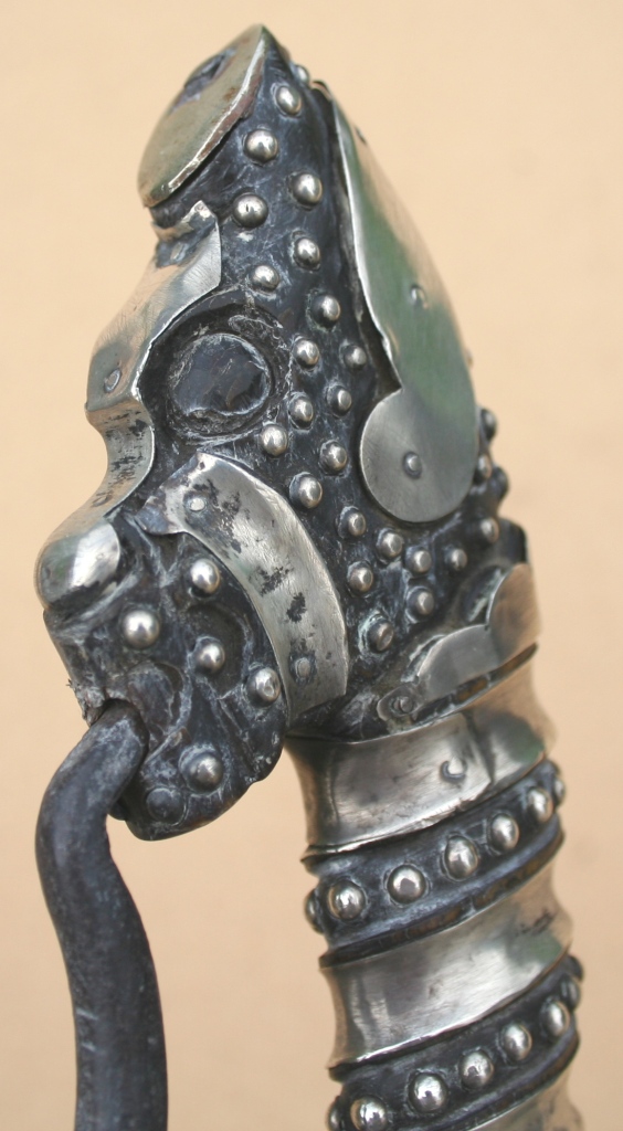

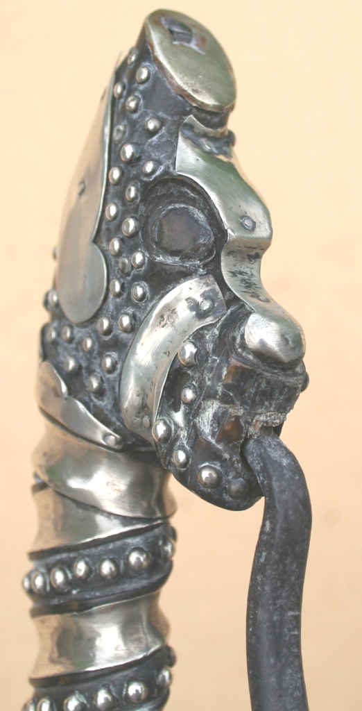

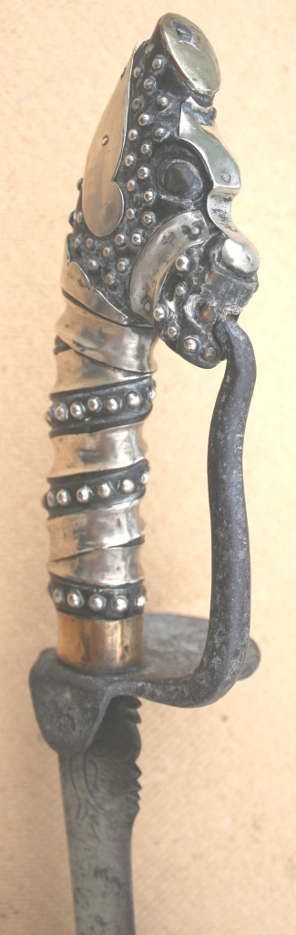

What I can see on your images the handle is made of horn.
is the protrusion at the handguard (at the side of the spine of the blade) broken off, or what could be the function of that little thing? (maybe it could be used as a blade taker/breaker?)
Oh, just for mentioning,.....I like thick blades over 1 cm thick... :-)
Is there any evidence that the brass (?) ferrule near the handguard is not original? I guess this was also one a silver one.
How are the silver dots connected in the horn? Are those silver nails?
Kind Regards,
Maurice

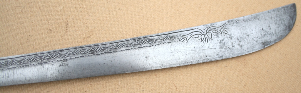

Hi Roy,
nice sword......is it the photo's...I can see patterning in the blade....not certain whether you should etch though (I'll leave that to a more informed formite to advise).

What a great piece! Been looking for one like this. AND you have the scabbard as well! Thanks for posting this - very helpful since these don't seem to be very common.
Also I would etch the blade.

Gentlemen
Thanks for the comments.
Maurice, I think you are correct about the brass ferule being a replacement. I cannot see why brass would have been used originally when all the rest is silver.
The dots appear to be nail heads.

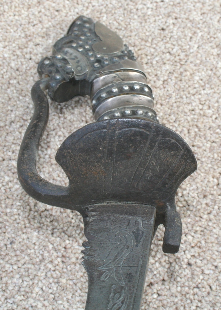

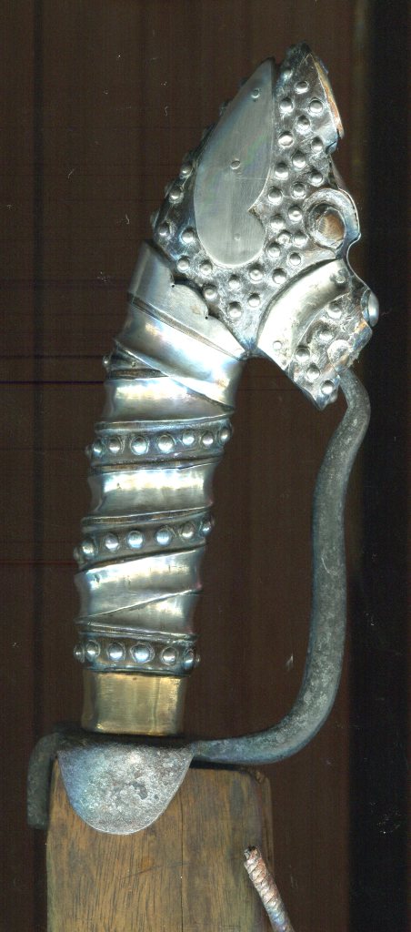

I think that the iron protusion is to help centralize the sword into the scabbard. See the scan, it certainly helps to hold it in place. Whether it had another function - I have no idea.
I have been searching for other photos and came across an old thread by VVV ( Michael ) from 20th Feb 2006 which has been most helpful.
The only reason I called it Batangas was because of the information in the above thread and the brief arcticle from Eric's edge which seemed convincing.
It will be interesting to see the new information about the " Minasbad " if Lorenz will oblige ( Please )
Thanks Roy for your explanations.
I think you could be right about the iron protrusion, now I see the image of the sword in the scabbard.
