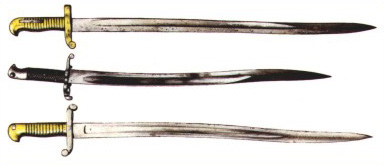

Does anyone have any examples of how ethnographic blades were ever married to firearms, become bayonets sort-a speak. Any regions are welcome, any method of attachment to gun...
Just to start of: There are what they call "yataghan bayonets" (picture below) which are much later, and you cant call them ehtographic I guess, yataghan name prob stuck only cause of the blade profile, or maybe there were earlier versions for example that had real yat blades...
Thank you guys in advance for any info.
Aleksey

...a very interesting subject. There was certainly a fascination with the yataghan in France at the time that the first yataghan bayonets appeared - the art of the time is full of them.
I think that the best online resource is here .
I have always wondered what happened to the thousands of sword bayonets which were captured with Remington rolling-block rifles by Mahdist forces.

In colonial times European armies often had great respect for ethnic and native forces who fought against them with valor, and admired not only thier stamina in battle but the weapons they used. In many cases they adopted thier own examples or versions of these weapons, for example this was the case with the introduction of the mameluke sabre into British, French and even American military officers sabres. In the British Raj there were countless examples of the hybridization of British and Indian edged weapons.
The British Army respected the Nepalese Gurkhas above all, and developed regiments of these fierce warriors into thier ranks. Eventually the tribally distinct 'kukri' became produced by British manufacturers as regulation weapons, and of course the bayonets as well as mentioned.
In this same sense, the French much admired the Berber warriors in Algeria and in 1831 created special units of Zouaoua Berbers of the Jurjura regions in Kabylia for infantry. By 1842, the use of sword type bayonets and the type with yataghan (for its similarity to the recurved blade on the Ottoman sword by that name) came into use. In the M1866 Chassepot rifle, the same style 'yataghan' blade was used. While the blade style reflected again, the Ottoman style weapon, and the uniforms were of the 'exotic oriental' fashion, the use of these yataghan bayonets was universally applied. These units, which became known as 'Zouaves' were brought into American military in Union forces during the Civil War, and similarily fashioned units were used by the Polish/Lithuanian forces against Russia in the 1880s.
Although not ethnographic weapons per se, these regulation bayonets do reflect ethnographic origins, and via that association certainly show an interesting perspective. Despite the obvious disparity often reflected in contemporary narratives concerning these conflicts, there was indeed a deep respect and admiration for the native warriors the colonial forces faced.
I cannot think of examples beyond the kukri and yataghan forms, but it would be interesting to see others.
