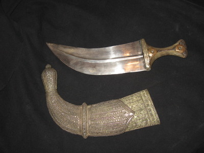

I have this yemen dagger, and am looking for some info, on the authenticity, of Rhino handle. Comes with All silver sheath. Any help appreciated. Pic below. If the pic doesn't show could someone please tell me how to post them...it says pic is attached but when I preveiwed I didn't see it.

Hello J. Welcome. It would be nice to see some close ups...and maybe a different background & a little bright lighting..natural is best....but nice looking piece from the photo Not my area...but some of the other guys will surely chime in soon

That is a standard Yemen jambiya with a nicer scabbard you have. I am pretty sure the hilt is not rhino but a close up of the hilt would help to make a positive ID.

very nice yemeni "Dharia" dagger
- type; "Badihi"
- hilt style; "Sayfani"
- area; Sanaa - Yemen
- age; "contempory"
(sources ; "Weapons of the Islamic World" (Swords & Armour)
about the "rhino" handle ... picture not enough acute to give an opinion
à +
Dom

I'd like to give my opinion on this jambiya and a slight correction to the descriptions offered above. It is definitely from Yemen.
I understand the reference to the " dharia" dagger in " Weapons of the Islamic World". However I think what J has is a "thouma". The "dharia" is actually called locally a "joulba" which has less curvature, is slightly larger with a more bulbous end than the Thouma. The Thouma and joulba were worn by a different class of person in the old social structure.
Without a better picture it is difficult to know if the hilt is rhino horn or not. The term " saifani" relates back to a Yemeni family who made jambiya daggers using a particular quality and colour of rhino horn. I would just call the dagger " Sana'a style" as the term " saifani" definitely relates to rhino horn.
The silver work looks Badihi ( jewish family) in style, although i'm not sure about the locket as the picture is poor. Hope this helps.
Steve

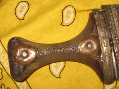

Steve/Dom
Would these be considered Joulba or Badihi? Btw the top one is rhino.
