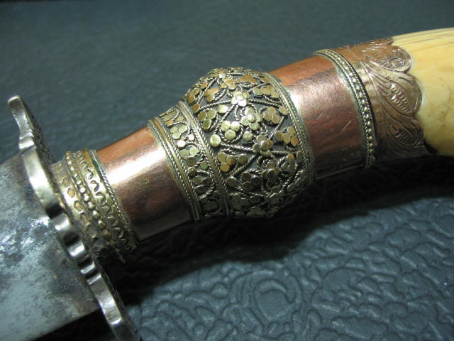

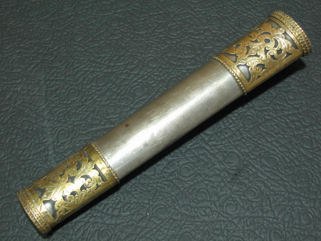

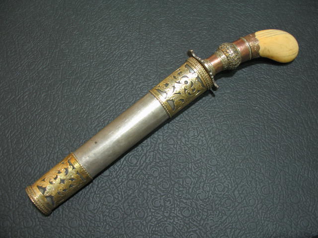

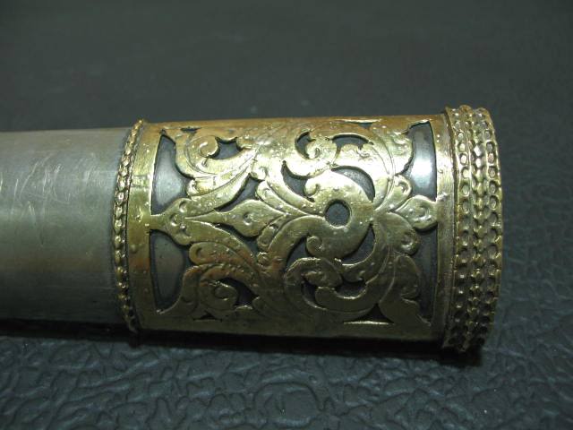

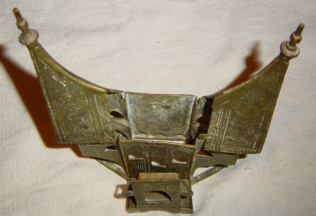

Hi I have a dagger here, I was wondering why the metal bands on the scabbard had bubbled? And is the metal band on the hilt a swaasa band? Thanks.

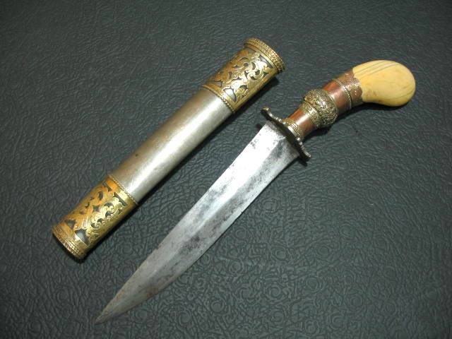

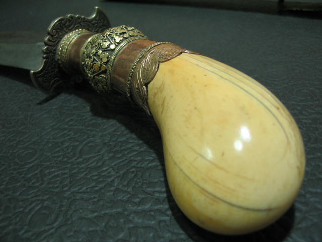

Nice gunong Philkid. It looks to me to have genuine age, late 19th-early 20thC. The metal work is nice. The only reason i can think for the bubbling on the sheath metal is that perhaps the gold color is not the main metal itself, but some kind of finish or plate. The copperish metal on the hilt could swaasa, but it could also just be copper. The other metal looks like brass to me since it appears slightly tarnished which gold would not do. Nice ivory.

Re the bubbling on the scabbard fixtures . If this decoration is constructed as Battara described so well in post #19 of Ceremonial Kris :
" Gold plating - not real plating, but as Cato uses the word. Here is why I hesitate to call it plating. Plating is a 20c invention that places a thin gold film of only a few microns on a surface (thus plating is going out of style in many jewelry stores here in the US). The layers of precious metals Moros used were an actual layer (32 gauge) of material fused to a base metal like brass or copper (more commonly). This is what Cato is really refering to in his book, though I take issue with the term he uses. Again, this was mainly used by the Maguindanao and Maranao. I have actually measured this in the Maranao and Maguindanao pieces I have. The technology is not that difficult because it took only a furnace (or bellows) to heat up the materials together to a point where they would start to fuse before melting. However, this would take precise control and experience. This technique is still used today around the world. "Gold filled" is the closest commercial equivelant in that a thin layer of gold is fused to a base metal of brass. The brass is thicker than the gold, but the gold is much thicker than a film a few microns thin, and that is why it wears much better. The Moro/Indonesian/Malay fusing of precious metal is thicker still, and is more economical than solid thin bands of pure metal. My kris that I posted has the swaasa bands of 32-30 gauge bonded (fused) to a thicker base of copper. "
The bubbling may be a result of either poor bonding or degradation of the base metal .
Anyway it seems like a very nice older example of gunong .
Falcon I'm pretty sure you were joking with the offer to buy ; if you are really interested in obtaining an example of this weapon they appear fairly frequently on ebay although few examples as nice as this one show up .
Another thing ; if you do end up purchasing one with an ivory pommel you would do well to buy the item in the USA as you may encounter importation problems from other countries ivory being a protected material under the CITES agreement .
Old 2nd September 2005, 06:53 PM   #5
Posts: 6,032
The reason the metal has 'bubbles' is because the brass parts on the scabbard have been cast as one piece and then finnished ,pierced and ingraved. The original pattern was made in unrefined bees wax which can be get skumy as you work it, from ambient heat or from your hands. The bubbles are where very ,very small balls of wax are stuck to the surface of the pattern and thus appear in the final casting which odviously went well as it looks like the maker just polished it straight from the cast. Tim . I could also be very wrong. If they are gold plated? fire gilding has gone on for centuries. Judging by the guality of this piece it was made at the center!!!not in the back woods.

I am having another hard look and I am sure the piece at the top of the scabbard has been cast from a wax pattern as you can see that the top rings have been formed by a tool making indentations into a soft substance. Tim
Old 2nd September 2005, 07:52 PM   #7
Posts: 6,441
Question
You've got a point there Tim .
Wouldn't thin sheet such as the main cut out area be the very devil to cast in lost wax though ?
Especially with comparatively crude equipment ?
You'd need to have sprues everywhere , no ?
Old 2nd September 2005, 08:00 PM   #8
Posts: 6,032
Hi Rick.
On small pieces like this, I would not under estimate the skills of the casters. Casting a small thin sheet in a suitable alloy is not that difficult. As I said this looks like it was made where they knew how. Tim
Old 2nd September 2005, 08:16 PM   #9
Posts: 6,032

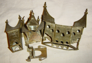

This is a lot bigger than the scabbards decorative pieces. A cast temple complex from a wax sheet original. Tim
Old 2nd September 2005, 08:28 PM   #10
Posts: 6,441
Fascinating !
I see your point ; now my only question would be why leave the finished piece so lumpy ?
I guess only the artisan could answer that one .
Old 2nd September 2005, 08:34 PM   #11
Posts: 6,032
Yes to our straight line thinking minds you would want to file the bubbles off. There is some magic in casting and the makers may have seen a good and successful cast as a sort of pure thing. Without having a chat with them it is a little difficult to know. Tim

This cast armlet from Africa illustrates the skuming of the bees wax pattern rather well as the lumps are a little larger and some look as if they were part smoothed before casting. Tim

There is one other possibility and that is when the thin layer of gold was applied (assuming it is gold), heating process to fuse or join the metals together may not have been well watched and the gold may have gotten too hot and bubbled that way on the surface of the base metal.
