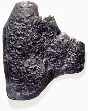

examples are indeed very difficult to find but found this..........
Defense for the right upper arm, second half of 14th century
Leather
Inv.No. MLA 56,7-1,1665
The British Museum, London
This arm defense was probably found in London and is the only extant example of its kind. It is made of leather, which was presumably hardened by boiling it in wax or oil. It would have been strapped around the biceps on top of a mail shirt or protective undergarment to which it would have been laced at the top. It is decorated in cut and stamped relief with foliage and grotesque beasts.

Nice work David! I knew there had to be something out there, but this is great, a really early example, and thanks for noting the resource. It truly is amazing how little there is on this well established type of body armor.
This piece looks remarkably well preserved with great detail still discernible.
