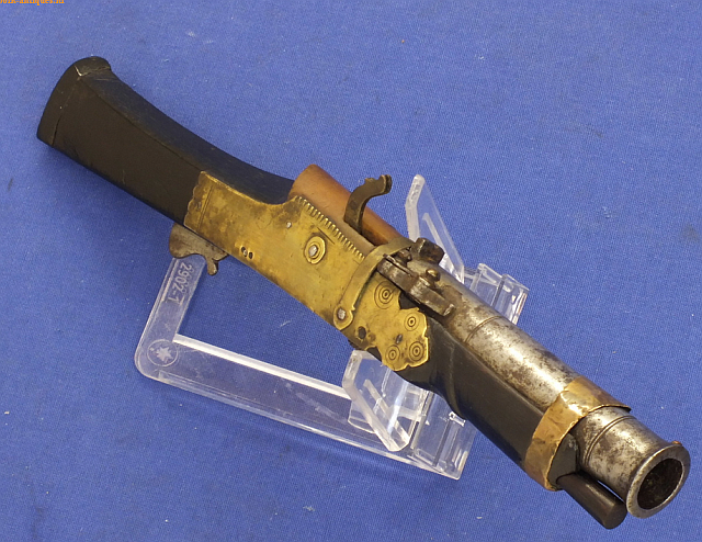

I am trying to get some help identifying what part of the world this small matchlock may have come from. The owner says it is about 24cm long but has no clue as to were it may have been made. To me it has the look of some matchlock rifles from India that I have seen, any thoughts?

It is in the Indo-Persian "Torador" style. Have never seen one this small before. Very cool!

Yup it's an Indian Torador of usual form, just really really small.

I wouldn't call it a pistol because it has a stock not a grip. I'd liken it to the coach guns and the like.
I've had a small 'carbine' Torador before and I've seen very 'slightly' proportioned small ones described as for children.

Well I have given up trying to find anything like this, I cant believe it is the only one in the world, there must be others in collections etc. Since it is so rare I got some additional images and the exact measurements, it is supposedly 17th century but I am not sure how this is determined, length 25cm/9.8in, caliber 14 mm/0.55 in.

Sorry for the impertinence, estcrh
Have you thoroughly checked both backsight and priming pan fixation... and the breech plug area ?
Are you sure the barrel was not cut down ?
Sure this is a 'customized' gun. The point is : is it a modified toradar or was it born like that ?

SALAAMS ALL~ Nice looking weapon. A lot of long barrels blew at the first weld caused by the use of too much gunpowder.(two shown below of the arab long barrel abu futtila type) I suspect that a number of these blown barrels were used as essentially "sawn off weapons" much in the same way that snapped swords were re used in Indian bladed weapons. I think the rear sight gives the game away and the butt which is a Torrador cut back. To me this seems to be a recycled cannon end with a re cut/ modified butt and a new foresight button. You would think that more of this design would be seen...

Fernando, thanks for the thoughts, I have not seen the gun in person but hopefully I will have a chance, your mention of the breech plug is interesting. I have seen several Japanese matchlock breech plugs but I could not find any torador breech plug images online, do you know of any? If and when I do get a chance to see this gun I might be able to take it apart and photograph it and try to determine if it was originally created as a pistol.
Ibrahiim, you may be right about the barrel being modified from a larger one but the fact that there is a rear sight does not necessarily mean it is a cut down barrel. Since there are no other images so far of another torador pistol to compare this one to all I can say is that all Japanese matchlock pistols I have seen including the very small ones have a rear sight and these were made as pistols for sure. I think the images I posted are misleading, from the size given I do not think the stock could be cut/ modified from a larger torador, this would be a really tiny pistol, the type you could hide in a boot etc. If I get an opportunity I will try to take a picture of this pistol next to a full size torador for comparison.

The breechplugs of Indian matchlocks are heat shrunk in. The plug is made to fit, the breech heated till it expands and the plug inserted, when the barrel cools the plug is fixed. No screw thread.
Toradors seem to have been made in all sizes, so I find nothing odd in a pistol sized one, and they seem to have always been in this profile as well. So I would say, unusual but not unique.
G.C.Stone illustrates a couple of Turkish and Persian "pistols" with this stock configuration, but with Miquelet locks rather than match.
I remember a reference from somewhere that these were fired from (butted against) the thigh on horseback, rather than with an extended arm like a western pistol.
Really only handling would tell whether it was born as a pistol or retrofitted from a damaged barrel....and the latter would still be in keeping with it being a genuine piece.
