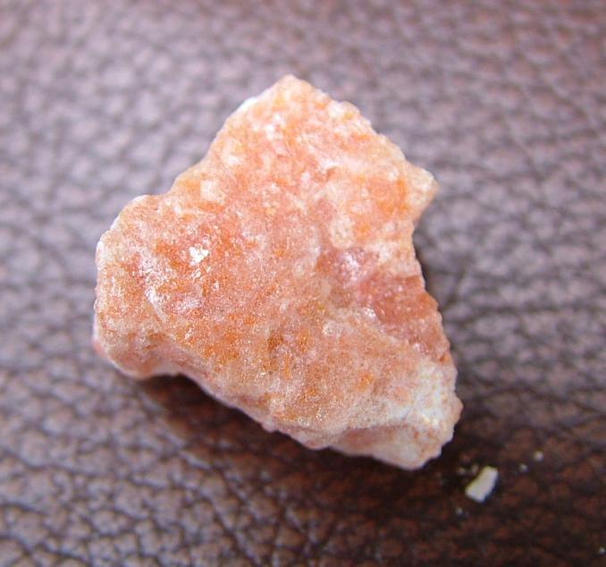

I want to etch a couple of Keris. I can buy in eBay at Minerals:
- sterling arsenic (a dark grey mineral)
- or realgar (arsenic+sulphur, white cristal)
What is better for etching?

Hi Tatyana. I use lab grade arsenic trioxide, but i know that it isn't an easy substance to come by. The nice thing about it though is that it is always the same so you can get more controlled results. I have never used realgar, but i have heard from members here who have that you want the pink stuff. But the white stuff might work just as well.
I don't know anything at all about "sterling arsenic" so you might want to stay away from it.

Tatyana, if you are using realgar, always use the red or deep oranges with some yellow ones. The less the yellow, the better. the deeper the red and orange, the better. Purple is the best, but it's hard to find. The good one should shows crystalline structure, and easy to pulverize using the pestle and mortar. As Marcokeris already warn, it would quickly transfered to a poisonous arsenic gas if you burn it. Never try the white or gray, or pure yellow. Pulverize and mix it with the lime juice, and let it rest for at least a night before use. During use, the the solution's color may change to a brownish color. The older the solution, the deeper the color. Do not throw away the old solution. It's a 'babon warangan', or 'mother solution'. If you use the brushing technique, you should mix the babon with some new one. Immersion technique use a deep brown, almost black solution. Finding the right solution is part of the art. Keep away the solution from oil, copper alloy and soap. Just put some rusty nail and let it rest for a night to make an old solution from the new one, quickly.
Happy marangi, and beware of it's health hazard.

For my sins I was once an aspiring Geologist. It was a long time ago but one thing about minerals sticks clearly in my mind. They differ in composition and colour a lot. If the relative amounts of arsenic to trace elements is important for the etch to work there is no saying that this will always be the same colour. Often other trace elements will alter the colour, sometimes a lot.
The result of this is that a good "etching " realgar may be red in one mine but may be yellow in another.

Thanks for the geological perspective Roy. Makes sense. Also makes realgar even less predictable if you can't really count on the color as a guide.
