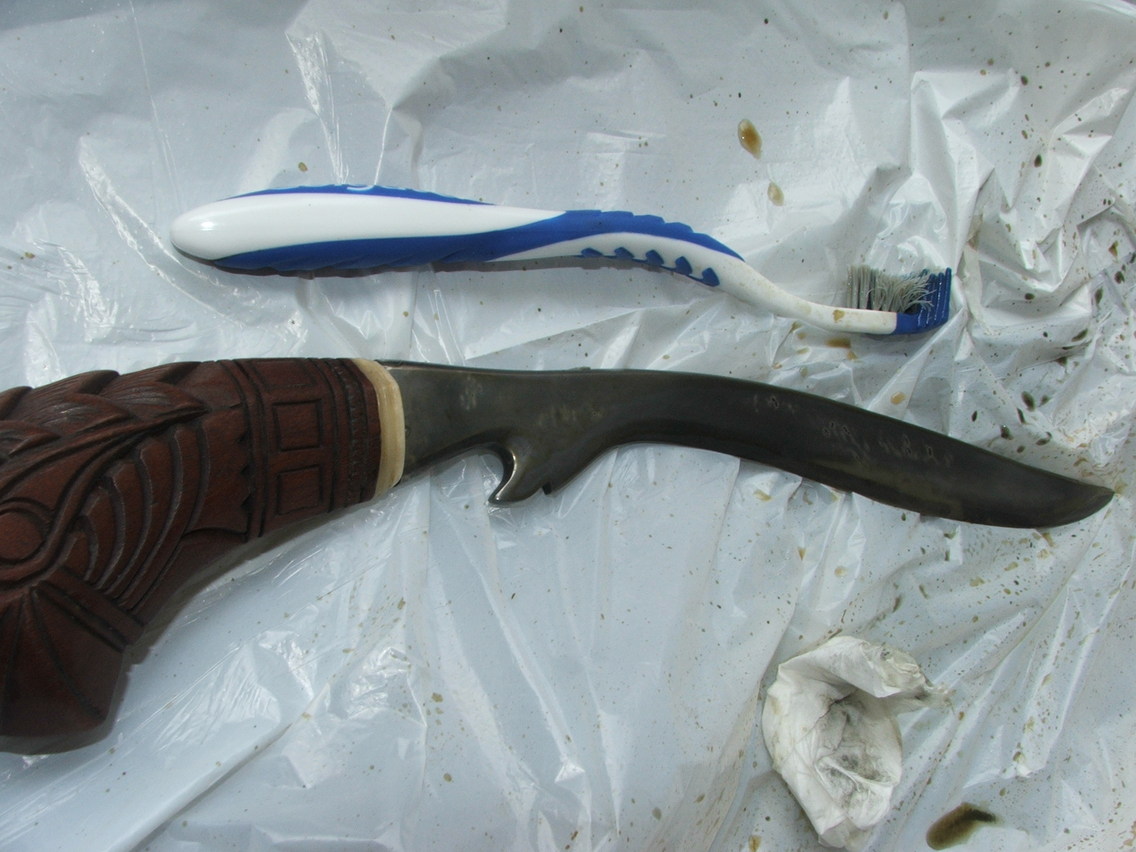

Bought a new keris in Jakarta a few months ago (my first) and decided to carefully sharpen it up. I know you're not supposed to do that with a keris, but being a student of Minangkabau silat and a knife aficionado of sorts, I thought it would be a good idea to give the keris a cutting edge.

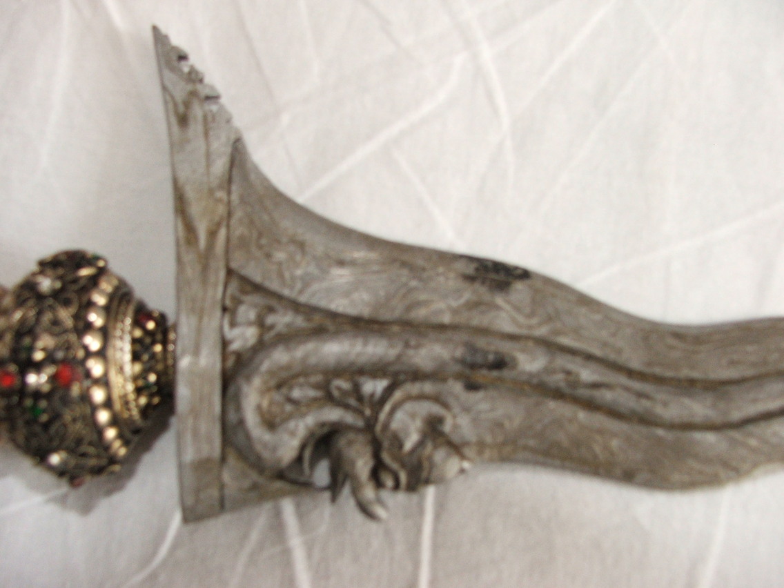

I managed to scrape off a tiny amount of the black stain and decided to try and maranggi the keris again using Thai limes and red warangan, but my results have been far from satisfactory. I used a toothbrush and applied coat after coat of the mixture over the last week, and all I got was a brown liquid residue, reminiscent of rust. I also tried to slap some onto a Valiantco tumbuk lada, and it has turned grey, but the forging marks are clearly apparent. Earlier today I tried scrubbing the warangan into the keris repeatedly after washing it, and it removed the brown residue and also turned the keris more grey than the paintbrush method had.
I was hoping someone could give me some advice onto how to turn this keris back to the beautiful black it once was. Should I just keep scrubbing the warangan in? If I stop, the wilah starts to turn brown. I've read through every thread on here with any mention of warangan and arsenic, but I'm not sure what I'm doing wrong. I'm a little worried this keris may be composed entirely of nickel!

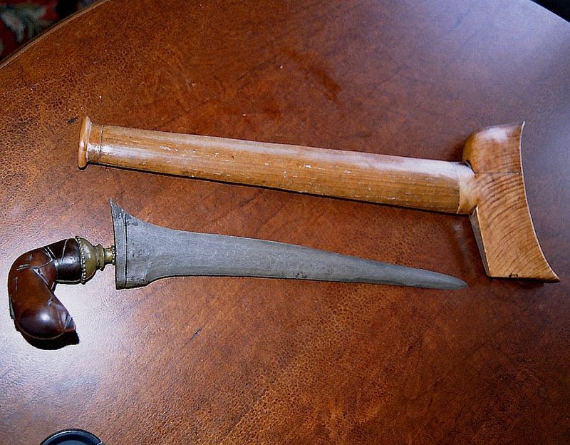

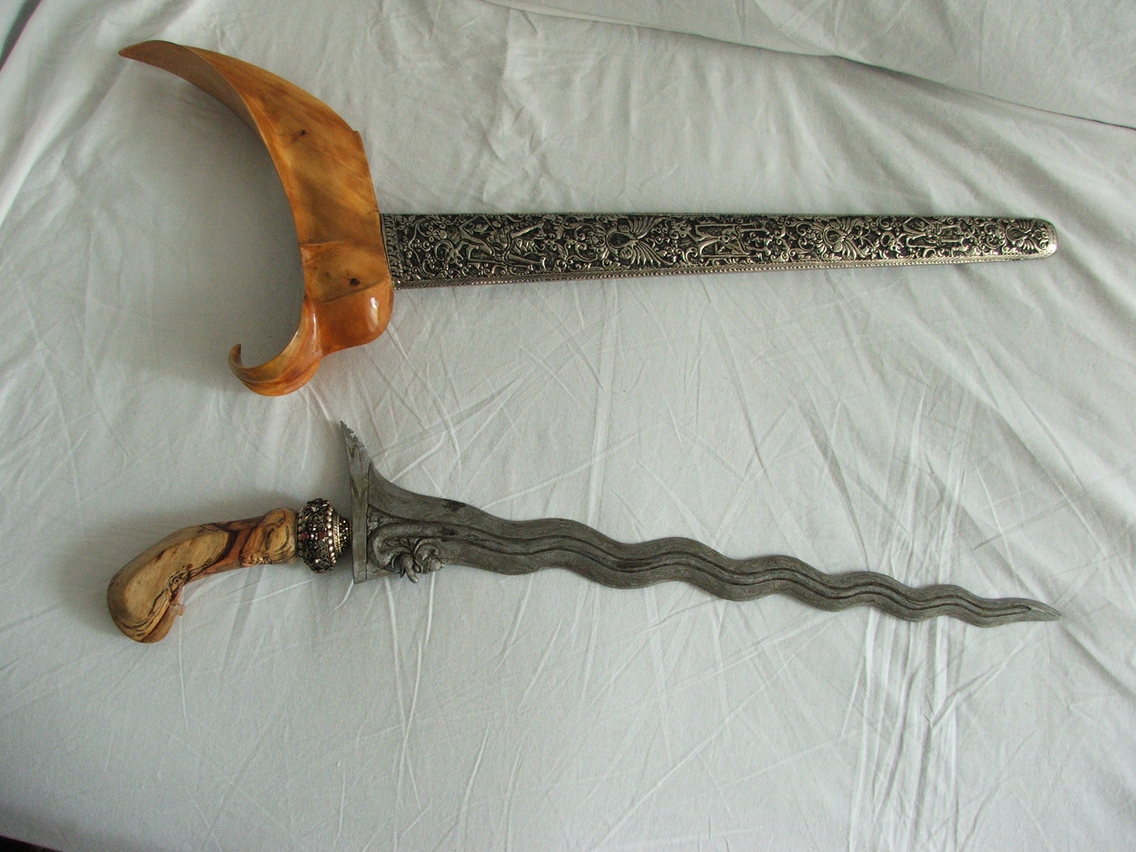

Here are some pictures of the keris and the tumbuk lada. Hopefully this one isn't a keris-like object like the Batak souvenir I picked up...

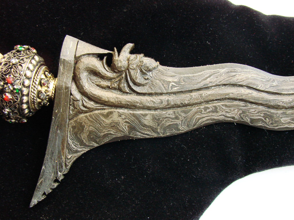

I thoroughly cleaned the blade with lime juice and detergent before drying it thoroughly with a hair dryer, and it was a clear white except for a few patches which would not give up the stain on them (and I can't figure out why). Is it possible this keris was stained with something else besides warangan? The seller got back to me and said it was done with 'black warangan,' which doesn't tell me much. It is possible to turn nickel black with other substances and even heat treating, correct? The ganja does appear to have been made in a sandwich so I'm guessing the wilah is too...
BTW, any comments on the keris guys? I believe it is pamur tiban, but I'm probably wrong...I'm such a newbie to the world of keris, but I'm learning a lot from reading threads here.
I would soak it in pineapple juice for a few days. Also, you can work the blade with some #0000 steel wool to help remove any residual stain. I doubt it was stained with anything other than warangan.

The keris is fairly recent (late 20th-early 21st C) 13 luk naga keris. The work isn't the worst i've seen, but it is far from quality work. I like the design of the pendok.
As much as I want to get this keris looking right, taking steel wool to it is a little scary to me This was the first keris I bought and it supposedly has octahedrite muonionalusta (meteorite) in the pamur, but I'm skeptical, even if I was issued with a 'certificate' for the meteorite used.

Hi Rick! Thanks for weighing in. Yes, I realize the jagged edge on keris comes from warangan. I have a rencong aceh with a jagged (and sharp) edge from warangan, which was a major selling point for me. It is one of the few rencong I've seen with pamur (not that I've seen that many).
That's a lovely keris. Bugis or Sumatran, right?
