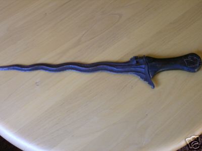

Here is an old Bali keris that I have restored. It had thick layer of black rust, barbarically cleaned on some places with a large file.

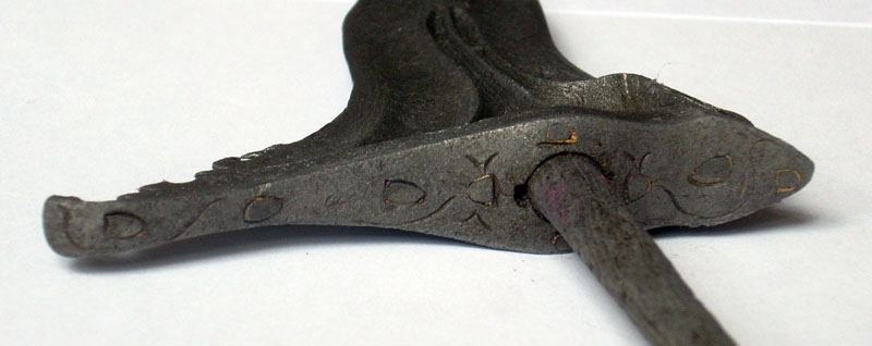

Mr. Alan Maisey has given me a splendid advice on blade cleaning and polishing – thank you Alan very much! I have followed it closely, first cleaning the blade from rust. It is interesting that on this step the golden inlay appeared.

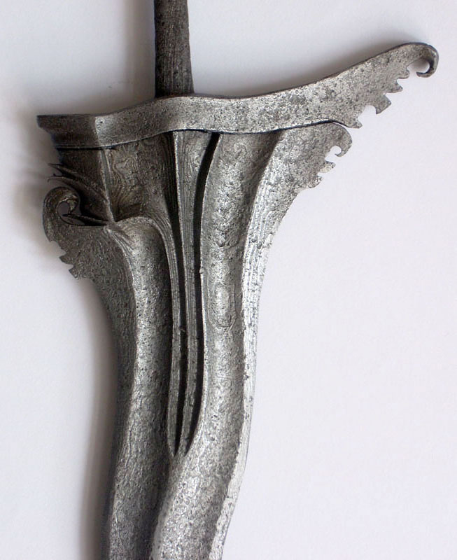

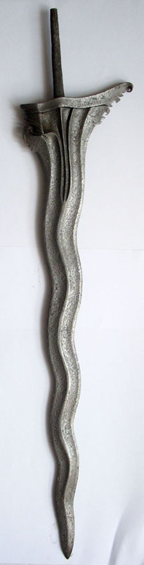

After this I was polishing the blade seven months long (with many breaks really), got sore and cracked fingertips, but the result was pretty rewarding, especially after the etching. The etching and the Wrongko were made on Bali (I would like to thank Mr. Michael Wahle from Bali-Artshop for his help).
I would like to know more about this fascinating blade, so any comments are welcome. The blade is very massive – it is 1.8 cm thick near the Gonjo.

Tatyana, the guidance I gave to you was no more than I have given to many other people, however, you appear to have understood and followed my instructions to the letter, because the result you have achieved is excellent.I doubt that I could do any better than this myself.
Congratulations.

Posts: 6,441
A beautiful conservation Tatyana. brilliant !
Is this a smaller keris than the average of 16 - 18 inches ?
What a fantastic job you have done .
Bravo !!
