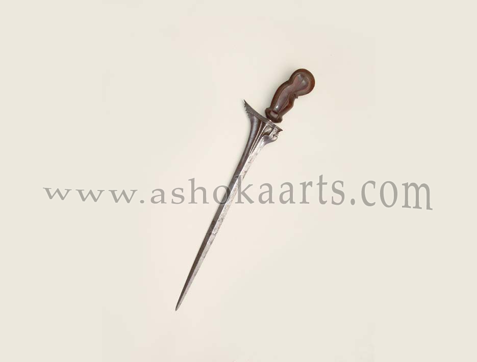

Dear All,
this just ended on ebay, described as pre-1800 keris. As I have seen very small amount of information about Bali/Lombok kerisses, I would like to use the opportunity to learn about things, which are really interesting me.
I have a couple of very incautious questions:

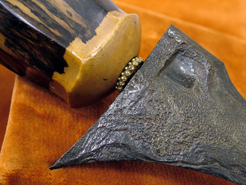

1) The first is about this creation instead of uwer; I have seen once something similar (picture below); is it an older form? Is it a form?

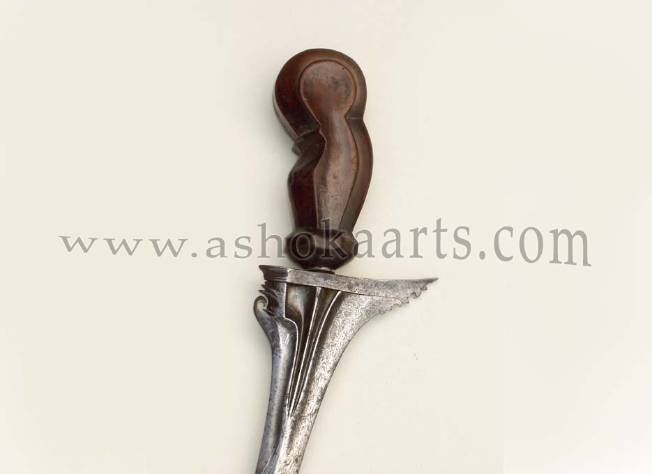

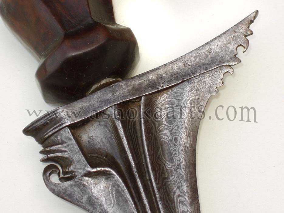

2) The shape of the blade - it seems to be pretty narrow; no jenggot on kembang kacang, which I have seen in most pictures of kerisses with this dapur; the kembang kacang is a little bit thicker at the end as in the middle - is there a possibility, the blade has been reshaped, or it is an older form of this dapur?
3) Is this an old Bali staining?
(I apologise for my English and probably very naive questions)

Gustav, i was watching this auction as well. I don't think i can answer all your questions, but i'll tackle a few.
To my eyes this looks like a fairly nice old Bali or Lombok keris. The narrowness of the blade does not seem that unusual to me. I have a couple of Balis with narrow blades such as this. I don't think the bladec has been re-shaped. I have seen a great number of earlier Bali blades without jenggot. It does look like it probably has what remains of an old Bali stain, but it is fairly worn out and originally the blade would have been darker and more contrasty.
I am not sure about the uwer. I wasn't even sure that this was a separate piece or just part of the hilt. The hilt form is somewhat unusal, but very beautiful and well executed IMHO.
I am sure there will be other opinions.

From what I can see in the photo this keris looks like an original.
It is not at all unusual in both Bali and Jawa for an old blade to have its edges cleaned up. With age, edges of a blade can become ragged, and it is normal practice to regularise these ragged edges. This is what a m'ranggi is paid to do. Its his job to maintain blades in the best possible condition.
Western collectors very often seem to think that any keris which is not in an untouched condition is something that has been "fiddled with", and is thus undesirable. Nothing could be further from the truth. A keris is a living entity and requires maintenance. A keris is not something that is frozen in time and intended to be locked in a glass case in a museum and looked at.
The edges of this blade may have been cleaned up --- or they may not have been. If the job has been well done, it is very difficult to know for certain, and in any case, from my perspective, it is totally irrelevant. This blade looks good now, and that's the important thing.
The hilt is an unusual form, I have a similar one that is quite small.
The the hilt ring (wewer, uwer) may be original, or may not be. I have seen a lot of different things used as hilt rings, both in Bali, and in western societies.
It is not the type of hilt ring that we usually encounter.
Impossible to comment on the stain from a photo.
As for the age of pre-1800, unless there is a provenance that can substantiate that, I'd take it with a grain of salt.
