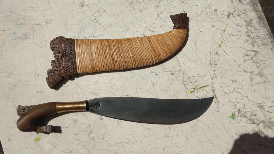

I'm interested in the Badung, a Barung-like weapon which is endemic to Southern Palawan (an area that was once part of the Sulu Sultanate). While I've seen traces of the Palawan Badung in this forum (other members dub it as 'Palawan Barung'), I'm interested if there are other antiques of the Badung out there. The most telling difference of Badungs from Barungs include: a) unorthodox blade profile [usually comes in the form of an upturned tip], b) different ukkil features, c) different hilts / scabbards (badungs usually incorporate a rope that can be tied to the waste like Visayan blades). Hopefully some gracious people can share their Badung vintage or antique blades, and where they got it from.

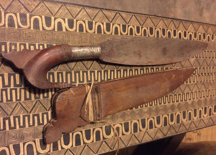

To start off, I'll share a couple of pics of the Badung I know of. The first one is an antique, estimated a century old.

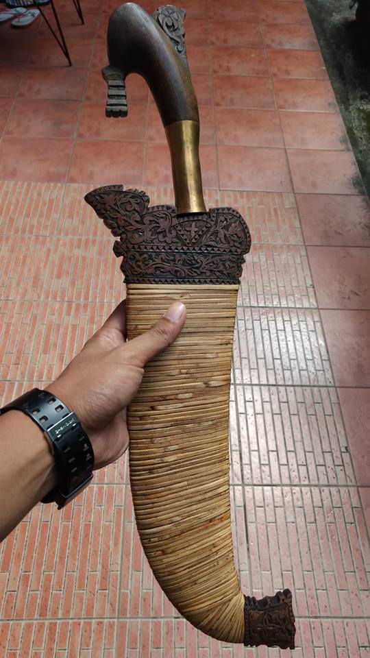

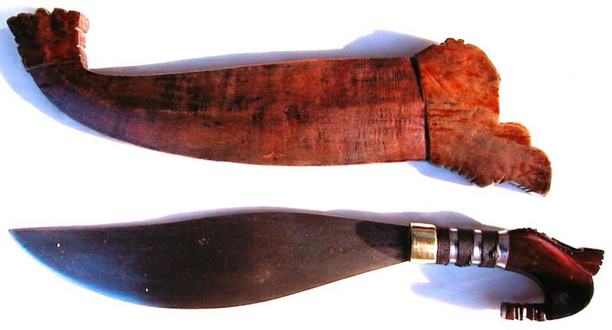

The second is recently-made by a famous blacksmith family in Southern Palawan.

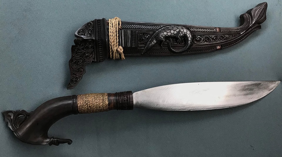

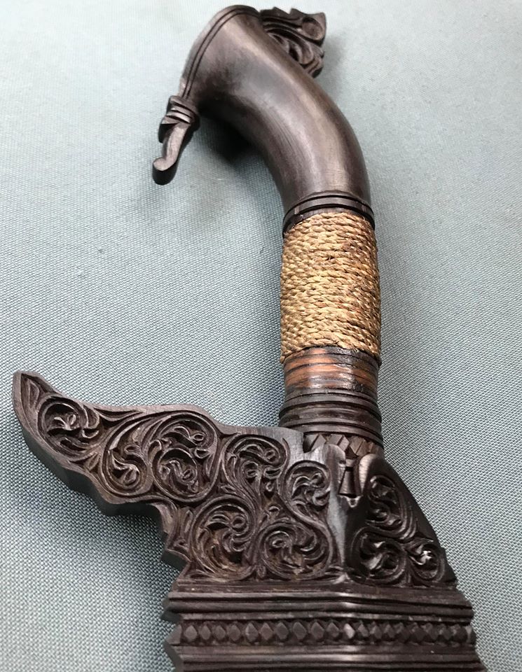

The third is recently-made by a tribe known as the Palaw'an.

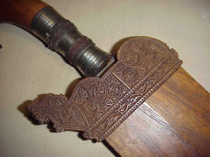

Going back to the badung: ah yes, the ukkil. I'm attaching a couple of pics here for reference. The first pic, I got somewhere in this forum as well (sorry I forgot exactly where), it's the zoomed-in scabbard of a Tausug barung. The second pic is a badung from the Palaw'an tribe, while the third pic is the badung I featured earlier (the one whose hilt and scabbard most closely resembles a barung).
The Tausug barung's ukkil theme is made up of waves. Flowing, constant water that is symmetric. Symmetry is a primary feature of Sulu ukkil, and this is most clearly reflected in the scabbard pattern. There is also the presence of tiny triangles which form boundaries across the pattern- another important feature present in Sulu ukkil. Another notable feature is that the waves 'spill over' the boundaries, sometimes even penetrating through the usual scabbard boundaries.
The Palaw'an tribe badung's theme can be likened to the forest. There is an abundance of vines in the ukkils, with no symmetry. There is also an absence of triangles. The boundary of the ukkil 'traps' the vines; none of them spill over the clearly-delineated boundaries of the scabbard.
The Deuna badung, at first glance, seems similar to the Tausug barung, but it's really not. Upon closer inspection, it embraces the same theme as the tribal badung- lots of vines, clear boundary, no symmetry. Curiously, there are small triangles that form mini-boundaries across the pattern.
My Yakan contact said that she believes the Tausug pattern came about because the Tausug were seafaring warriors. Water, waves, ocean- these are very important themes for the Tausug. On the other hand, she believes that the badung is indicative of the life of those in Palawan- forest, mountain, trees- all of these point to an agricultural lifestyle, utility-based, for survival.
The smith who made my badung said that he believes Palawan-based blades have different ukkil because Palawan is one long island with different land features; it is not continuous and has much variety, hence the lack of symmetry.
