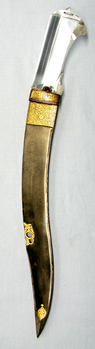

Some of you may have crystal-handled daggers – but is the handle made of crystal?
Some years ago I read in one of my books that the Belgians made glass hilts for export to India, and maybe to Persia as well. Unfortunately I did not take a note, as I was looking for something else – but recently I remembered it.
I have two daggers with crystal hilts, and they have both been tested by a professional, and proven to have be made of crystal, but as there have been an export, however how small it could/would have been – and I don’t think it was small, there must be a lot of glass hilts out there. This does not mean that they are new, as the Belgians made the glass hilts centuries ago – but it is interesting all the same.
Those of you who have crystal hilts, did you ever have them tested?
There is of course another thing to take into consideration, that later hilts may also have been made of glass and sold as crystal hilts.
When I started to collect many, many years ago the fakes/copies were mostly of European pieces, but now that the prices have gone up on the Asian weapons, it seem as if the copying is at full speed – so be aware.

This is absolutely beautiful dagger, Jens
The "crystal" used on Mughal handles is a Rock Crystal (colourless variety of Quartz). It is carved and polished just like a rock/stone. It comes clear and multi-coloured, with varying degrees of clarity ranging from pure to cloudy with inclusions.
As for glass handles - I don't think the glass can be carved. It would be an extremely difficult and skill intensive process. It had to be cast in shape of a handle, so the difference can be seen upon close inspection.

Thank you for the answers.
I don’t know when the Belgians were supposed to exported glass hilts to India, and I don’t even know if the export was big – all I have is what I read in a book long ago, and I don’t even know the title of the book.
What I would like to know is, if others have come across any information’s of this kind, or maybe someone can show us a picture of one of these hilts as I have never seen one.

BUT HAVE WORKED WITH GLASS A LITTLE AND CAN SAY IT CAN BE CARVED OR POURED INTO A MOLD TO FORM THE DESIRED SHAPE. A GOOD GLASS WORKER CAN ALSO FASHON AN ACCEPTABLE HANDLE BY HAND WITH A LITTLE GRINDING AND POLISH TO FINISH UP.
FOR A PRESENTATION OR CEREMONIAL DRESS DAGGER OR SWORD GLASS WOULD BE FINE BUT AS MENTIONED FRAGLE. GLASS WOULD HAVE AN ADVANTAGE OVER NATURAL CRYSTAL IN THAT IT COULD BE MADE IN ANY SIZE AND COLOR DESIRED WITH GARANTEED CLARITY IF SO DESIRED. INCLUSIONS , BUBBLES ECT . COULD ALSO BE ADDED.
PERHAPS A LOOK AT THE GLASS INDUSTRYS HISTORY IN VINICE ITALY MIGHT TURN UP SOME INFO, THEY HAVE BEEN MASTERS FOR A VERY LONG TIME. I WOULD BE SURPRIZED IF GLASS HANDLES HAVE NOT BEEN MADE IN SEVERAL COUNTRYS IN THE PAST. TAKE A LOOK AT THE OLD POSTS (ACRHIVES) ON PHIA KAETTA SOME OF THEM HAD CRYSTAL HANDLES, I HOPE THE PICTURES ARE STILL THERE.

glass can also be tempered and hardened, some 'alloys' are quite tough.
the connection of the grip to the blade with a teeny tiny tang and that habaki style bolster does not look suitable for a weapon designed to be actually used, but it does look nice.
