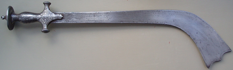

I have recently obtained this tulwar-hilted kukri. I wondered if anyone could tell me something about it? I can see a virtually identical one (except for the centre picture) on page 385 of Islamic Weapons, by A.Tirri, but unfortunately there is no more information there.
I assume this is a sacrificial or commemorative knife, but I have no idea what the significance of the centre temple and figure might be or where it comes from? One the reverse side (no picture yet because it is still hidden below grime) there is a figure riding either a horse or tiger with what looks like the same head as the figure in the temple, but otherwise it is identical to the side pictured.
Thanks

The figure standing so casually on one leg is Lord Krishna playing his flute.
I too have seen these Tulwar hilted Kuk's but do not know much about them apart from they all (well the ones I've seen) have similar simple/flat but elaborately chiselled blades.
A very interesting piece.

I think it is more ceremonial/decorative than fighting.
BTW, the ribbon of incised decorations on yours is reminescent in principle of this one:
http://www.vikingsword.com/vb/showthread.php?t=9683
No?

These are decorative pieces. It's my understanding from John Powell (from whom I acquired one of them) that they were the original tourist kukris, made for the original tourists - British officers in India who wanted exotic, if not necessarily authentic, souvenirs of their days in service to the Raj. Old tulwar handles were joined to a piece of flat, soft metal resembling an exaggerated kukri blade, decorated with exotic motifs of tigers, elephants, and Hindu deities, to create the ultimate wall-hanger for the family home back in England.
The illustration is from the Francis Bannerman Catalog of 1927, showing how these and other decorated arms could be used to create a striking display - "Prices Quoted On Application".

Thanks folks. I guess this last post pretty well clears this up. I certainly would not trust this blade in a fight against anything bigger than a rabbit, so a decorative item would fit well.
I'll clean up the other side and return it to the purpose it was originally intended for - dcorating a British guy's house wall

Nicely done Berkeley!!! Its amazing how much is in those early Bannerman catalogs, and I have always tried to imagine what it would have been like to visit that huge 'castle' of antiques in New York back then.
Hi Medfidk,
While many of the weapons of India were indeed ceremonial or votive pieces, they are still fascinating as icons of the diverse tribal populations, religions and cultures of the subcontinent. Regardless of the actual use of a weapon, it is the symbolism and motif that establish it as an extremely important element of the culture and often religion it represents.
I think one of the best books written describing this aspect of Indian arms is "Hindu Arms and Ritual" by Robert Elgood, which truly helps understand the depth of esoterica imbued in these weapons.
The tulwar style hilt form on this weapon is of a style produced in Rajasthan regions in the 19th century. It seems that these hybrid type weapons which incorporate often both kukri and kora style blades are typically from regions in Uttar Pradesh and Bengal, and incorporate these Nepali forms with the tulwar hilts. From what I have understood, these are temple weapons used in sacrifices of doves, but I am not familiar with more detail on that ceremonial use. Naturally I would agree basically with what John Powell has noted on the familiar 'tourist' designator, but I have seen tulwar hilted koras with similar decoration that have been in use, and around for a very long time.
Whatever the case, it is a very attractive weapon, and though not a fighting weapon, an extremely important piece of Indian religious culture.
