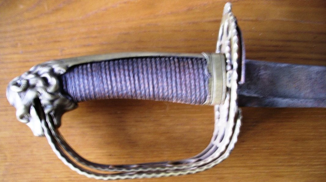

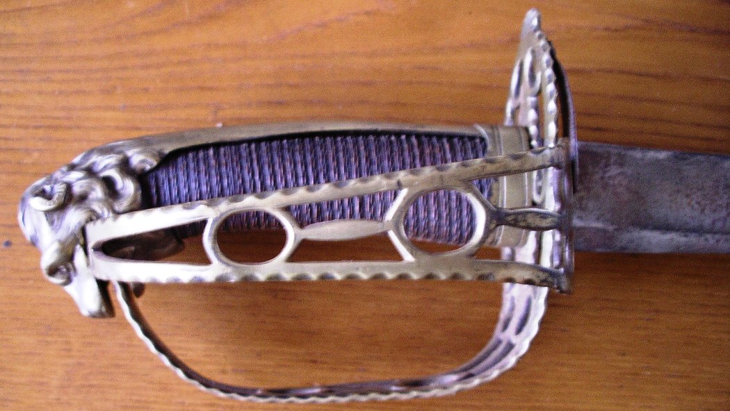

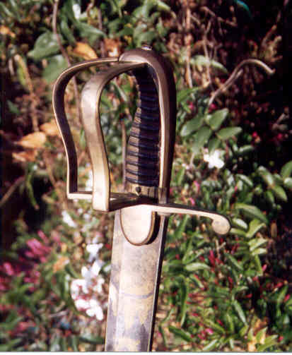

Hi Guys
I am attempting to put together an article on this unusual pattern for our local collecting newsletter and I am having difficulty finding out much to work with.
The majority of the examples I have found are French, although a friend of mine has a fabulous blue and gilt example that appears to be English. Mine posted here is a typically French one that were used by both the navy and mounted infantry or cavalry.
Any information and or additional examples will be most welcome. The references I have found thus far are:
May and Annis Swords for Sea Service Plate 97 and referenced on Pages 143-144
LHOSTE Jean, & RESEK Patrick LES SABRES PORTÉS PAR L'ARMÉE FRANÇAISE. Pp22, 41, 261-271, 301
Sim Comfort’s book Naval Swords and Dirks Page 380-381
SOUTHWICK Leslie The Price Guide to Antique Edged Weapons Pp 98 No 254
Officer’s Mounted Folding Guard Sabre
Nationality: French
Date: Circa 1780 Described as Pre-revolutionary period
Maker/Retailer: n/a
Overall Length: 33” (84 cm)
Blade length: 27.3/4” (70.5 cm)
Blade widest point: 1 3/8” (3.4 cm)
Hilt widest point: 4 7/8” (12.4 cm)
Inside grip length: 4 ¼” (10.7 cm)
Marks, etc.: n/a
Description
French Officer’s Mounted Folding Guard Sabre (Possibly Naval).
These swords were prominently used by the French Infantry, but also by the French Navy in the French revolution-Napoleonic era. Brass folding hilt with a steel button mechanism. The folding guard moves smooth & the mechanism perfect. Backstrap in brass, as is the knuckle guard & pommel. Grip bound in tight twisted brass wire & in 100% perfect condition. The hilt, backstrap & wire binding are just about pristine perfect, save for a tiny hairline crack in the top of the guard, hardly noticable the crack not passing all the way through the brass. A diamond shaped pommel also in brass. The blade has a wide shallow fuller for most of the blades length as well as a narrow fuller running along the back of the blade. No markings or engravings. No scabbard.
Cheers Cathey and Rex

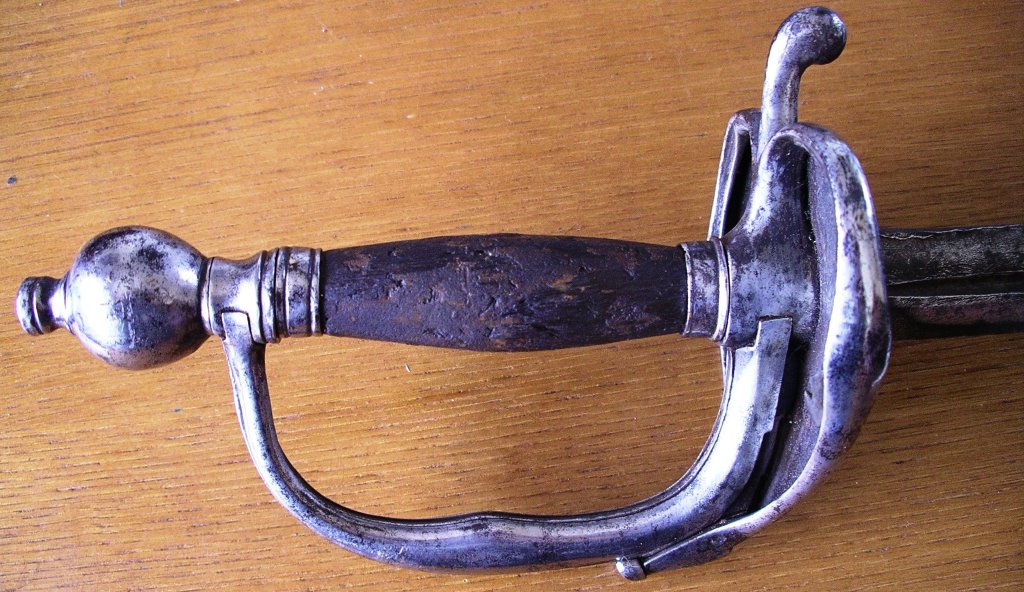

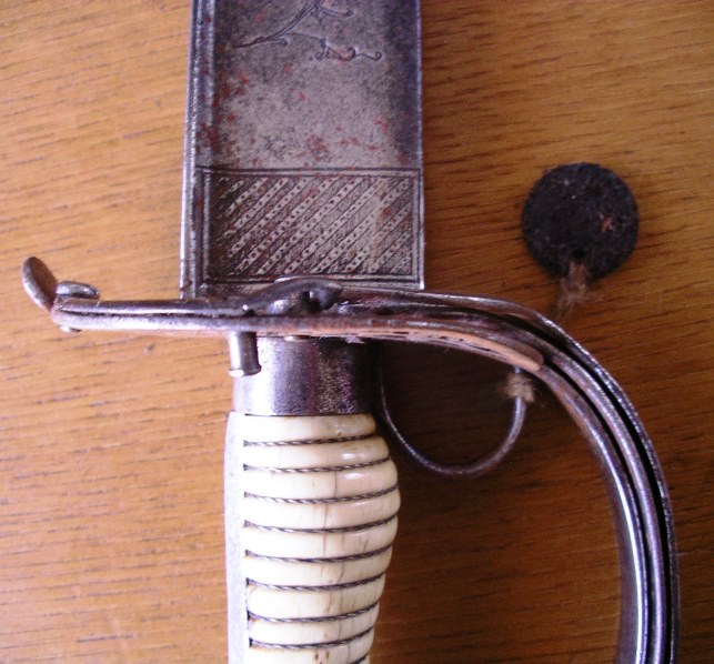

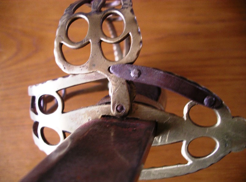

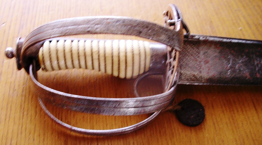

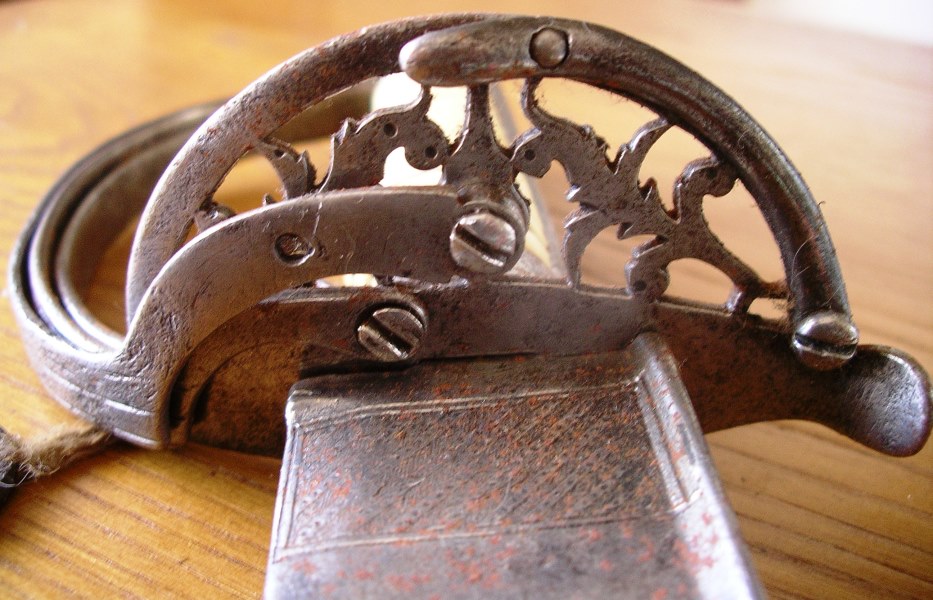

Nice sword Cathey,
Well known by its French name SABRE A GARDE TOURNANTE, a term with which you may find several examples an data in the internet. You may even find websites assuring that this model is only French; yet what may only be French is a determined model variation, as the folding system may be found elsewhere, as also possibly the one of your friend.

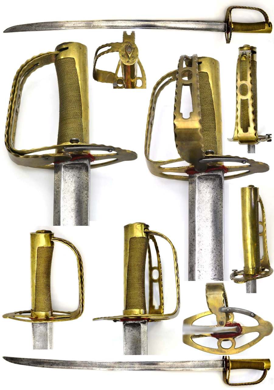

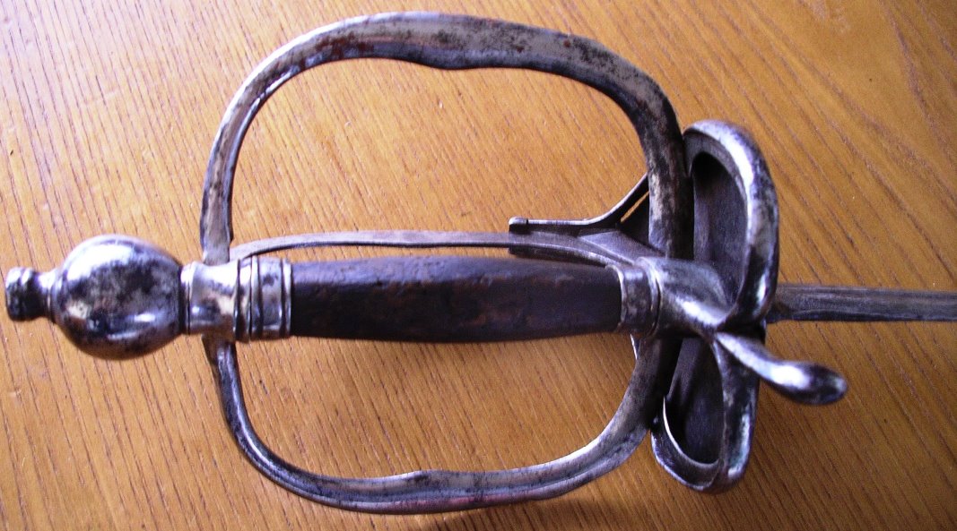

I once had some pictures of these swords sent from a local collector, when about to buy him some pieces.
I will here upload some of those pictures; not good ones, as the fellow was a lousy photographer; but this is to confirm that a few variants existed, namely the French lion head, which several sources name as Volunteer Officer version (#1+2+3), the Portuguese Navy model, with a finger guard (#4+5+6), and even the Walloon hilt type (#6+8).
Other members will certainly give you better info on this subject.

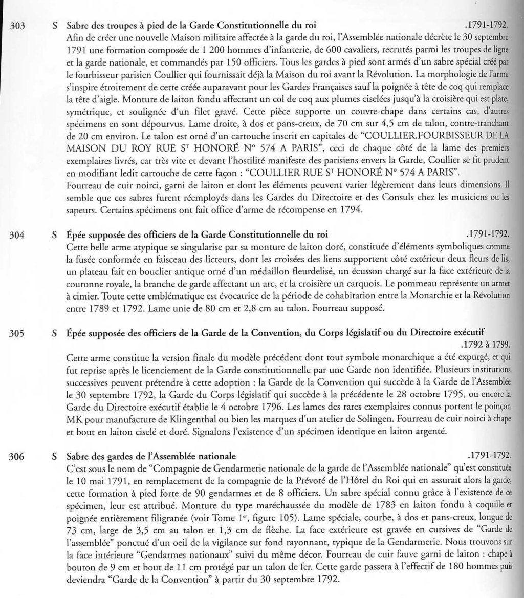

First, what seems to be a fine exemple of the Garde Constitutionnelle sword... marked on both sides from the fourbisseur Coullier!!! Its authenticity leaves no doubt:
the sword
Then, an officer sword of that ever-changing parliament guard with a thousand names, and small size scans of an article in the Gazette des Armes depicting what is clearly the same type/model:
the sword
the article
Of course, none of this has nothing to do with gardes tournantes, and the very explanation Mr. Comfort gives in regard to its origins contradicts everything I read from the French collector community (also that emphasis on naval use, which makes no sense: it was just so commonplace in both the infantry and light cavarly that it could have end up anywhere, much like a briquet).

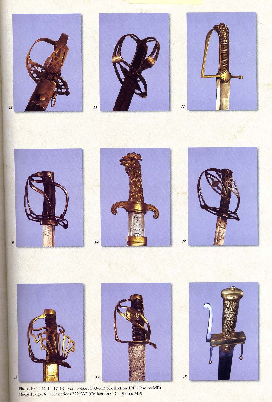

Pétard and Ariès, in a leaflet dedicated to fantaisie sabers from the second half of the 18th century (in cahier XXII from 1974), show various gardes tournantes, but the early ones are more like split branches, like those we can see on Walloons and such. But they also give the following drawings in attachment. We can clearly see the beaded branch style (garde perlée) of germanic/eastern influence, and the well formed garde tournante mechanism. It's difficult to pinpoint exactly the decade during which this style was fashionable in France, but it surely was by the 1780's, and not so much by the 1790's. The other saber is more 1790's-ish.
But there also is a variety of other petits Montomrency à garde tournante, or other infantry or cavalry sabers with a garde tournante (and I mean that specific kind garde tournante, with the leaf lock and all) that can be dated to the late years of the monarchy, i.e. late 1780's, because they're otherwise similar in every other aspect to similar sabers of the period.
I don't think we will ever figure out who invented the garde tournante, if there ever was such a person, but we can safely assume that it evolved from previous designs (like those on the Walloons), and during a brief and intense period of time, a bit before the Revolution and during it (and you can read in periods accounts that people were really smelling something huge was in the air even before anything "serious" had really started), with an amazing technological coincidence as hilt fashion turned the way it had (many parts fashioned from sheet metal), making it extremely compatible with that specific garde tournante system, it rapidly gained a very significant popularity, and also fell in about a decade as the political situation changed as well as fashion in hilt designs. Not that it's only French, of course, but it's typically French, and I really think this can't be taken out of the equation.

Sim Comfort has kindly responded to my Query and his reference for the origin of the Attack hilt is Des Sabres et Des Epees, Vol Ill, by Michel Petard, pub Canonnier, Nantes, 2005 indicating that Petard believed the original design comes Coullier. I don't have Petards book so impossible for me to cross reference back. Perhaps if someone has the book they could look it up. Sim did mention he had difficulty getting translations of the text. I have attached the scanned pages Sim has sent me.
Cheers Cathey
Cathey is offline   Reply With Quote
Old 31st December 2017, 01:00 AM   #16
Madnumforce
Join Date: Jun 2017
Posts: 28
Oh damn. That's really just a case of a complete absence of a translation, or complete misunderstanding. The paragraph numbered 303, mentioning Coullier, describes the sword numbered as picture 14, exactly the same kind as the one I gave a link to Mr. Malvaux antiques website in my previous post. There is absolute unmistakable certainty about it: it talks about a cock's head with feather chiseled on the grip all the way to the crossguard/crosspiece. The previous "model", which was designed for the Gardes Françaises (when it was still the "plain" monarchy), was also designed and made by Coullier... and that it was an eagle head instead of a cock.
But it seems that of the four descriptions, the 303 is the only one fitting one of these nine pictures, so it's probably a bit of a mess to spot which description matches with which picture in the book.
You can tell Mr. Comfort that next time he needs a translation from French, he can ask me. I can't let this kind of thing ever happen again.

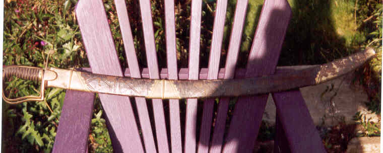

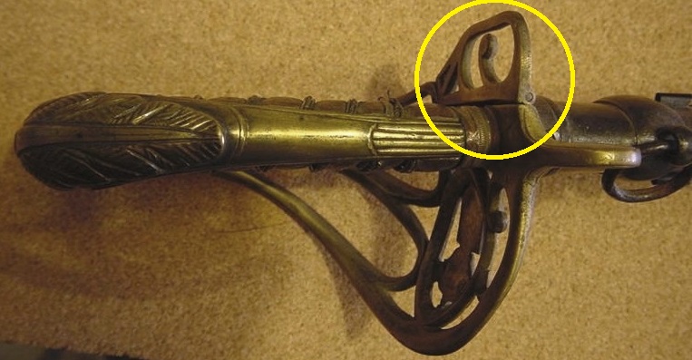

1796 Light Cavalry Officer's Sword with folding sideguard.
Blade is normal 1796 dimensions, and retains considerable bluing and gilding. Blade is signed "Osborn's Warranted".
Scabbard has lost most of the gilding on it's mounts. Top chape is detached and has had the hanging ring broken off; is signed "Henry Osborn, Bordesly near Birmingham"
Hilt is of gilt copper, pretty worn. The quillon is a restoration (and a little too straight). Original leather covered grip with wire wrap.
The interesting feature is the hinged sideguard, ala the French "attack" guards. The facetted ferrule at the grip base has a knob protruding on the right side. The knob is connected to a blade that engages a slot on the hinged sideguard to lock it in place when extended. The spring inside the ferrule that activated the knob/blade is either broken or jammed, and the blade no longer engages the slot, so you can't lock the sideguard now.
--ElJay
