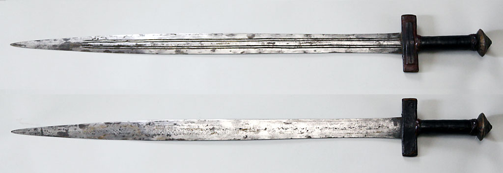

Furthermore, this theory is supported by the fact that one of our “Guduf type” sword is actually preserved in the Quai Branly collections (http://www.quaibranly.fr/fr/explorer...urreau/page/1/). This sword, pictured below, is really similar to the type we’re discussing, but was collected in Rey-Bouba in 1931, and is described as “Duru blacksmith work”, a significant information, since “Duru” is one of the various names used to refer to the Dìì ethnic group.
