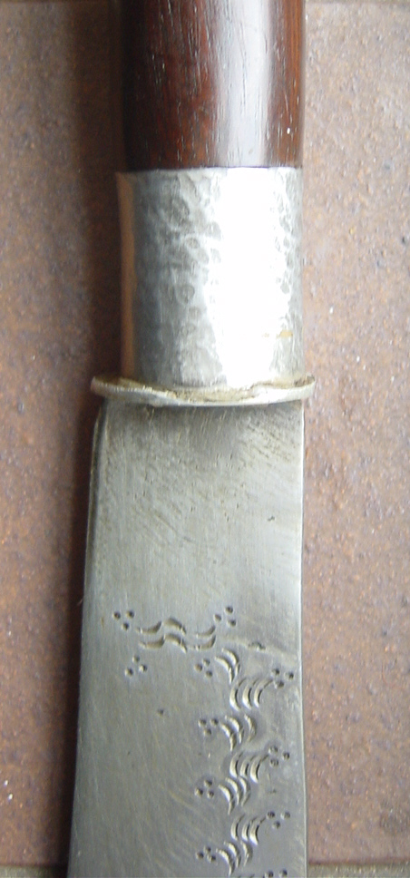

Hi Lew,
Thanks for having a look for me.
The blade is heavy like a Kukri, with small inset pieces of brass in the spine and simp[le incised decoration on the blade. Its about 600g and has hammer strike marks on the spine so has been used as a tool at some stage.
I havent cleaned it up or anything yet, it's as I bought it about 5 years ago.
Any ideas appreciated. I thought it was Indian and was going to stick a Tulwar hilt on it.
Thanks
Gene
Old 21st June 2008, 02:11 AM   #4
Lew
Lew's Avatar
Location: East Coast USA
Posts: 3,191

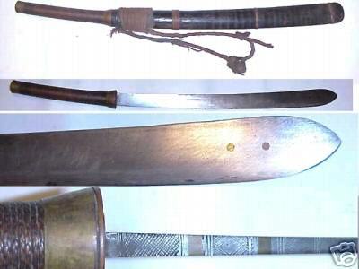

Gene
Brass inserts very interesting? I am leaning now towards Assam and Burma ot even Thai? I have seen those brass inlays in some older Dhas before. It may be some form of dha the tang is straight or slightly upward in angle similar to the dha pictured. Mark what do you think?

Wow thanks guys! :-)
Lew,
I've been so hung up on the bolo blade shape that I'd never noticed how 'dha' like the back end of the blade was.
I've had a few Dha's over the years, but never seen one with the handle off.
kronckew, do you know what those knives are called? It certainly looks like its somewhere between one of them and a dha....
here's the back end compared with Lew's brass inserts.

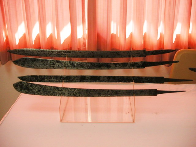

Old 21st June 2008, 02:38 PM   #7
Posts: 4,285
as far as i know, they are just kind of a generic kitchen/utility knife common in thailand. here are some more being used as throwing knives, meed eneb? meed maw or mawr
and here is a decorated temple version with 'magic' powers,
the site is HERE <-linky, called a meed mor. (herb knife? - bit big for that tho) meed=knife, saw another one for sale on ebay as a meed mong, another as a thai kukri
see also post 14 HERE

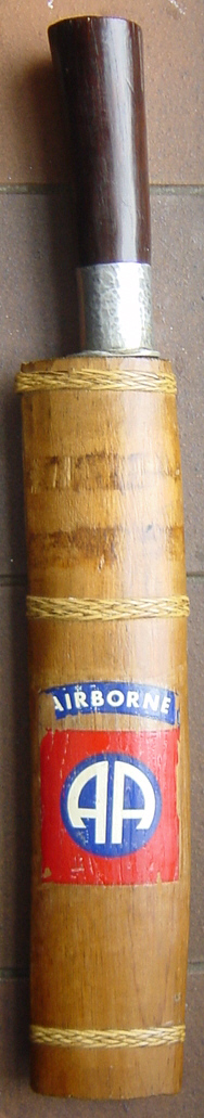

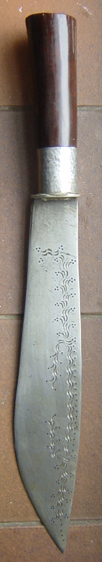

Old 21st June 2008, 04:14 PM   #8
Posts: 5,992
Here is a more recent example with interesting scabbard decoration. Teak, aluminium amd epoxy type resin? handle.

This is great!
I can make a handle like that fairly easily.
Notice the similarities in decoration style with the new one Tim?
I like the 'temple' one kronckew. I think the blade I have has considerable age.
The site you link to talks about larger ones! Hmmm, interesting ;-)
Certainly worth carving a nice handle for I'd say!!
Hopefully the blade will clean up nicely.
82nd Airborne, hoooahhh!
