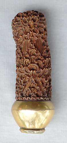

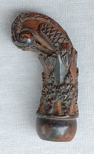

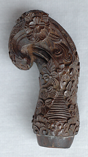

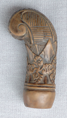

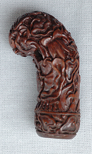

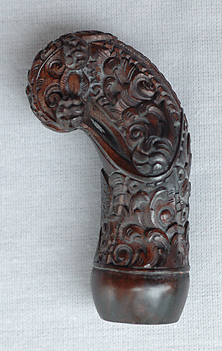

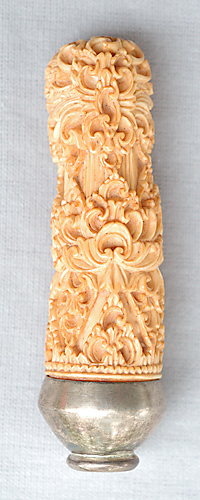

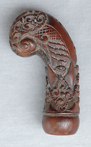

Shown below are a number of wooden Madura handles.
They are randomly mixed and of only ordinary quality. Frankly, I find it very difficult to declare that the older ones are superior in any way to the ones from the current era.
Shown also is an old ivory pedang handle, and a brand new ivory pedang handle. I can see little or no difference in the quality of workmanship.

Thanks for showing these hilts Alan. Just for the record i believe the hilts that Marco was referring to and certainly the ones i meant when agreeing with him are the fanciful new models which bear no resemblence to these classic styles of hilt forms. I'll see if i can find some examples to post. I think the Madurese have always been damn good carvers and the quality of that work, at it's best, seems to continue to this day.
I do understand, to a point, your case of the "double-edged sword". I suppose i am looking at this from a more ideal world viewpoint. It just seems right to give credit where credit is due. But i can also see how in this imperfect world that might lead to deception and confusion.
It is not at this point in time much in my personal interest to own a keris based upon the name of it's maker. I would want to own a keris based more on my own impressions of it's style, execution and feel. But i do understand that other collectors have different criteria for what they collect and might be enticed to buy a keris based on false information about it's maker. That would indeed be unfortunate.

Thanks for your further explanation Ganjawulung. You had me a little bit confused there for a moment.
Yes, Pak Pauzan is pretty much out of the game now; he had some health problems a few years back, and as a consequence changed his life-style. That keris dapur gumbeng carries the pamor Poleng Wengkon, which was the design of Mr. Dietrich Drescher. A keris of this design and pamor, and named Kiyahi Sureng Karya was presented to Bapak Menko Polkam H. Surono.During his working life, Pak Pauzan made a very wide range of keris styles and pamors, and often worked in the style of Mataram. He created some incredibly beautiful keris naga.
When I mentioned dealers, I was in no way referring to any makers, part-time makers , or anybody who is or was in any way associated with making. I was referring to people, in fact one in particular, who are exclusively dealers and who operated, and still operate in some cases, principally in the western world.
Oh yes David, some of the recent flights of fancy of Madurese carvers are wee bit extreme, but it really gets back to the buyer:- if the buyer is prepared to pay solid money, and can appreciate good craftsmanship, he can obtain excellent quality new work; if he is not prepared to pay the price of excellent work, and cannot differentiate between good craftsmanship, and pedestrian craftsmanship, then he will finish up with lesser pieces.
When I selected these handles to photograph, I deliberately chose very ordinary handles. Yes, the ivory ones are superior, but the wooden ones are ordinary, and would only command ordinary prices, whether old or new.It comes back to the buyer's ability to recognise craftsmanship.When people stop buying second rate doodleings of children, then we can expect to see an increase in the quality of the items being offered.
