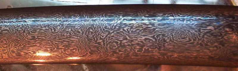

Recently I had an argument about the Rose pattern with one of my friends, who claimed that what you see on the pictures below is not a rose pattern per se, but just random circular distortions; rose pattern is a deliberate/manual process of making a circle, not self-occurring. But it looks pretty Ros'ish to me. Any comments?
Old 20th June 2007, 12:31 PM   #2
Beautiful blade!
But... I am with your friend: I can't see any artificially-applied pattern, ladder or roses.
Old 20th June 2007, 12:49 PM   #3
CharlesS
CharlesS's Avatar
Location: Greenville, NC
Posts: 1,854
I'm with Ariel....Forget the flowers, just revel in the beauty of that blade!

Thanks Ariel.
Somehow I thought the concept of "rudimentary"/(not deliberately made) ladder formations would apply to rose formations as well. I know it is just a concept, but wanted to hear what others think.

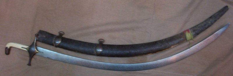

Also, below is another very fine wootz blade, recently restored. It is much wider and heavier one, with amazing wootz clarity and contrast. Hope I am not offending anyone by posting too many wootz pictures:-)

One can never post too many wootz pictures and shame on anyone who thinks such a thing!
Circular distortions, such as you picture, are not an uncommon feature in wootz blades but seem to show up in better quality examples. I define better quality as higher levels of activity(circular distortions, meandering lines, etc.), higher contrast and generally tend to be of a more sophisticated level of grind and polish. As you state, the ladder and rose pattern is created through a manual manipulation of the wootz bar and therefore tends to have regularity to its spacing, position between ladder rungs, etc.
Beautiful example. Thanks for sharing!

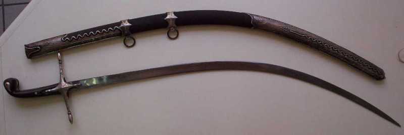

Tatyana,
I am restoring the first sword now, and will post pictures when it is ready.
Here is the picture of the second one:

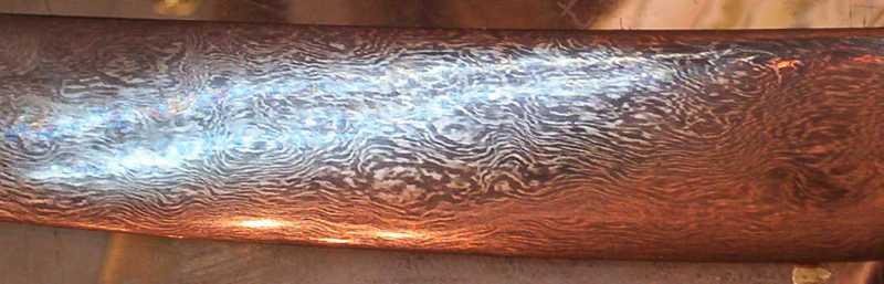

Got it Rick:-) Here is another one of a freshly polished/etched blade which looks like wootz:-)
