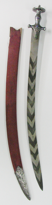

How old do you think this hilt is, and from where in India do you think it origins?
Its is silver with enamel, and as you can see the enamel is very fine, but before you answer watch the colours.
I am not quite sure myself, but I would like to hear other oppinions.

I will have a stab at it; Deccan Plateau, Hyderabad? No idea about the age could be brand new. Go on put us out of our misery.

It is most likely 19th century, but I think you are wrong when you say Deccan, Hyderabad. I think it is more likely Rajasthan/Mewar, due to the colours the different districts were specializing in, mentioned in Jacob and Hendley’s book ‘Jeypore Enamels’, and due to the fact that the finest centres for enamel lay to the north.
There are a few interesting things about this hilt. Mostly when you see a tulwar hilt it has the same decoration all over, but not this one, as the hilt, the top of the disc and the dome have the same decorations and colours, but under the disc the decoration and the colours are quite different, here it is clearly a water plant, single petal lotus’s most likely, with butterflies. I have often wondered when I saw a different decoration on the underside of the disc. Why was it made differently, so only the owner could see it, and then only when he turned the tulwar upside down? It must have been more expensive due to the bigger number of colours, as it would have to go more time into the oven for the melting process, so it must have had a special meaning to the owner. You now and again see the same change in decoration on hilts decorated in koft gari.

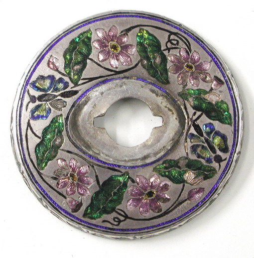

Another thing, which makes me say north India, is the transparency and the way the colours are fating, this was very difficult to make, and I think it was only made in the north. For a long time the enamellers could not make the past themselves, so they got it from Lucknow – but it was the furnace job which made the difference.

Beautiful work. I do not know anything about the colours or enameling centers. I was just guessing on the form of the decoration which is very different from the Northern/Kashmir enameled kard you post for discussion some time ago. Wonderful condition on the handle anyway.

am happy to defer to your theories, especially the date on seeing the pommel underside. i know the sword of course, but have a bad memory :-)
hendleys book is great (all of them, but the jeypore enamels that you refer to especially) but like egerton, he must be taken cautiosly. both he and egerton spent much time in india, studying a subject they were both obviously very passionate about, but neither spent much time in the south. also, both studied mainly the arts of the time, of course delving into the past where applicable. the south was never studied properly and only recently have many theories of the past been brough to task.
still, in saying that i am still happy to defer to your opinion, but would like to know where the rajesthan colours information came from (was this hendley?)

do you fee that there is a remote chance the pommel saucer was decorated by either another hand or at another date?
only you can tell as this can never be seen in a photo. just asking because i find the difference in style (compared to the rest of the hilt) confusing.

It is hard to say if it decorated at another date, my knowledge about enamel is too fundamental to be able to tell. I would, however not think so. I think the decoration on the hilt and disc must have been made at the same time. When did you ever see a hilt and the top of the disc decorated – with a blank underside of the disc, ready to be decorated? Had they done it like that, there must be a few hilts still not decorated at the underside.
The two names are a puzzle, and it could be, that V. J. decorated the hilt and the top of the disc, whilst Nathdwara decorated the underside. This is a possibility, as I don’t think the same man did both decorations – although you can never know, as some artists can draw/decorate in different styles – but the decorations are very different, besides from the colours. Another possibility could be that one of the names is of the one who made the cutting in the silver and the other name of the one who made the enamel – only this would mean, that the same man made all the decorations. I have a feeling that the good Indian artists could decorate in many different ways – but I have yet to prove it.

The underside of the disc is a puzzle, and although I am no specialist I don’t think it has been made by the same one who made the rest, not only due to the colours, but I think the whole design looks different. But why was this very nice, but different, decoration ‘hidden’ under the disc, a place where no one but the owner would see it?
