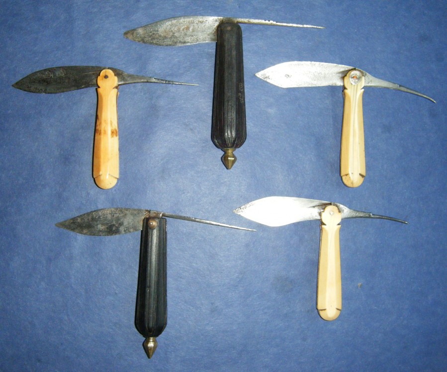

Attached a pic of my ones.
BTW, the one in question is the nicest one I've seen so far!

Posts: 6,441
Question
I have a question about the examples you showed, Detlef. The two knives with wood handles have finials at their ends; what would be their use be?
Old 19th January 2025, 09:43 AM   #9
Hello Rick,
Sorry, I don't have a clue! And I don't have them by hand, I've stored them somewhere.
